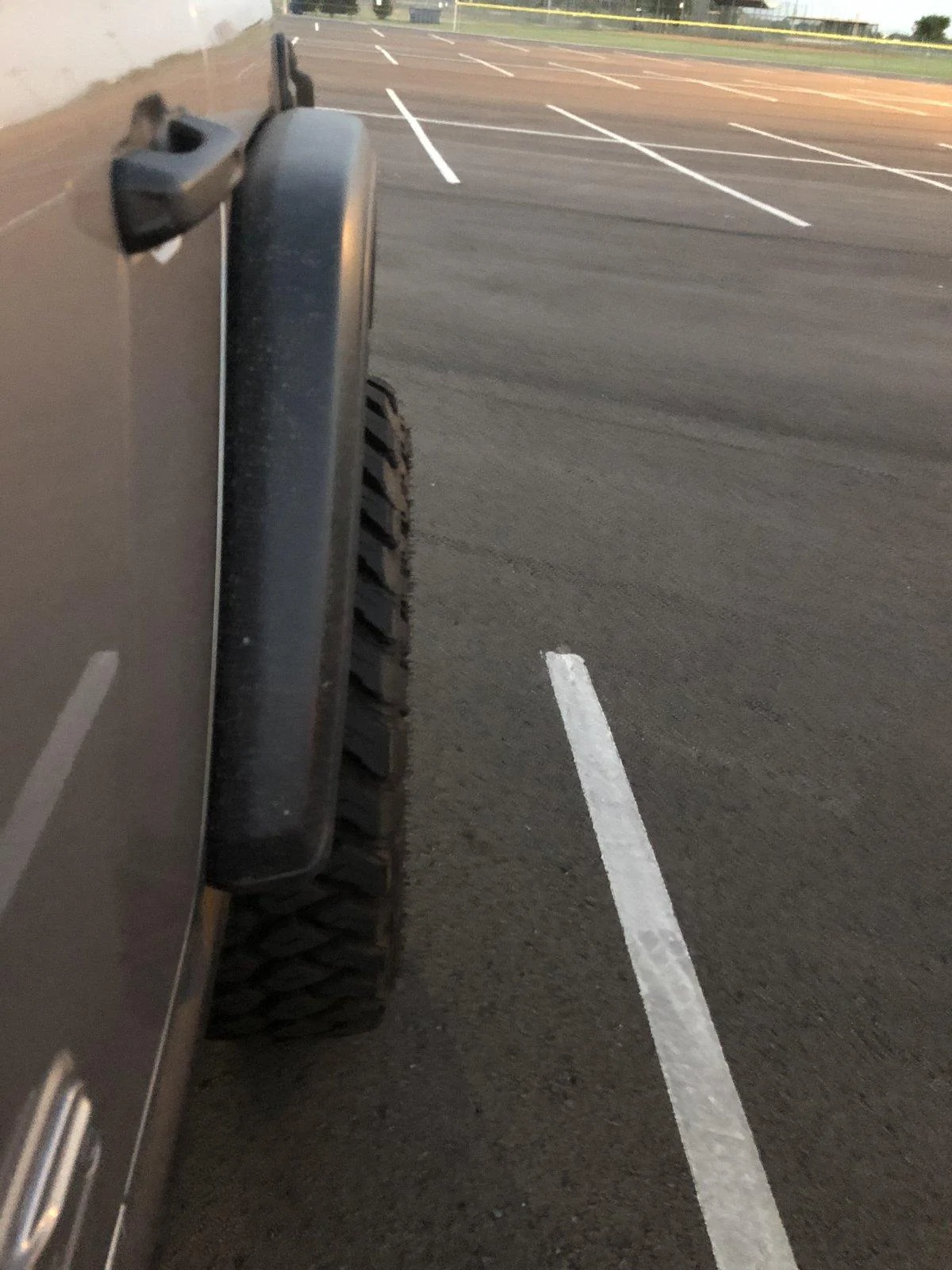

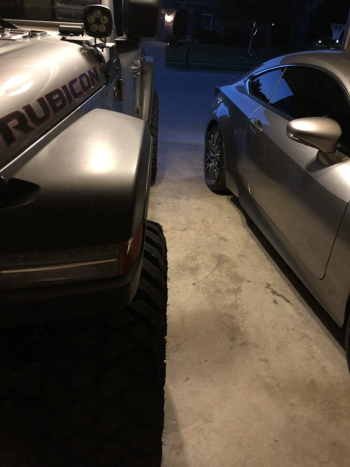

Sorry just noticed this. Here is a side view to kinda show how much they stick out. I didn’t measure but I’m guessing an inch to 1.5 max. There is also no rubbing full turn and through full articulation in the front and a small piece of plastic rubs in the back. Easily fixed though.

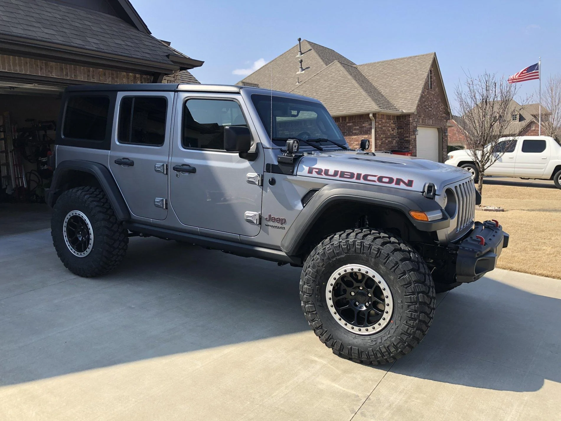

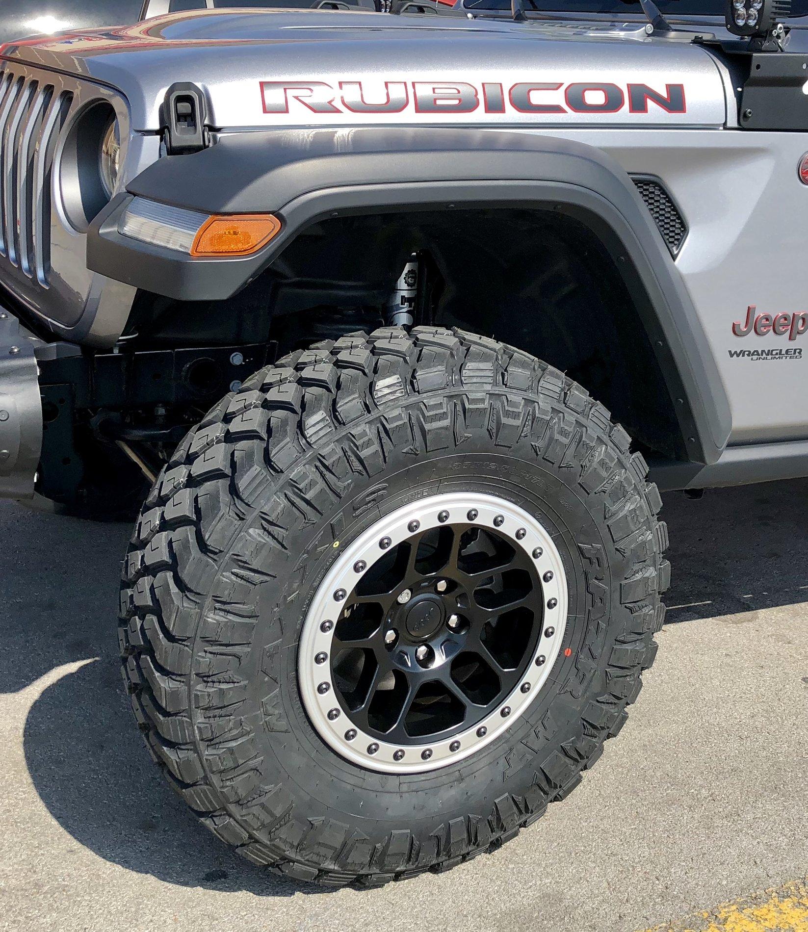

Yes and yes. With the silver trim ring it is a simulated beadlock. Mounts just like any other tire and then you bolt down the trim ring. The red ring is the true beadlock and the tire mounts on the outside of the bead and is secured with the bolts. If someone powder coats the rings, the easiest way to identify would be Allen headed bolts for trim, hex head for beadlock. I brought my jeep home on stock suspension, mopar beadlocks and 37/12.5 without any issues. Granted I trailed it Home but drove it about 150 miles like that. It will rub if you flex it out I would imagine

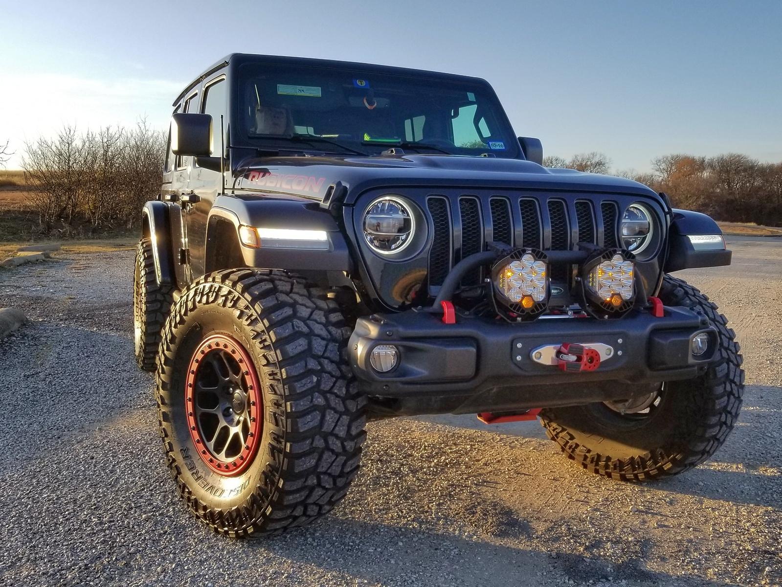

i run 37x13.5x17's on mine with no issues...

With what lift?

Just the Mopar 2" lift. I added some RockKrawler parts but I netted 3.5" from the Mopar 2" lift.

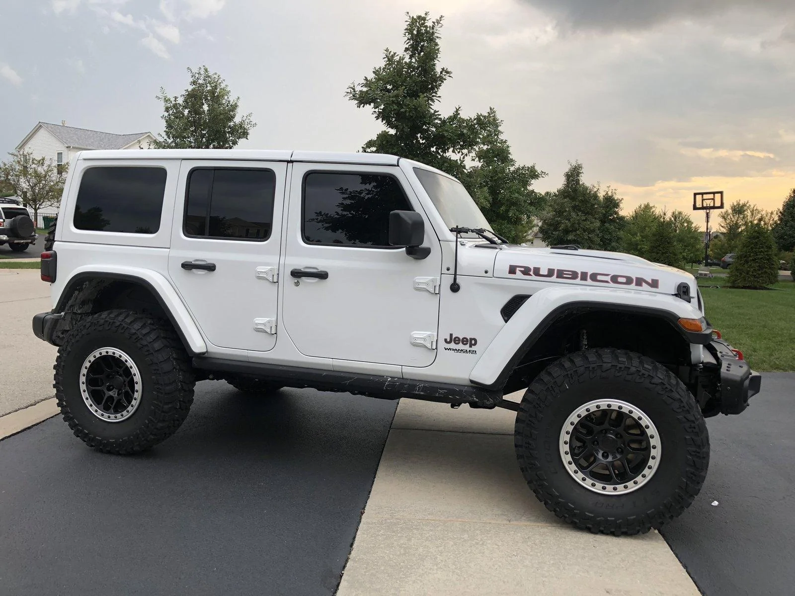

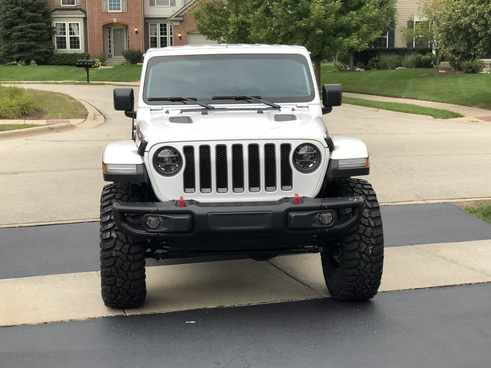

Here is the mopar Beadlock’s with a 37X12.50R17LT mounted in the DOT side of the Beadlock at 8” rim width (8.5 in Beadlock side). No rubbing anywhere with the mopar 2” lift on JLUR.
The bead of the tire is on the beadlock part of the wheel?
hello, what tires are these and what size?

What size lift are you running? and do you have any rubbing?
I'm running the Mopar 2" lift with some modifications to it. I got about 3.5" of lift aut of it,probably settled to about 3".
If I'm really twisted up offroad I'll get a little rubbing on the right rear fender liner (where it bulges in). It's loud but isn't making much contact as it's never left a mark on it after like 20 wheeling trips.
