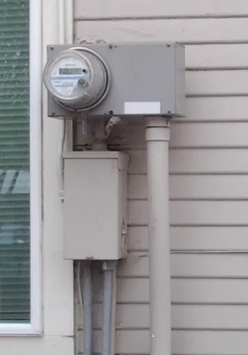

Underground conversions aren't that uncommon with old houses in city environments, but again everything varies by region. If I remember correctly, I've seen this mostly in Southern California (LADWP & SCE)
The top box is a retrofit that plugs into the meter socket, specifically for feeding underground. This house was likely overhead when built.
