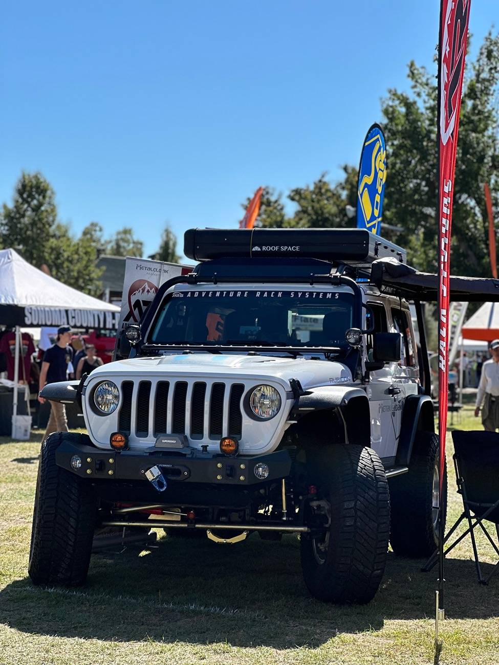

I Love my 3.5! I run the overland setup (beefier rear spring) for extra payload capacity. Running 38’s and the Rocksport Black shocks.
Drives like a dream.

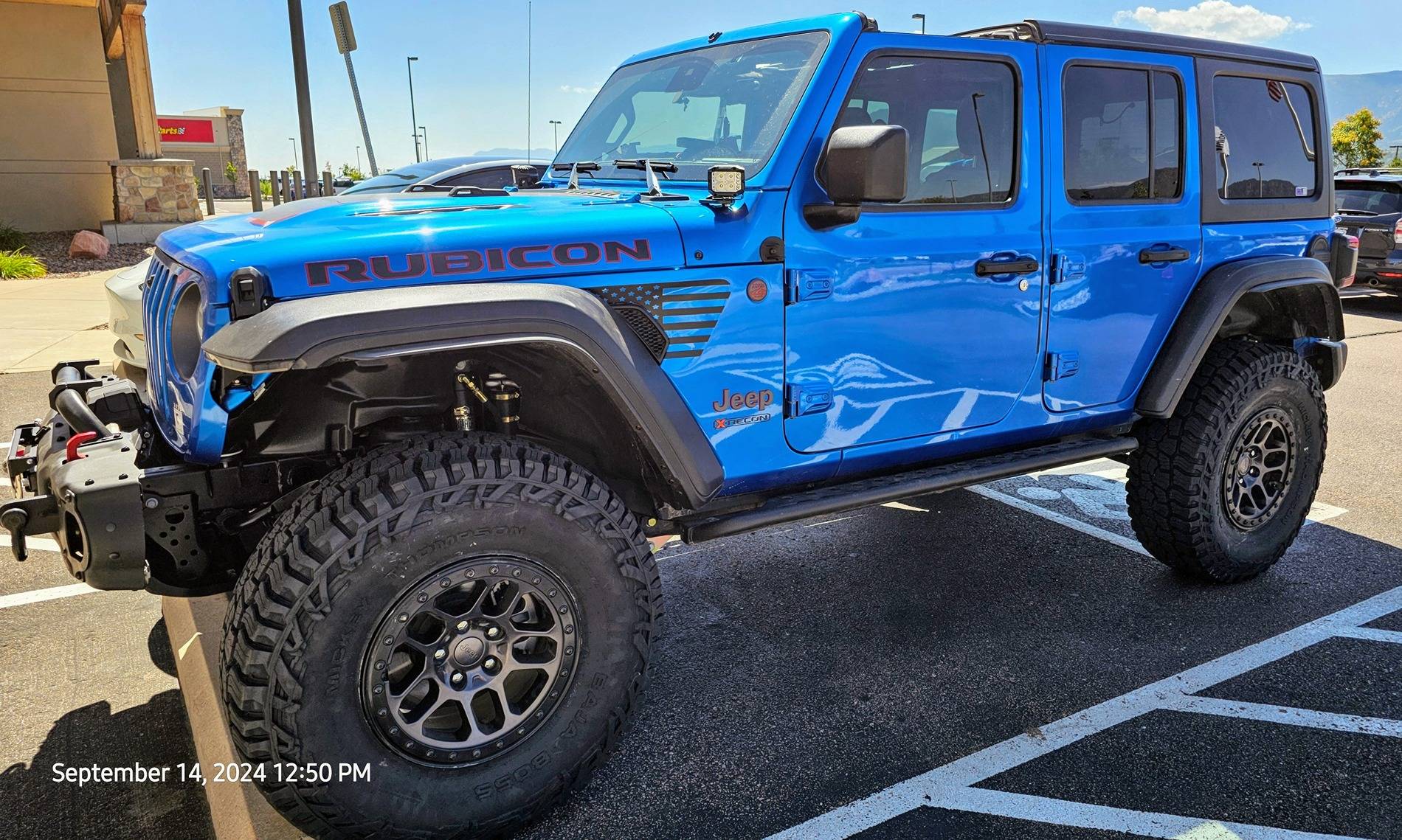

I did the 2.5" Gamechanger with overland rear springs, Front control arm drop brackets, Metalcloak front driveshaft and Rocksport black shocks. A bit pricey, but as WestyMike says above, it drives absolutely wonderful. Exceeded my expectations. 👍
