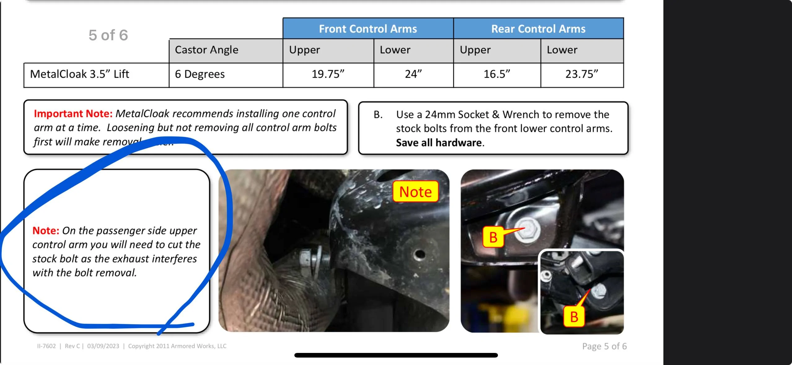

I don't remember doing it, may be powertrain dependent?
I believe c clip is set looks identical to the other uca and I thought the same thing about different powertrains but it doesn’t mention anything about that so figured I’d find out when I get to doing it. They even provided a replacement bolt which is why I pulled up the directions to begin with I was confused why I only got one bolt and what’s it for

No just front uppers and fad skid this weekend, I already have their 2.5 lift and front lowers appreciate it though. The bolt in question says it’s for the passenger frame side and it interferes with the exhaust but based off the picture of theirs it seems it can be wiggled out without cutting it

I haven’t heard of this does everyone run into this problem?
Yeah, That is going to be in the diesel because getting that bolt past the downpipe is rough and easier to just replace the bolt.

I saw the same instructions for diesels. On mine I was able to remove the passenger side UCA bolt from the axle and twist the UCA enough to remove the bolt from the other end without cutting. If you're taking the UCA out anyway, you might as well give this a shot.
