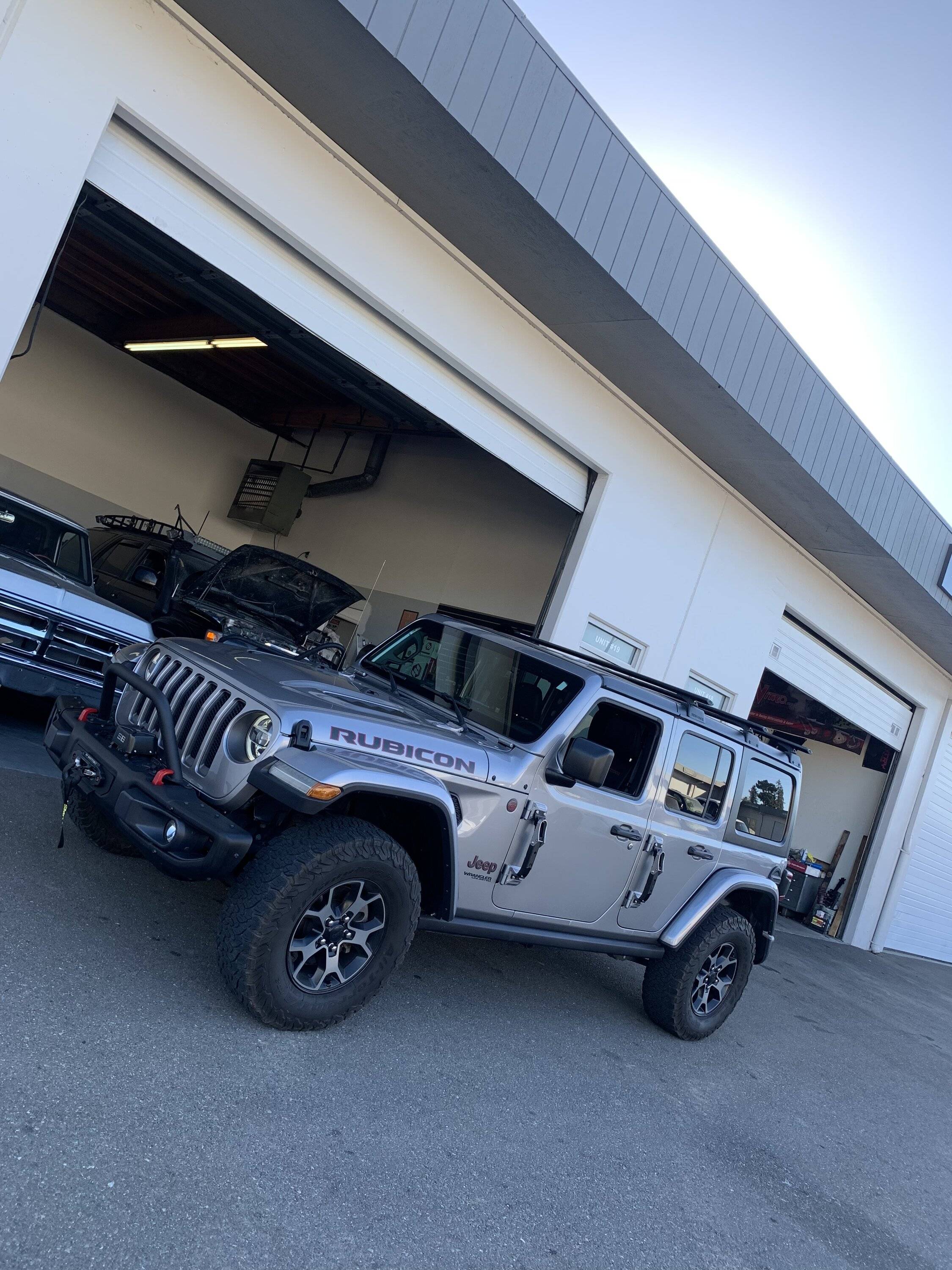

Thanks all for your suggestions. Here are my before and after pics from the MC 2.5” GC lift kit with the Method 312s and Falken Wildpeak AT3W 37s
I’m really happy with how it turned out. It rides really nice with less roll over during turns. The stock 4.10 gearing seems to be just fine overall though I do observe slightly less torque on the 1st gear and on the 5th/6th gear, but hasn’t bothered me much, albeit it’s only been a few miles so far. I definitely feel the stopping power of the brakes has been reduced due to the 37s.
How are you liking it a few years and miles later?

@JLUR Farout i have updated it quite a bit since then. Check my sig for details - I now have 4.5” springs with chromoly axle shafts and HD ball joints and re-geared to 5.13. Also, I now run Nitto grapplers 37” on a KMC beadlocks. Overall, I would say that the heavy Nittos MTs and the th higher rate 4.5” springs has made the ride more stiffer overall
