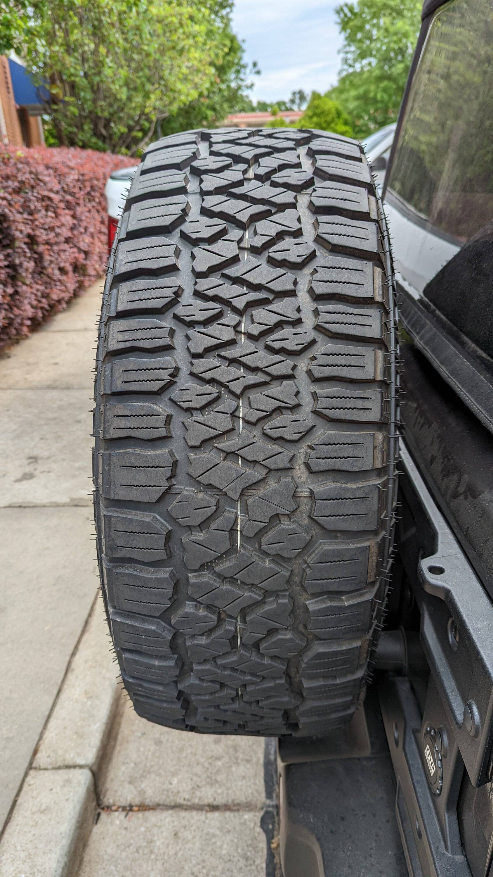

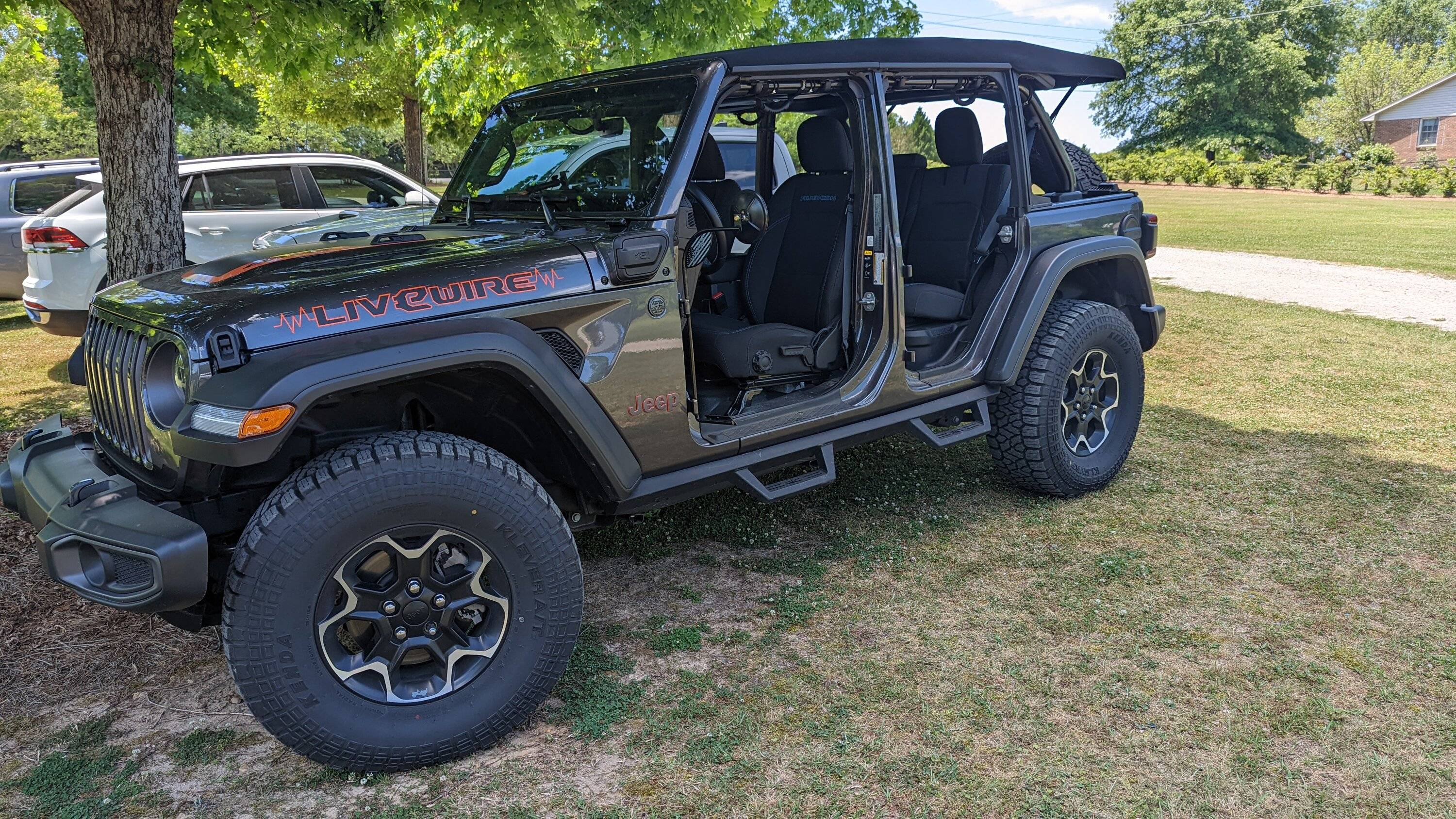

To chime in on tires, you may want to look at the Kenda Kelver RT's. Those tires are a rough terrain (RT) tire which is supposed to be a hybrid of A/T and M/T. They won the Pro 2 Off-Road Championship in Oct. 2020. I'm running the Klever AT2's and they're fantastic. They're also cheaper than BFG, Toyo, Nitto, or Falken's. They have them in 35x10.5, 35x12.5, and 37x12.5.
5 @ 35x12.5R17 go for $1,730 + install.
5 @ 35x10.5R17 are $1,488 + install.
5 @ 37x12.5R17 are $2,008 + install.
Let us know what you finally decide lift-wise.

Can you show a picture of them on your Jeep?

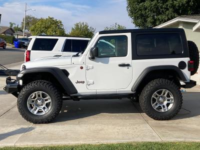

Im very happy with my 2.5 GC
Looks good. I’ve been thinking about the same lift. How much of a lift did you get from it. I hear people saying 2 dr will get 3-4”. I think it looks just right, esp. with the size tires.
This is a Rubicon. I got 3” in rear and 2.5” in front.
