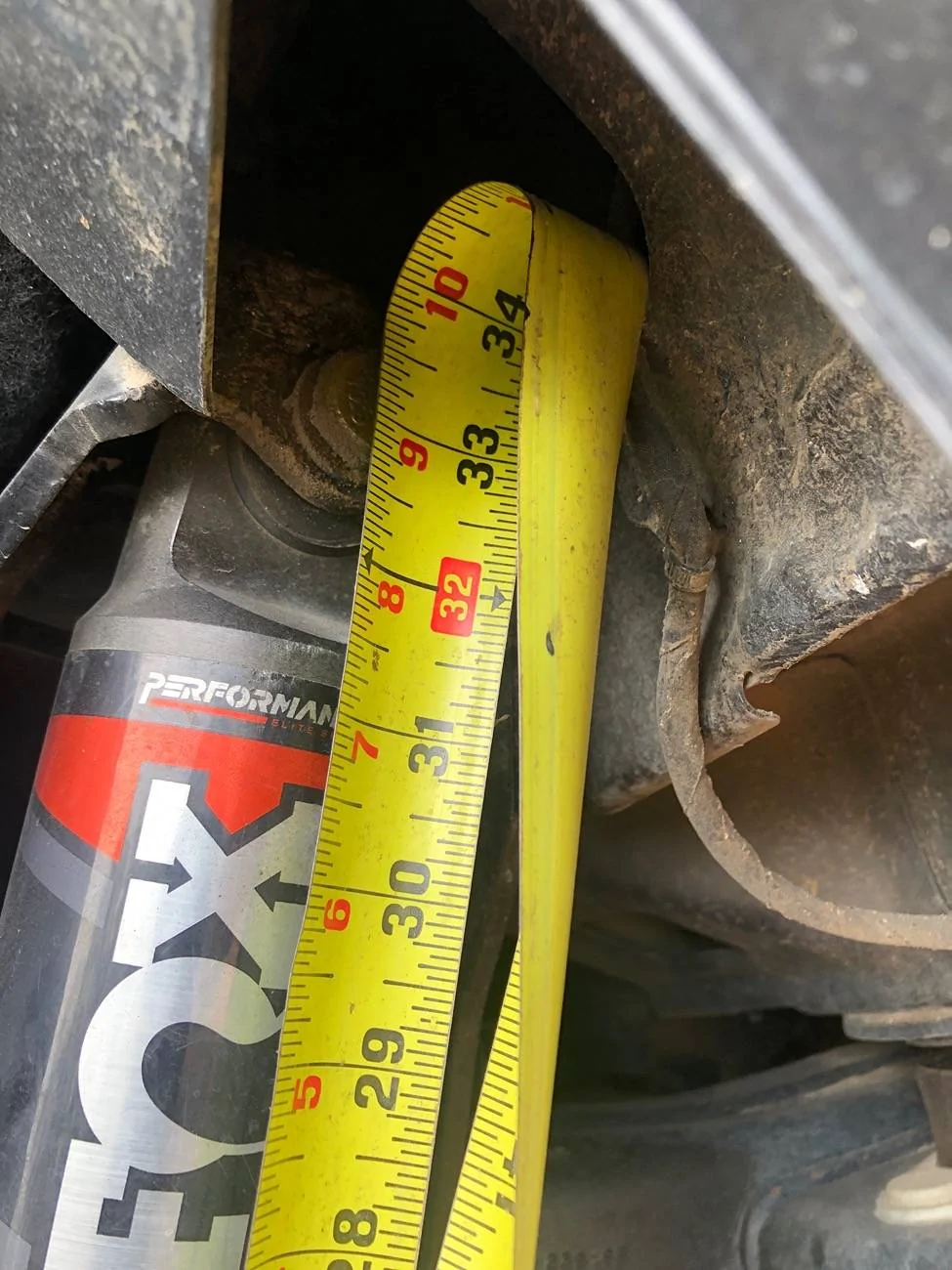

Thinking about it, if you didn't change the rear shocks to a longer full extension, the rear driveshaft shouldn't need to be longer. I'm thinking of getting some more flex by adding the new 32" (red) Rocksports. So, that change might necessitate the driveshaft change. I'll call MC today.
I’m 33.25 extended in rear, no issues with factory shaft…..
I'm gonna start calling you "Flexman".

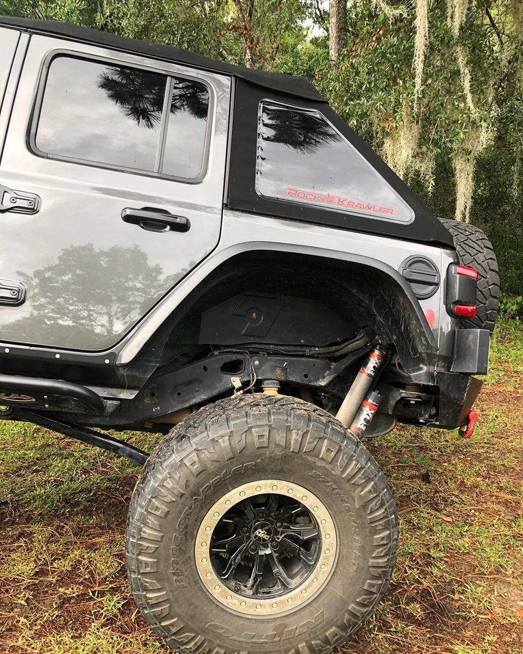

Roky Flexman, what longarm setup is that? Basically, can you describe your entire rear suspension? I like that the arm pivot is tucked... a lot.
Roky
Roky
Oct 4, 2018
10,715
29,489
It’s the Rock Krawler Adventure X with 3 link rear…..i had to shoot from the hip on a couple tings like having to weld on my sliders, and a couple other things but way worth it…. I documented it in my build thread, start reading here……

Did that require you to upgrade your rear drive shaft as well?
No, I put 50,000 miles on it, no issue, front rep seal did crack, they covered under warranty
