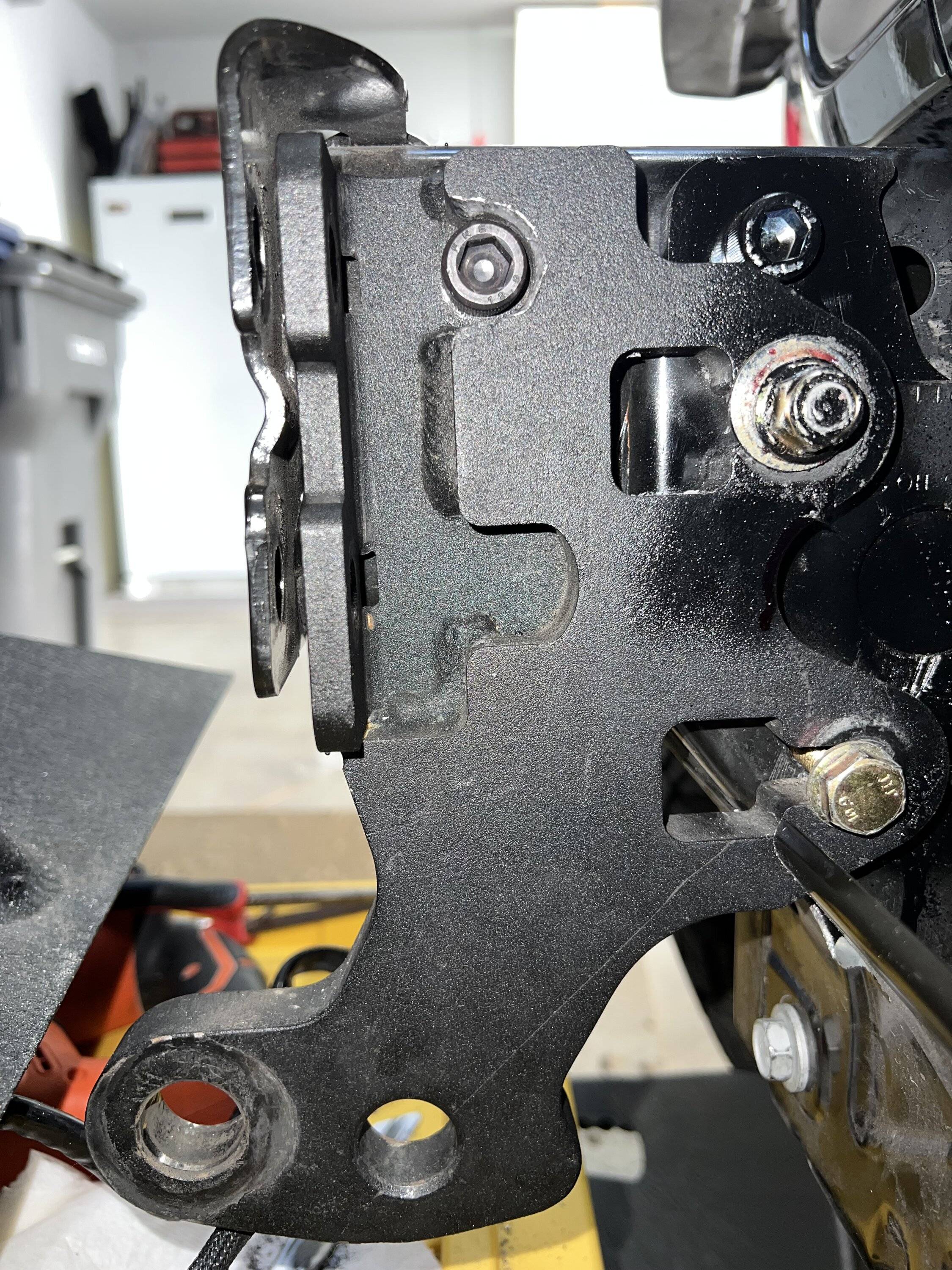

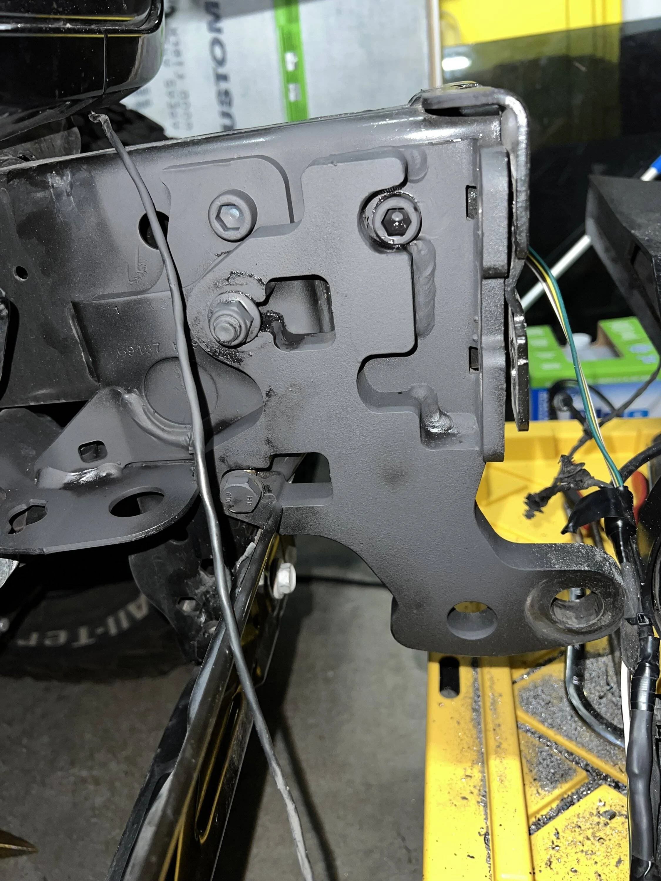

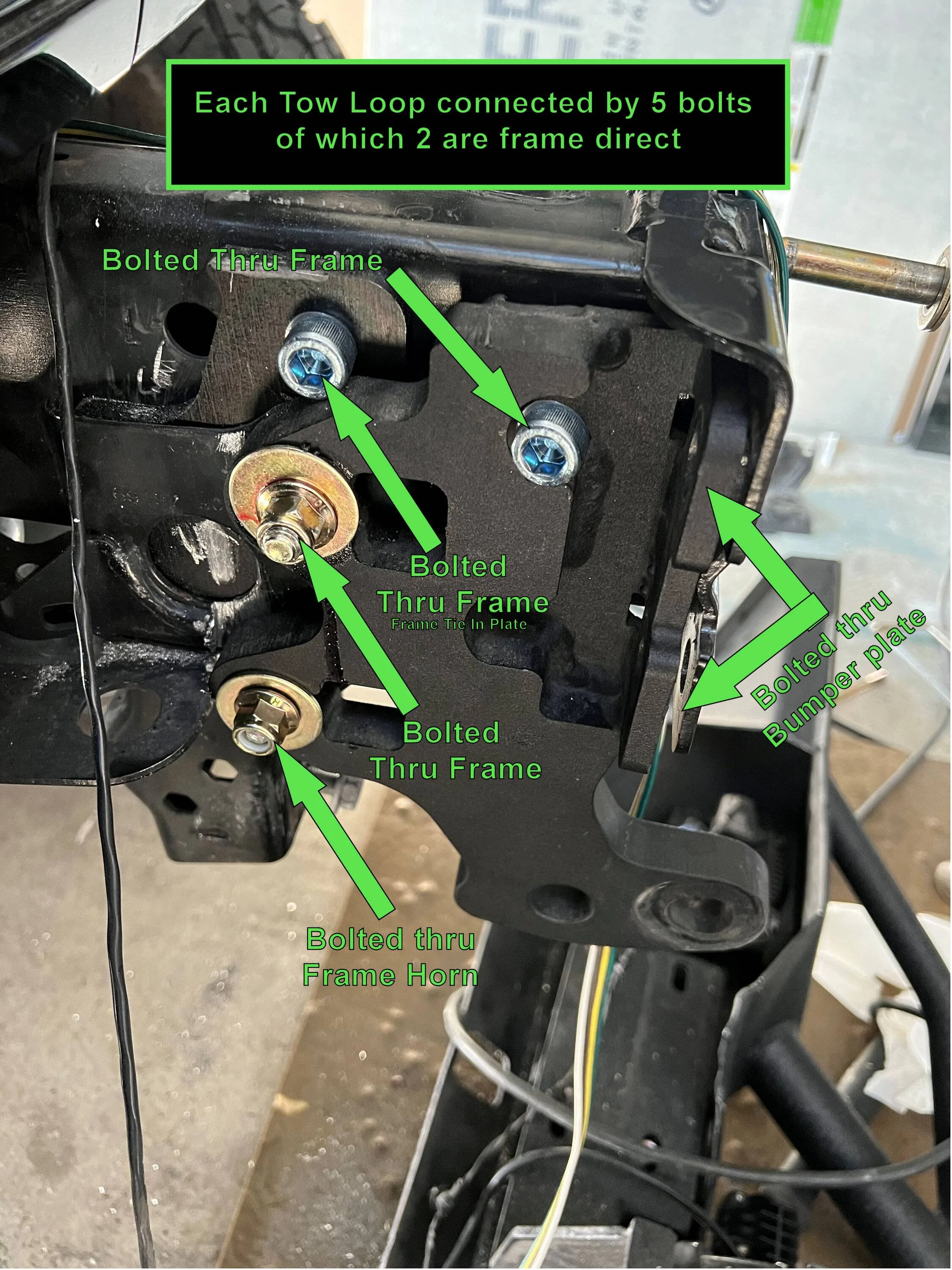

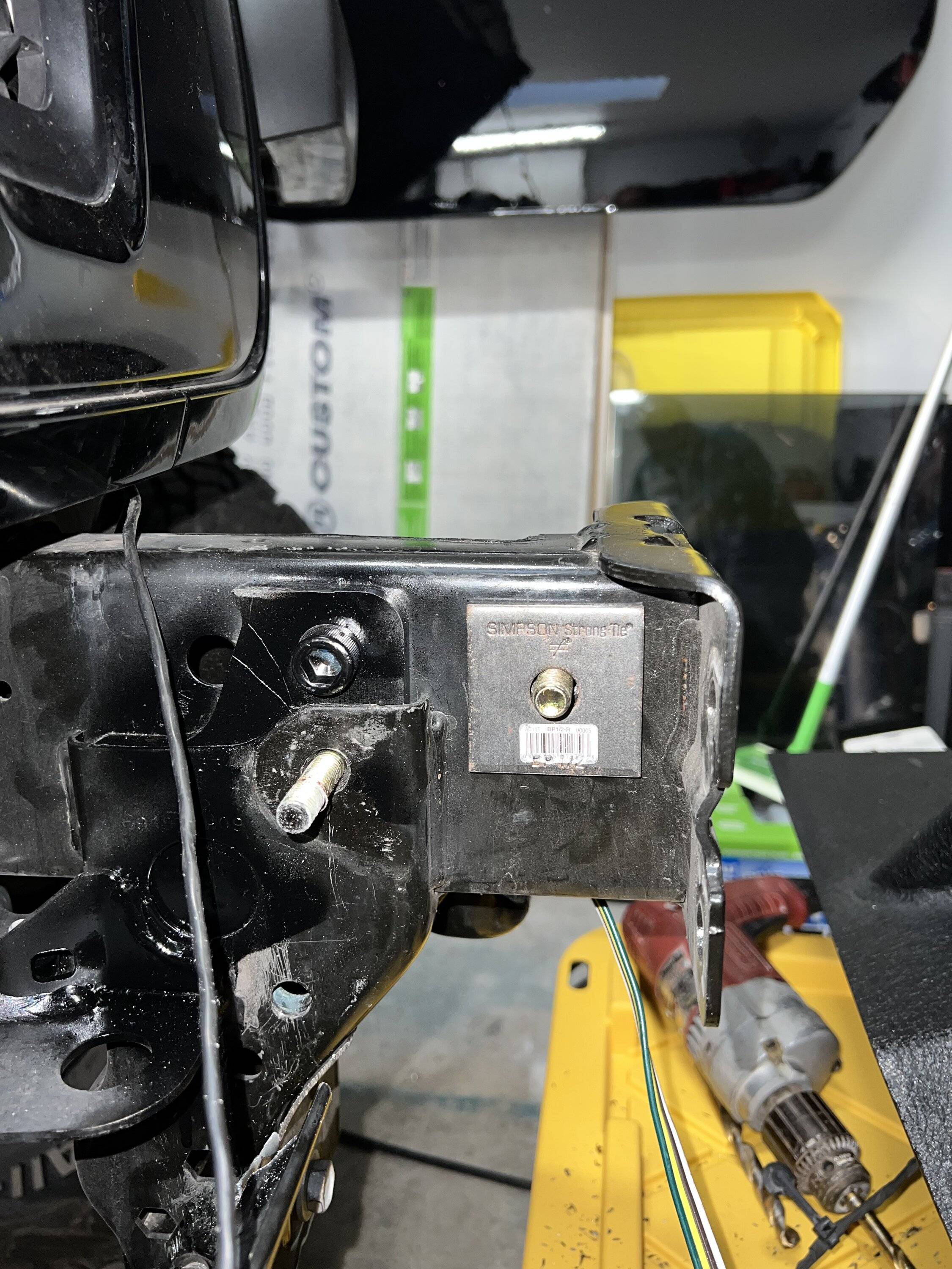

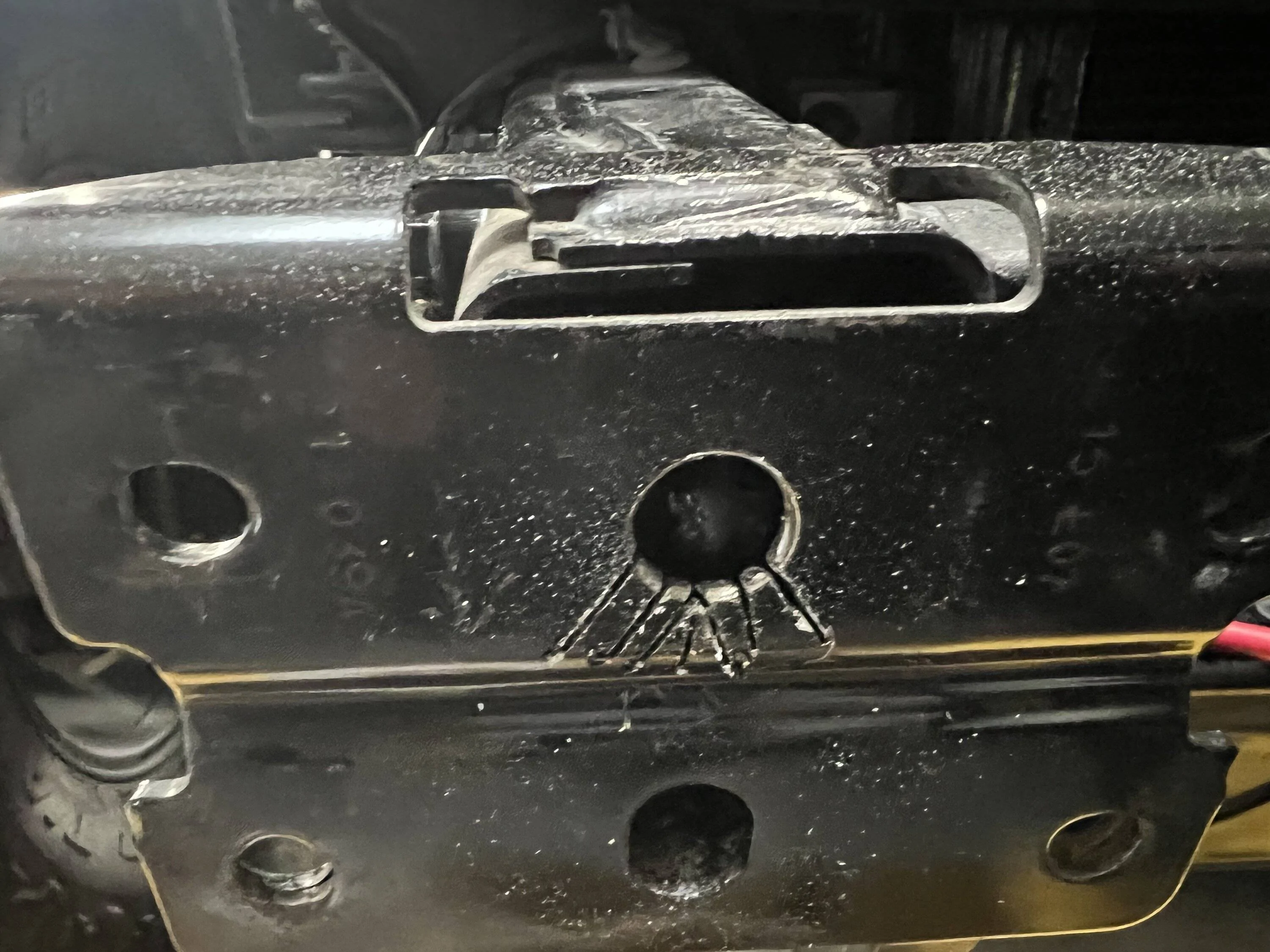

Is this a Maximus recommendation?I too had to grind out that horizontal bracket and weld on both sides about 3/16" not a big deal though. I am also going to drill my loop out as pictured and add another frame bolt as pictured here![]()
