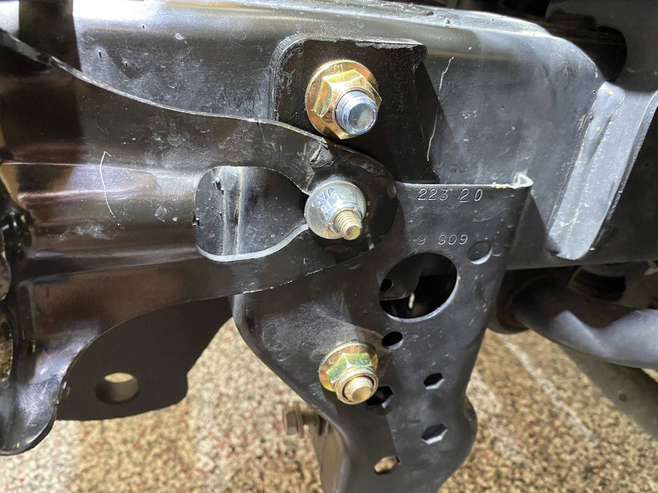

I talked to Josepph yesterday about my install ( I completed last night) that middle bolt he said was critical to be 10mm or better. I two started to dril lit out and got nowhere fast. Then I decided to step drill it starting with a 3/8" bit and rotating and wobbling it, then moved to a 7/16th bit doing the same, it took all of 3-4 minutes to drill eacj of them.

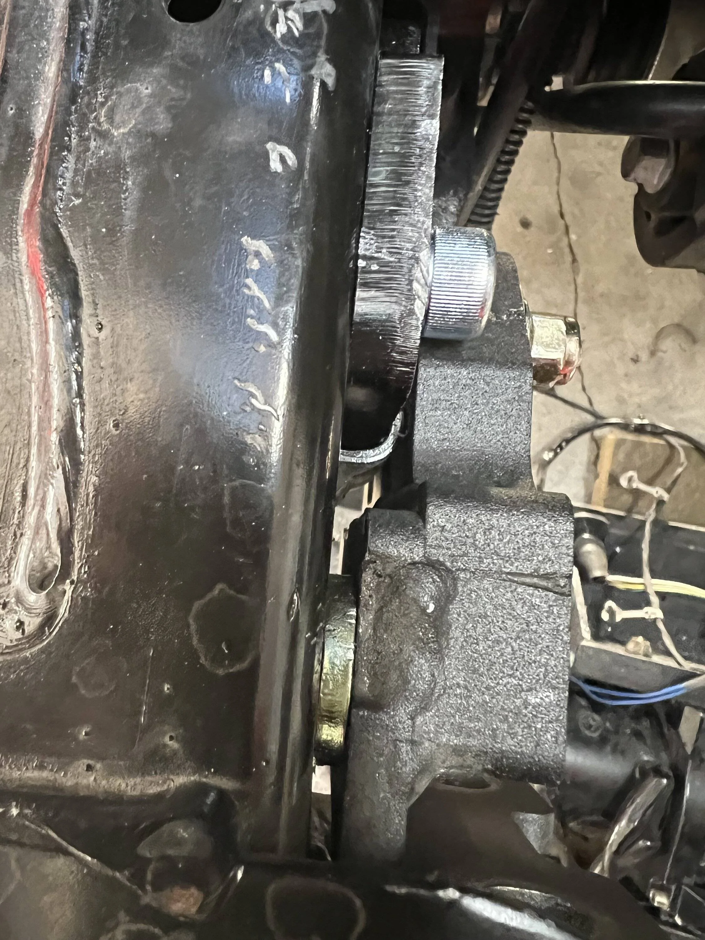

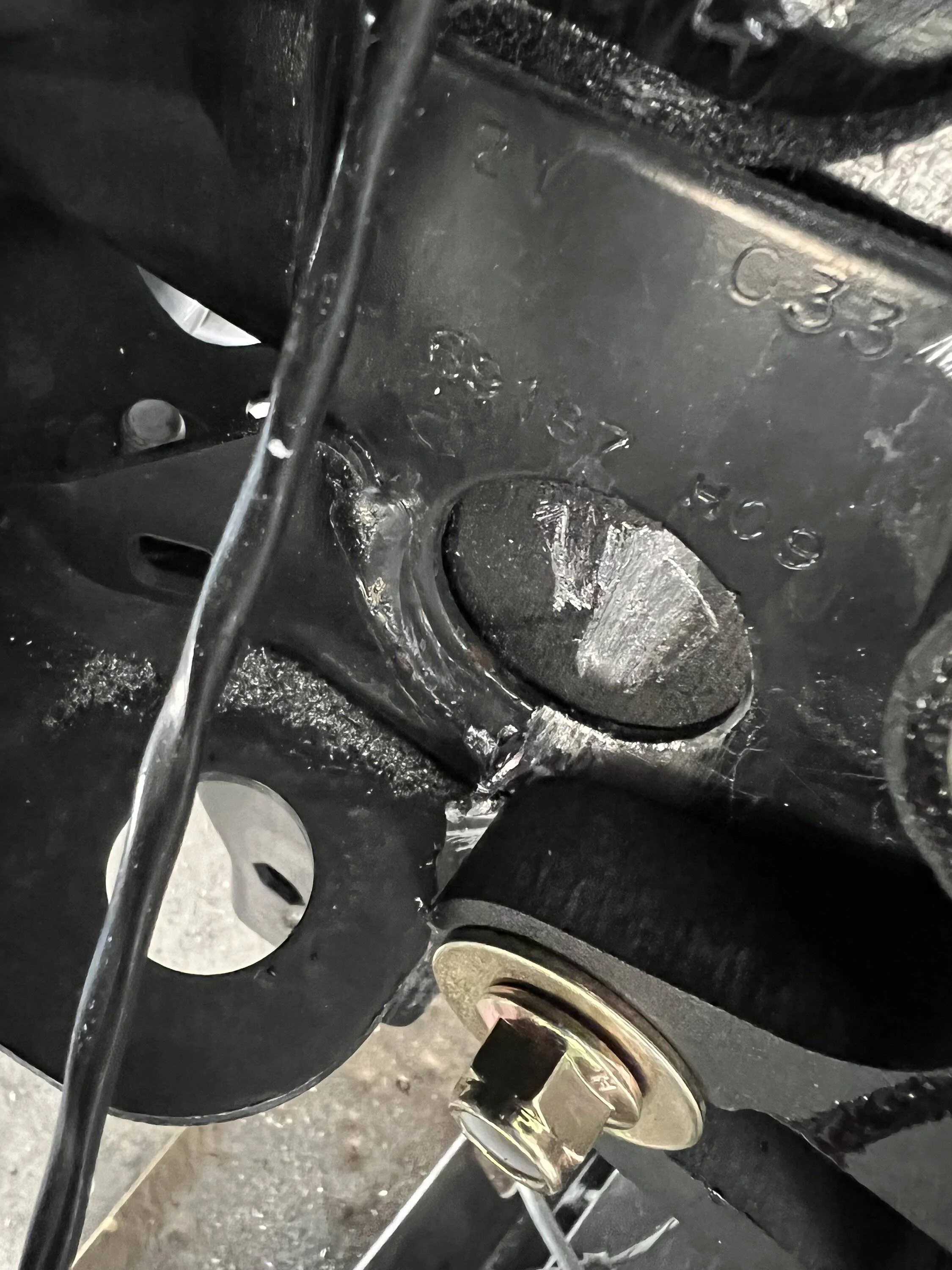

I also moved min inside the frame however that horizontal bracket on the outside of the fame horn preventted the tow loop to sit flush against the horn and tie in bracket. So I ended up grinding/Hacking it down a bit for that perfect fit. Kind of hard to see here. I then had to prime and paint that area.

I had another issue as there is a gap in front of the frame horn where the tow look does not sit flush against the frame, that gap is about the size of a thich washer. That may be a issue and in part what cracked my frame horn in the first place. so I wedged in a thich washer to there was no potential for that unsuported gap to potentially break the frame horn.

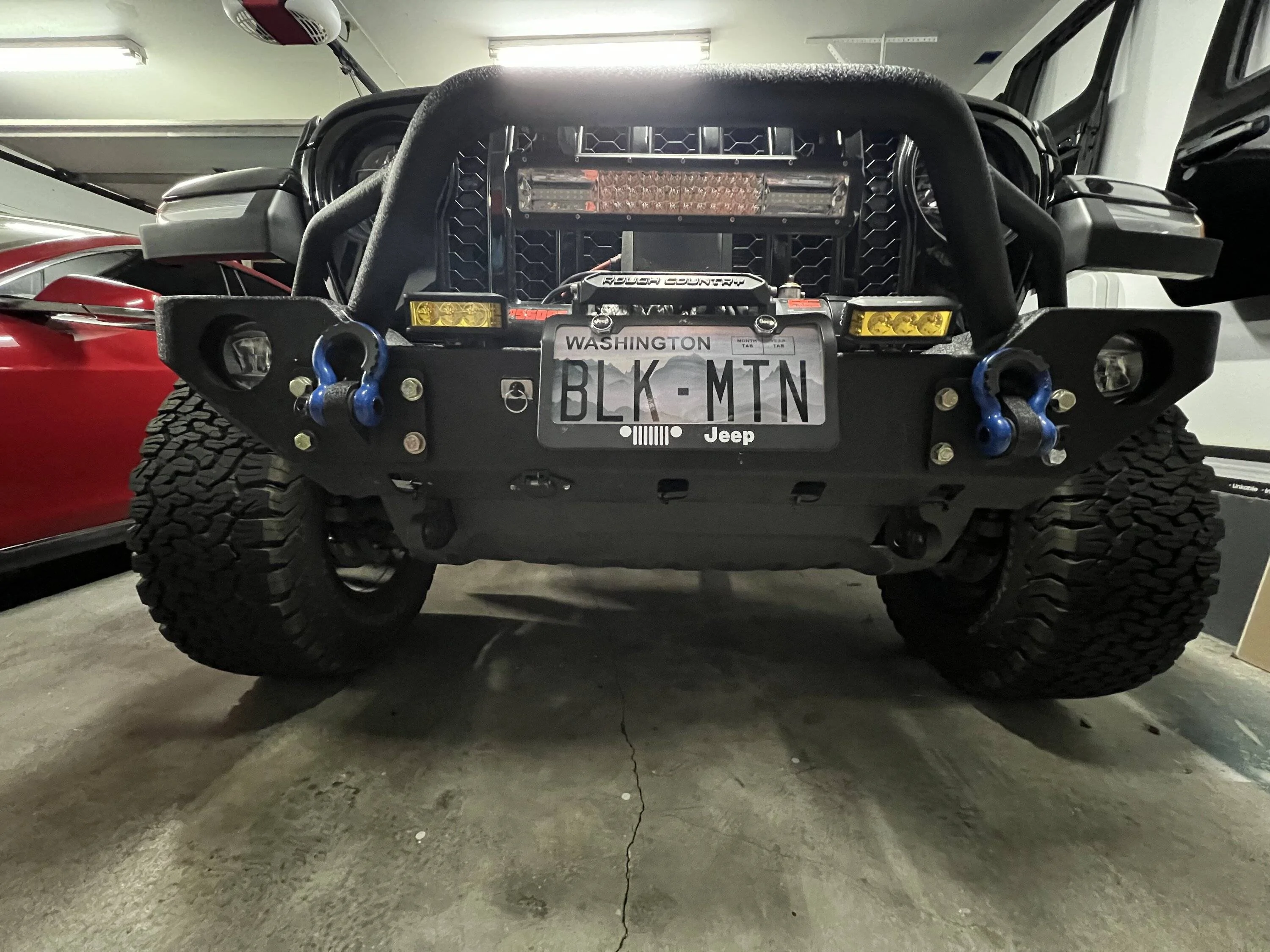

I have a winch with my Barricade Allow series 3/4 bumper there was NO interferance and I also mounted mine insuide the frame this time.

Sweet. Your tow light connector goes through an existing slot in the dam? Dam come with the bumper?
Edit. I see now that the slots are part of the bumper. What about the dam OEM or aftermarket?

That air dam worked out perfectly. This has been a great bumper, it is also all Aluminum which helps reduce the front end weight. I likes the bumper so much that I had it on my 2018 JL and swapped it to my 4xe. The best part was I was able to keep and use the plastic splash guard below the bumper.

No use a 3/8 bit to start then wobble it to reem the hole till a 7/16 will just fit then do the same with it till you get the whole the size of the bolt. You cannot drill it straight on the tip of the bits do not have the cutting power. It was easy took maybe 2-3 minutes each. Note: those nuts you are drilling out behind the horn they are only pressed on too much drilling pressure they will pop out which if that happens it is not an issue just hold it in place till when you bolt everything on.

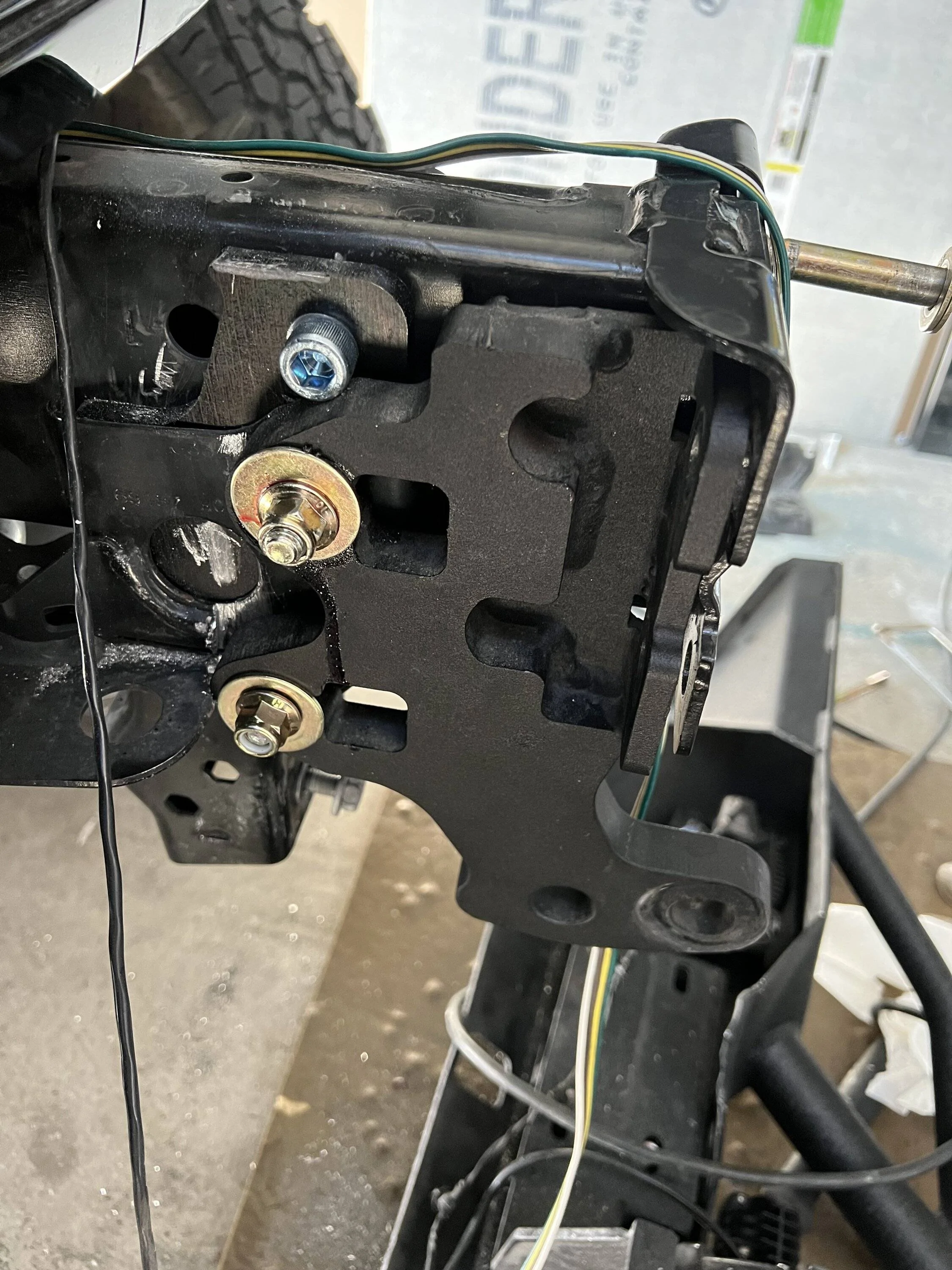

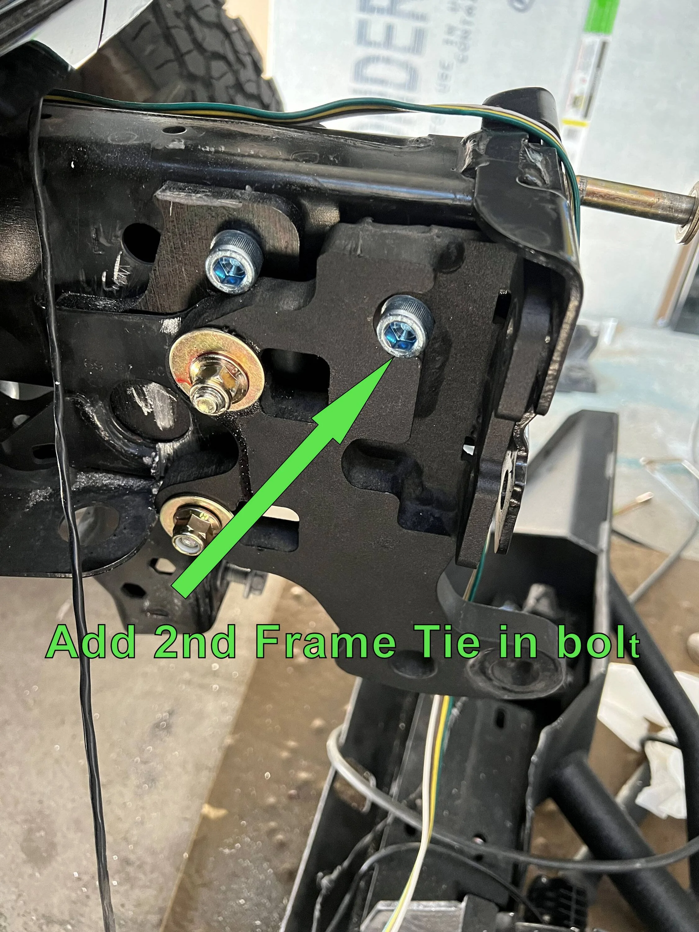

I too had to grind out that horizontal bracket and weld on both sides about 3/16" not a big deal though. I am also going to drill my loop out as pictured and add another frame bolt as pictured here
Jeep Wrangler JL Maximus 3 Tow Loops 2nd frame bolt
