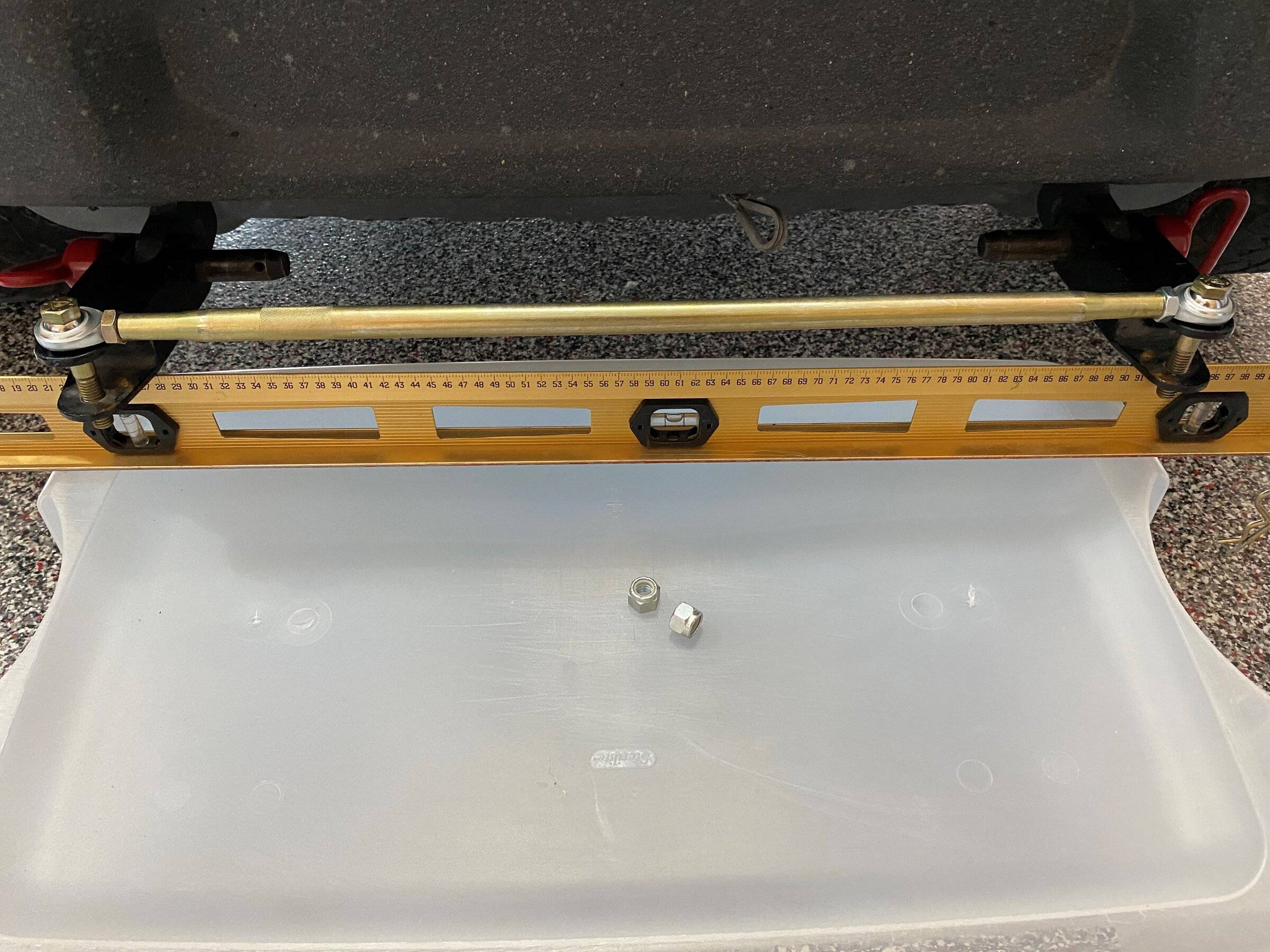

I'm on my 4th toad & towed every one of them for 6 years+. Used Demco & BO base plates. Last toad was a 2014 Edge with a BO base & tabs were 26" & that was wider than some (most). The new Maximus loops on the inside are STILL wider than most base plate tabs at about 25'. Don't fret the width. I measured my clevis holes to be about 26.25". However with adding the heim & lock nut thickness I came up with a tube length of 24". Wanting to use almost all the thread of the heim I wasn't sure if 23.5" was best or 24" so I ordered both. My stuff lands Wed & I'll sure share my results. The pic makes the clevis's look like they are pointing outward but it's just the pic. They are perfectly straight forward.

Follow up on tie rod to accommodate INSIDE the frame horns mounting. With my equipment (Ready Brute Elite II and NSA straight clevis's) a 24" tube is perfect. A shorter tube could be used and the distance would just be made up unscrewing the heim's. In this case the 24" (steel) tube keeps everything perfectly straight ahead with the heim's screwed in completely. I'll try to get out & tow as soon as I get a chance but in may have to be the fourth of July weekend.
Jeep Wrangler JL Maximus 3 Tow Loops tube 1
Jeep Wrangler JL Maximus 3 Tow Loops tube 2
Looks good.
