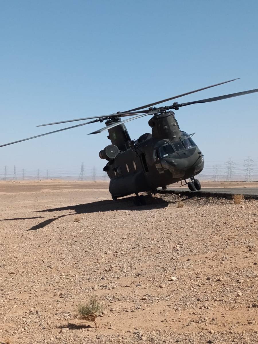

Roll angle? An ol' Army flying buddy sent this the other day. 18 degrees. That left front inboard tire is paying the price.
The 15 degree limit just feels like a roll-over about to happen.
