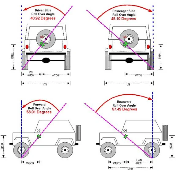

If there was a roll over angle index for a base unloaded jeep its not too difficult to calculate new roll over angles if you calculate new moments for the jeep.
Similar to how aircraft CG's are calculated to make sure they are within their limits prior to take off:
https://en.wikipedia.org/wiki/Center_of_gravity_of_an_aircraft

I would love to calculate mine with the full underbelly skid system, LCA skids, diff skids, sliders, winch etc. all that extra weight below the normal cog should help increase the numbers By moving the effective cog a good amount.

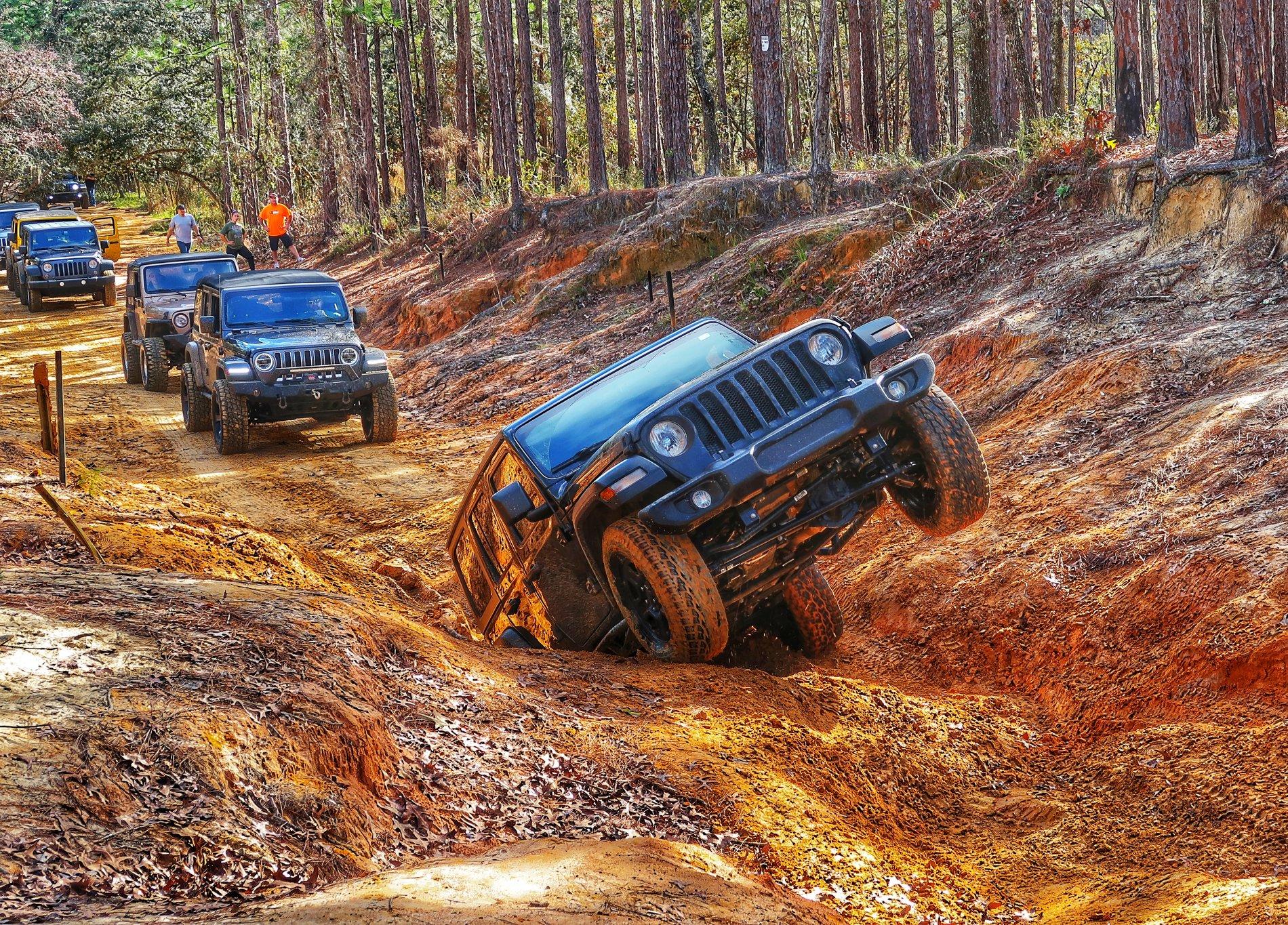

I briefly got a pretty good pitch and roll coming up out of this obstacle a few weeks ago. No idea what the degree readings were, but it felt extreme and looks extreme in this photo. Thankfully it was only a few seconds. I cannot imagine sustaining either for any length of time, like y’all have!

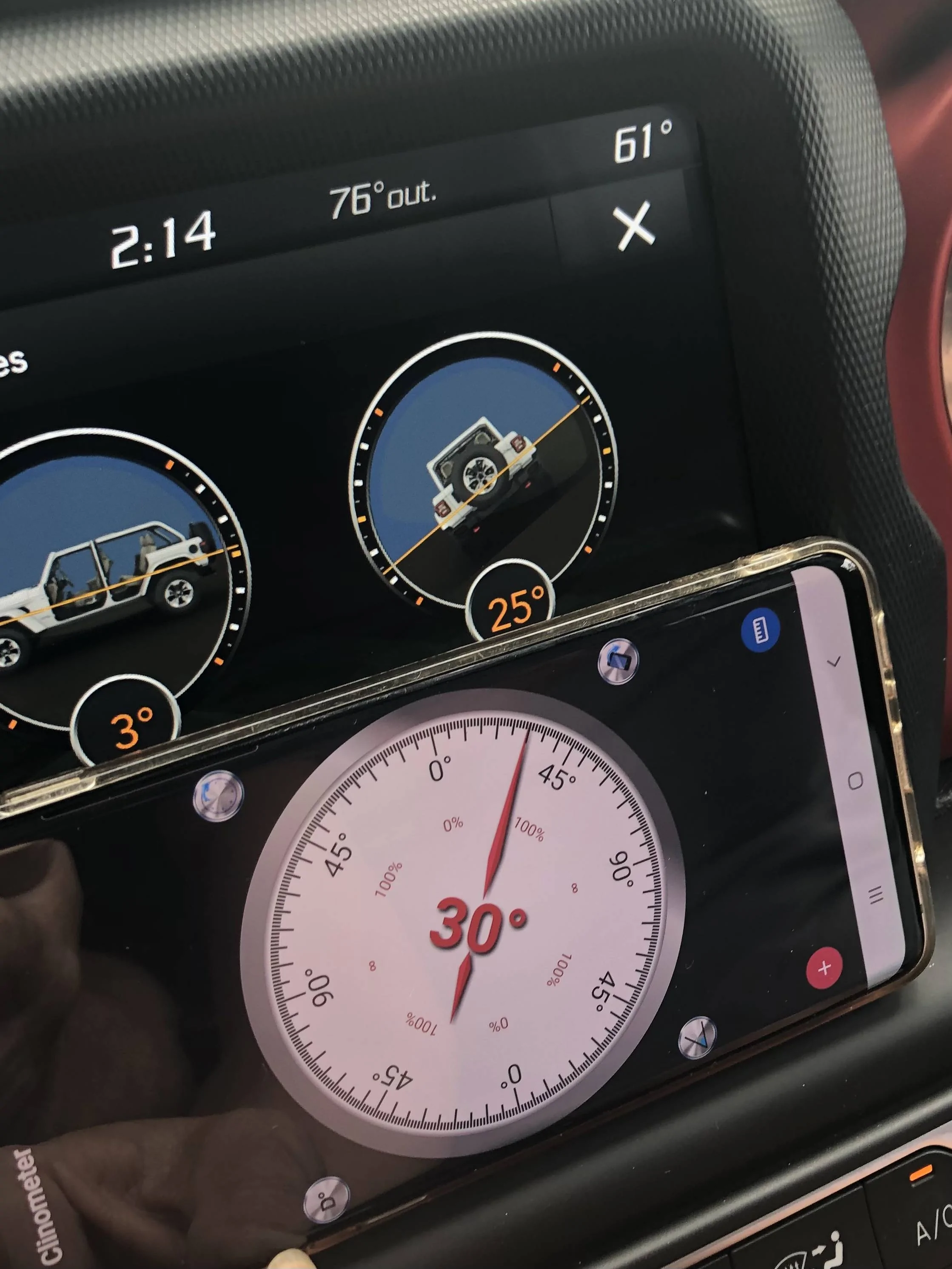

I’ve been this straight up and down..,..
and this sideways.....
Both felt like I was on my bumper and on my side from the drivers seat......:facepalm:

Theoretically, 30° side hill is about the tip over point, and 45° is about max possible (I believe the 47° claim). At about 45° traction evaporates, and if you do find some traction, any vehicle will want to do a backwards somersault
I've seen 25° to the side and 34° up which definitely feels like 90°. I may have exceeded that in a couple spots but my dash is so glitchy that half the time my roll and pitch gauges don't work :mad:
