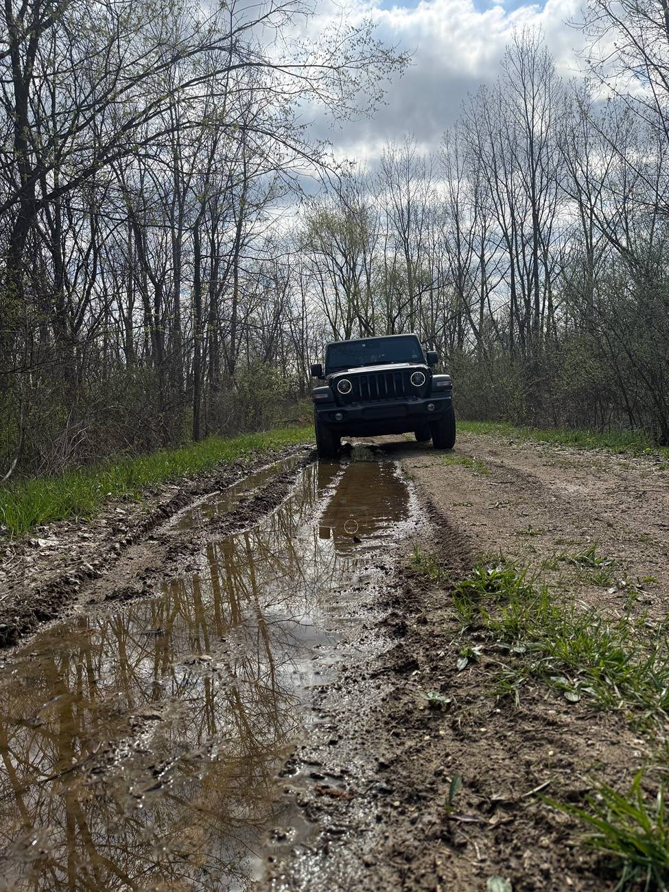

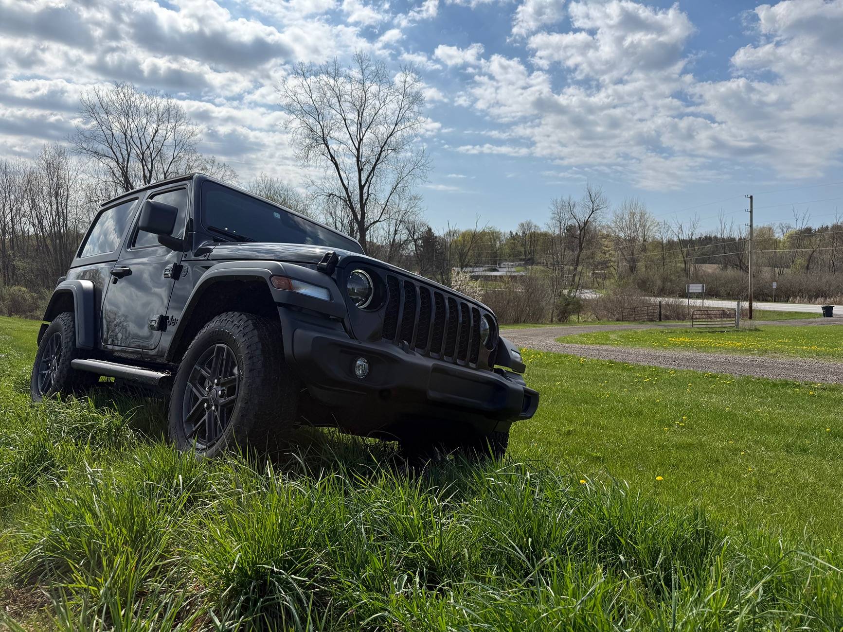

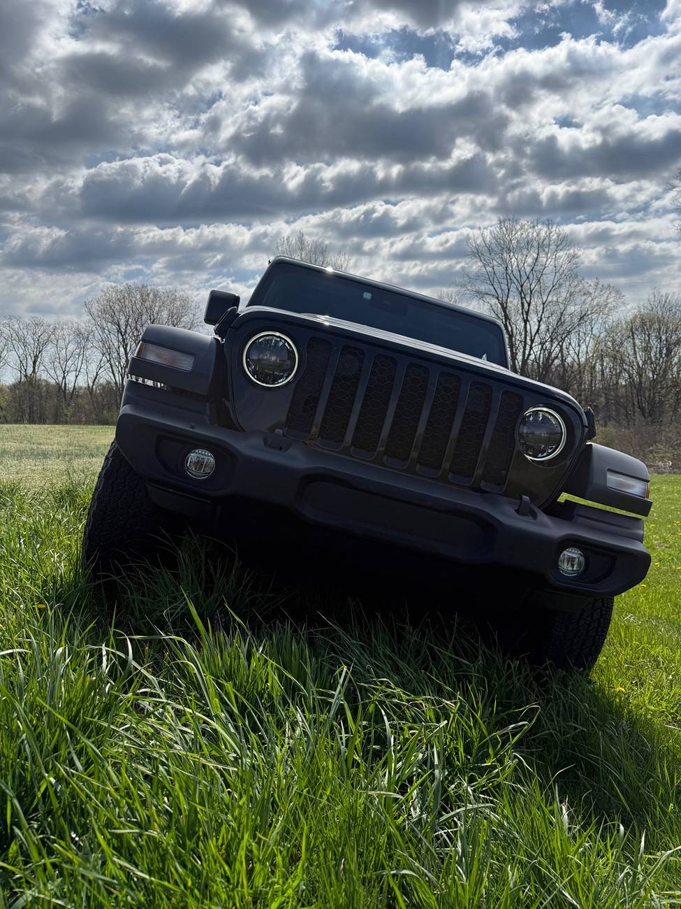

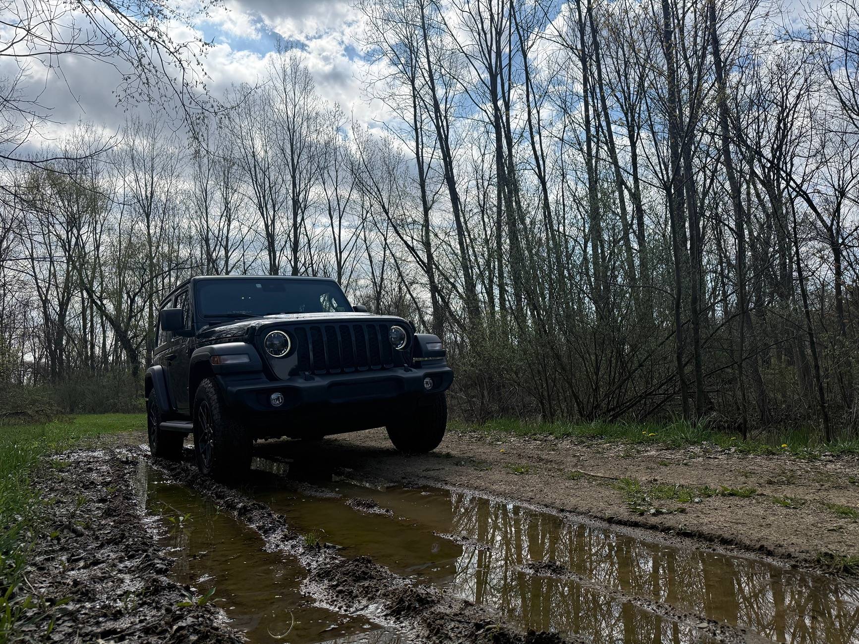

Hit some trails for the first time in my JL Sport 2 Door. So much fun. I had it up to a 20-23 degree roll. Curious how much further I can go before it becomes unsafe/risk of tipping over I’m on stock suspension and all terrains.
