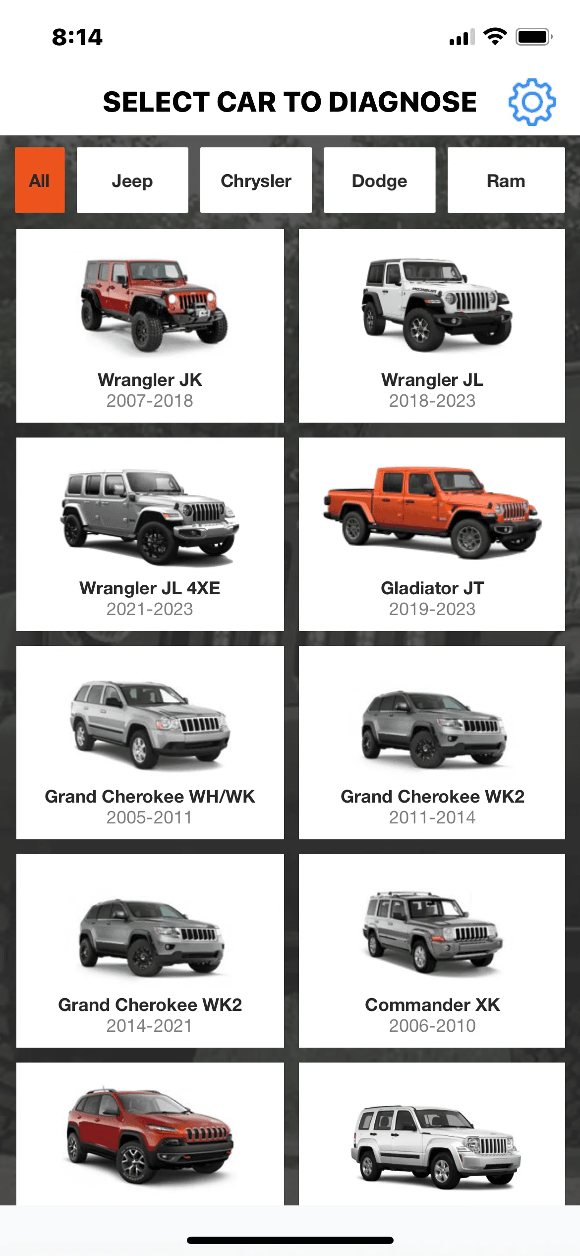

I have the AEV procal from when I did my lift. Honestly JScan is way easier to use and if your not using taser that is what everyone else uses. All in for under $75 for what you need. Download the app and it has a demo mode that you can see all the functions.
https://www.amazon.com/Generatic-Chrysler-Cable-Autel-Maxisys/dp/B08LYT62J9/ref=mp_s_a_1_3?crid=2LUE1M38XBJNG&keywords=chrysler+12+8&qid=1679746336&sprefix=chrysler+12,aps,87&sr=8-3
https://www.amazon.com/Vgate-Bluetooth-Scanner-Android-Compatible/dp/B06XGB4873/ref=mp_s_a_1_15?crid=3NRYQO7QQCX2V&keywords=bluetooth+obd&qid=1679746398&sprefix=bluetooth+obd,aps,87&sr=8-15
Cables connect to OBD reader them to gateway cables. Once your programming is done you plug every thing back in to stock. If your not programming you can just plug in the reader to look at codes and clear them if need be. JScan app is free but I think it’s like $20 to get a license that is set to your vin and good for life.

Since you are soured on your TazerJL, consider going with JSCAN. Do your desired deeds with JSCAN and then remove the hardware and reconnect the security gateway. You will temporarily hook all back up when you want to fool with TPMS.
If you go with JSCAN, do buy a scan tool that is "Highly recommended" by JSCAN.
Also, for a few reasons go with a dedicated security gateway bypass module and not with the old school, laughable, 12+8 Chrysler Cable. (You will use your ZAutomotive security gateway extension cable you have with the dedicated security gateway bypass module)
Note.... you want a scan tool that is "Highly Recommended for use with a JL and not a JK.
Read here: https://jscan.net/supported-and-not-supported-obd-adapters/

JSCAN is the way to go. I first used it for my 2021 JLU and yesterday I did tires and TPMS for my wife's new Jeep. The hardest part is getting to the wires and then putting them back.
