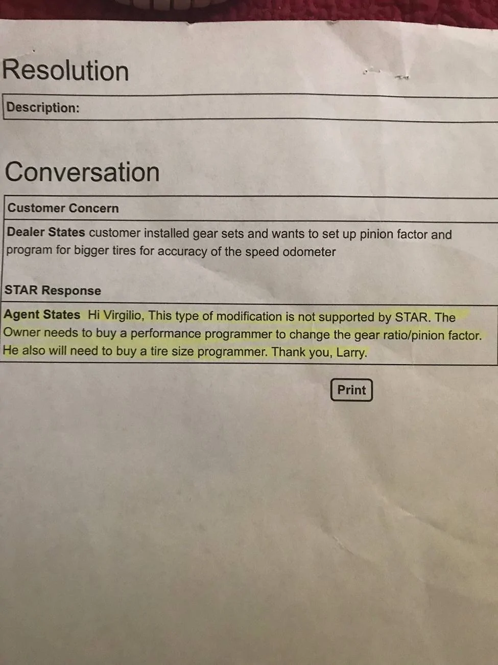

I doubt if the first question would make much difference, However, do recalibrate for gears. I got 35’s and didn’t bother to get a Tazer etc because I can add 4 to 65 in my head, no problem. But about 3 weeks after 4.56’s I got ā€œService 4 WDā€ - diagnosed ā€œoutput shaft speed-wheel speedā€ Jeep remarkably couldn’t recalibrate even though 35’s, 4.56’s had become a factory option and recommended aftermarket.
Jeep Wrangler JL Tuning for tire size 993F3B4E-51A7-4AC4-9E82-672B62AF872C
Requested in writing and Kept in case of attempted warranty denial due to the Tazer
Seems odd. I always thought that was an option even though I wasn’t personally interested. And that guy is acting like you need two different programmers?
Mine is a pre XR 21. He knew aftermarket was available, but maybe not the options…. That said……. Jeep couldn’t recalibrate for a factory option ?! I find that remarkable. The dealer tried for 2 days too, starting with flashing the XR code. It cleared the ā€œService 4WDā€ but didn’t recal. The warning didn’t return before I got the Tazer either. šŸ¤·šŸ¼ā€ā™‚ļø
