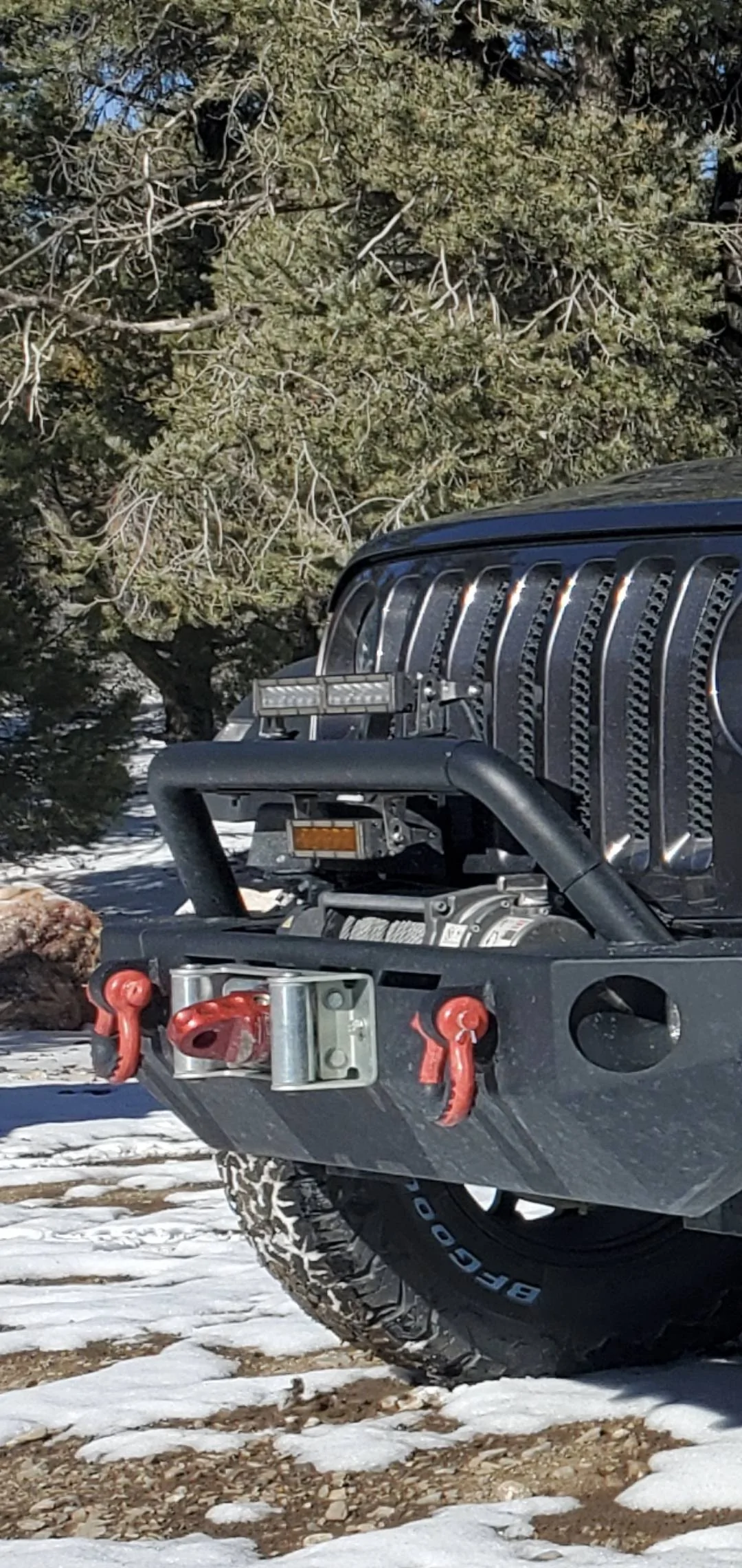

I have a diode dynamics 6" light bar with an amber fog pattern lens. It's a wide beam, but a very sharp cutoff, so no glare. I have it mounted on my front bumper bar just below the legal height for fog lights in Nevada. Works well in heavy rain, snow and helps to be seen when on dusty trails. They also have fog light pods with different levels of lumens, sport, pro and max I believe. Diode makes some really good products for the price.

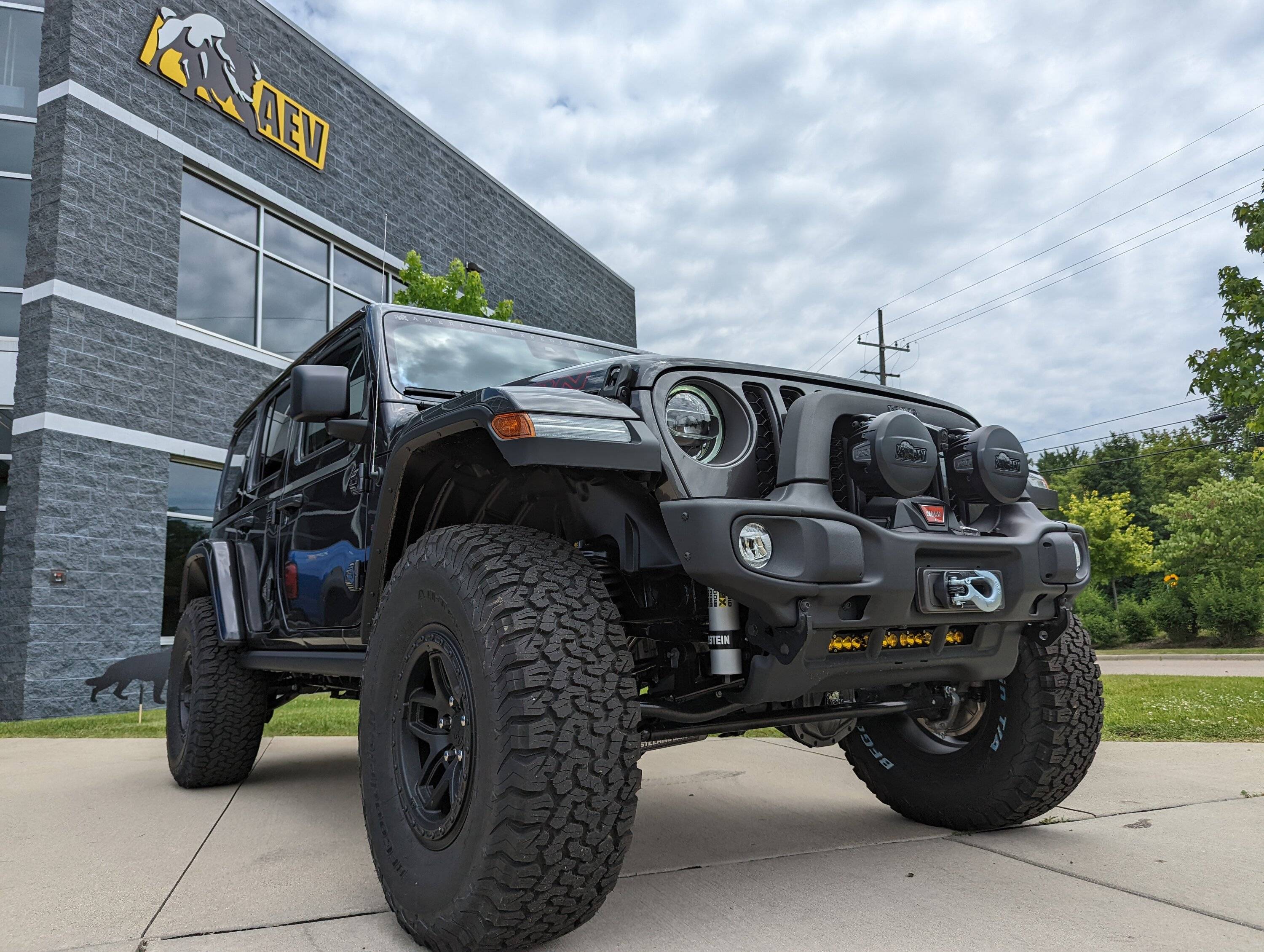

Really liking my Baja Designs Squadron SAE foglights in Amber. They're a direct plug and play replacement for the factory fogs and street legal; although, in the factory bumper I found I do not get as much light left to right as the standard fogs. Not a problem, because it puts A LOT of light right where I want it, and I find the amber (yellow) color much better for rain, dust, snow, etc.
If you're not looking to replace the factory fogs, you can look at the Squadron Sports or Squadron Pro's in a wide cornering pattern that will throw more light with a similar beam.

@scarab - I did something similar (I think I have the wide cornering ones) when I switched to the Mopar OEM steel bumper. My original plastic OEM JLUR bumper was sold with the LED fog lights to someone who was in an accident, so I needed a set of fog lights when I switched from the Motobilt Crusher to the OEM steel bumper. Agree with @Philly_ about them not being as bright but they are much more noticeable in rain (have not tested them in dust/snow). In a torrential downpour, as soon as I turned them on, the amber lighting cut through the rain much better than the OEM LED headlights. 100% worth it and they are street legal.
