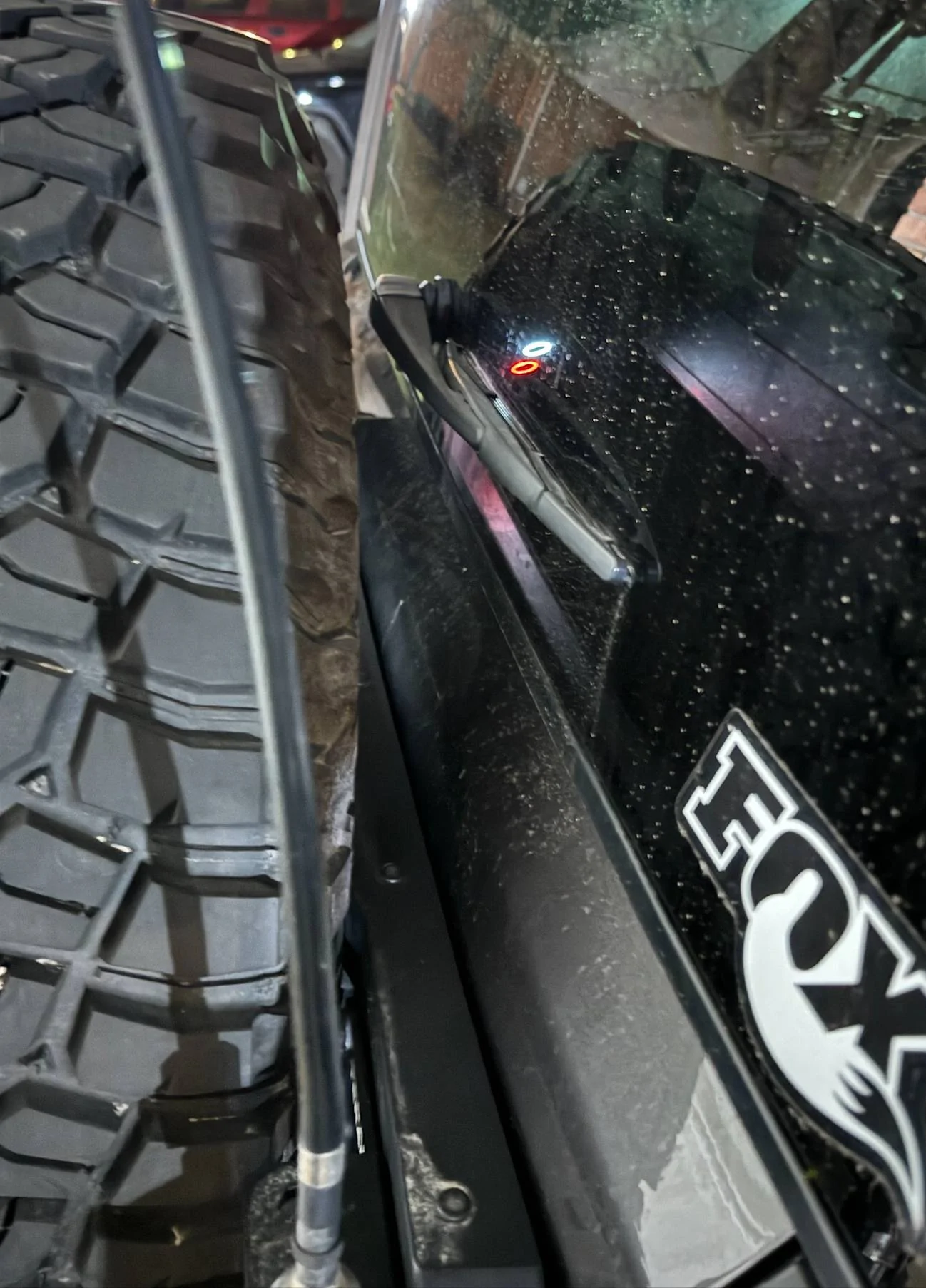

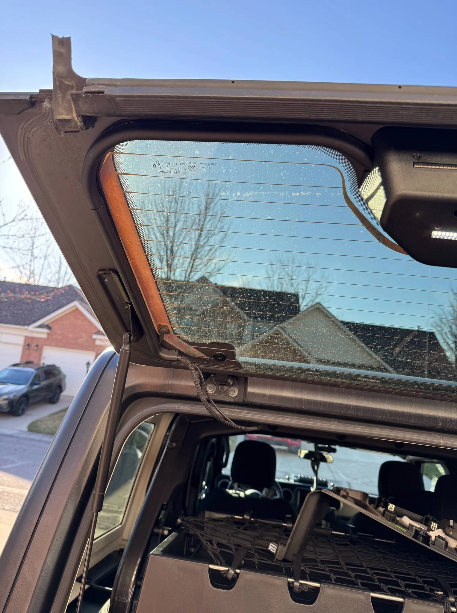

Older thread, but I just installed the Oracle light and the new production units have the same mentioned issues. The factory screws are too short to reach the wiper housing with the Oracle mold design. I just bought longer 4mm screws. The LED rings on the switches still stay on constantly. I’ll look tomorrow to see if the color coding is the same and cut the blue wire to kill the lights. They probably have a tiny draw, but I don’t want any more constant drain on the battery than what’s needed. No need for always on beauty lights on a switch. I have a cargo rack, so they’re hidden, but imagine they would be obnoxious in the rear view mirror at night.
Annoying and unnecessary feature. But the buttons themselves look and feel nice, and are in a good spot.
Jeep Wrangler JL JL Cargo Area Lighting Upgrade IMG_0758

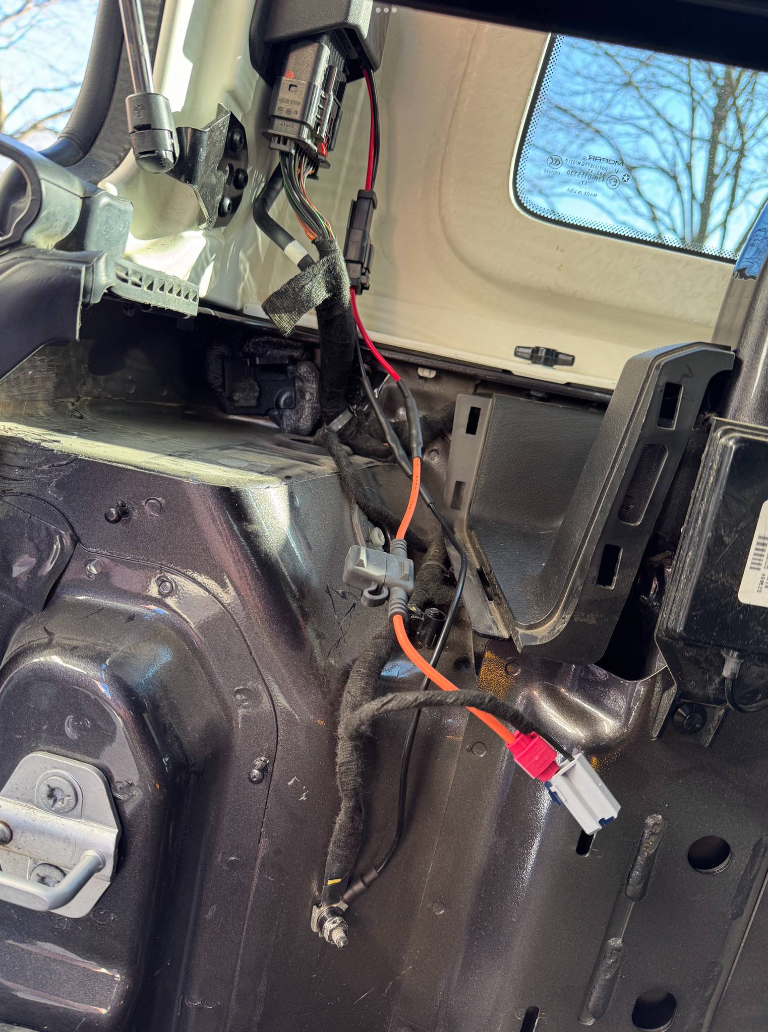

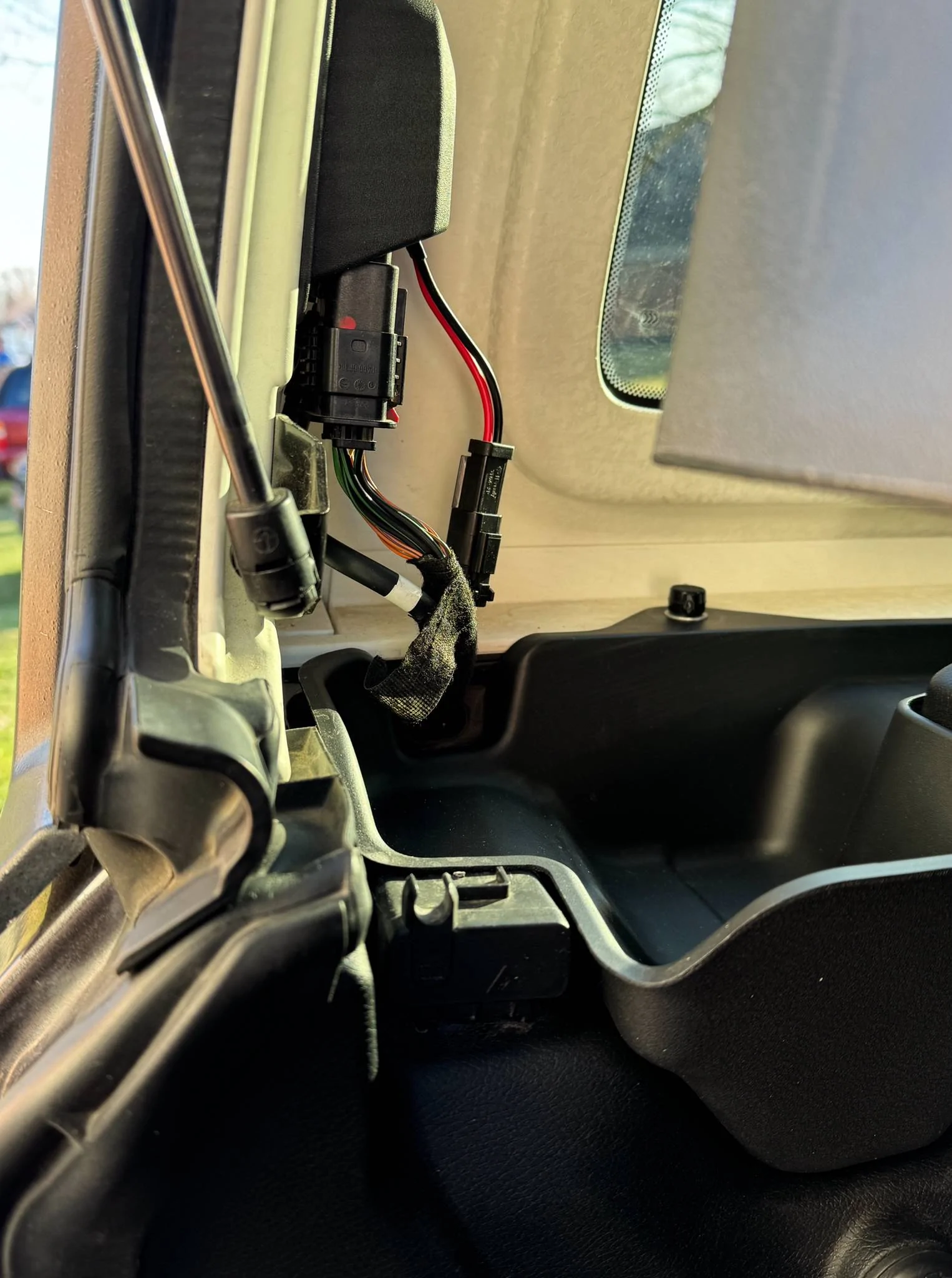

I tapped into the 12v socket by using one of those terrible wire tap clamps. A mini blade fuse was added to protect the wire up through the hard top. I left the blade fuse housing nested in the pocket under the cover that hides the tail light housing bolt to access the fuse if needed. Ground was run to the existing grounding post the factory harness uses. The quick disconnect I used was a water tight connector I poached from a cube light harness. The remaining run of cable was fished through the hard top channel that houses the factory harness, but it now “permanent” as the cable wedged itself in a tight seam inside the hard top structure. It’s there forever. Once the cable reached the glass there was JUST enough room to stuff the Oracle cable in the factory conduit.
Jeep Wrangler JL JL Cargo Area Lighting Upgrade IMG_0757
Jeep Wrangler JL JL Cargo Area Lighting Upgrade IMG_0755

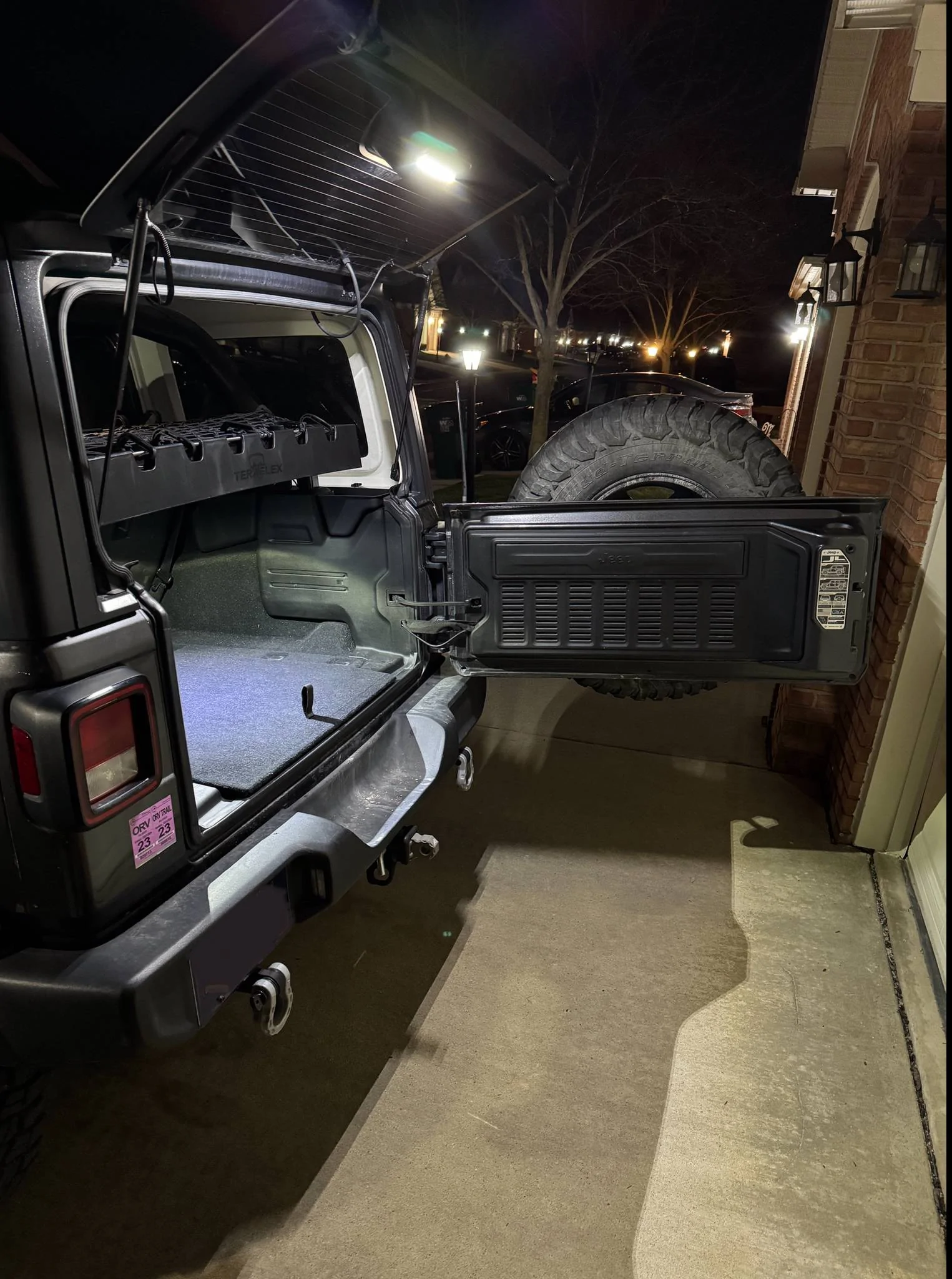

It is done, all in all it wasn't as bad as I was expecting. the power point tie in adapter from Quadratec sure made a difference.
I still need to cut in a connector so the top can be removed but that's a problem for future me
