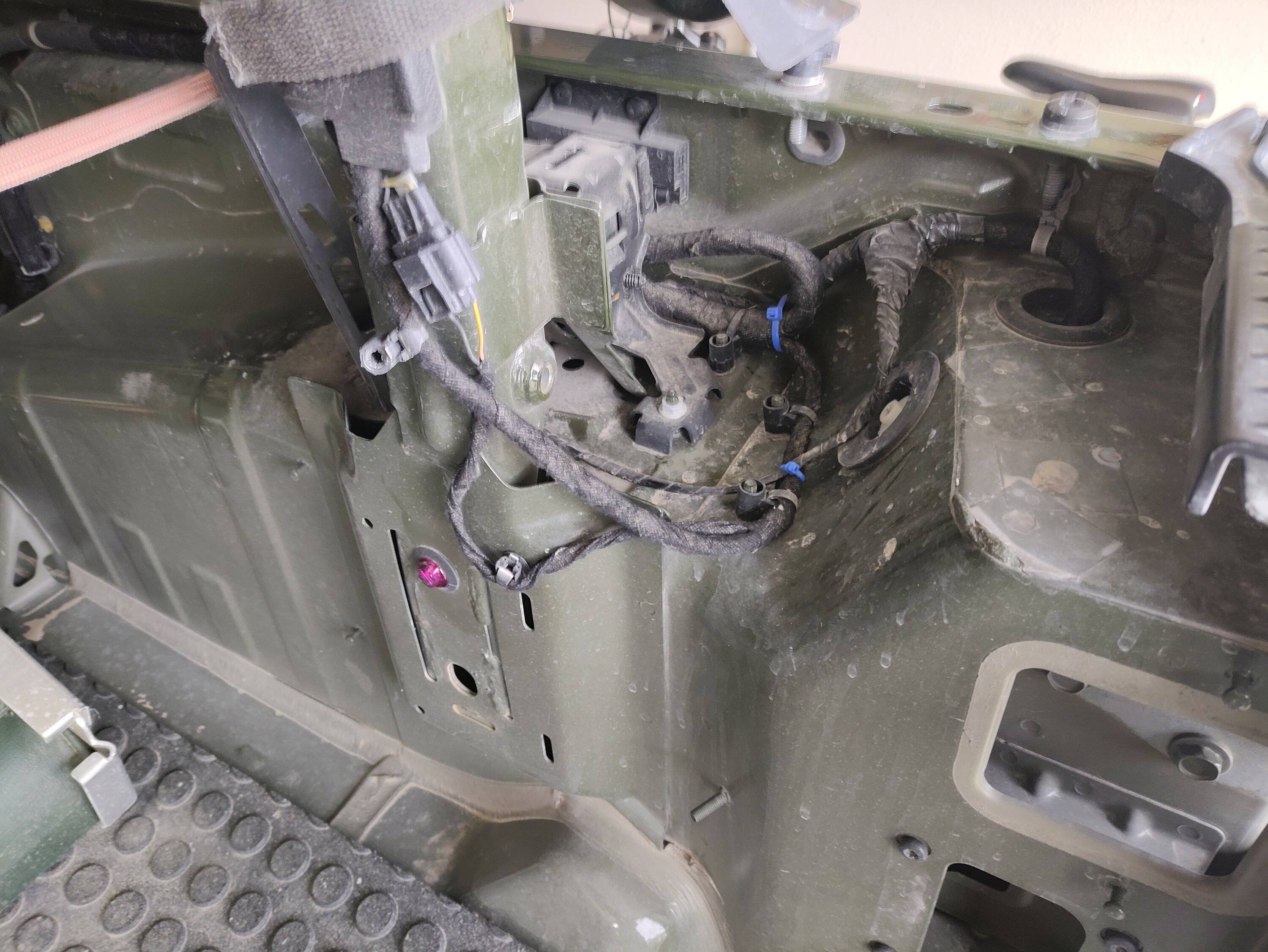

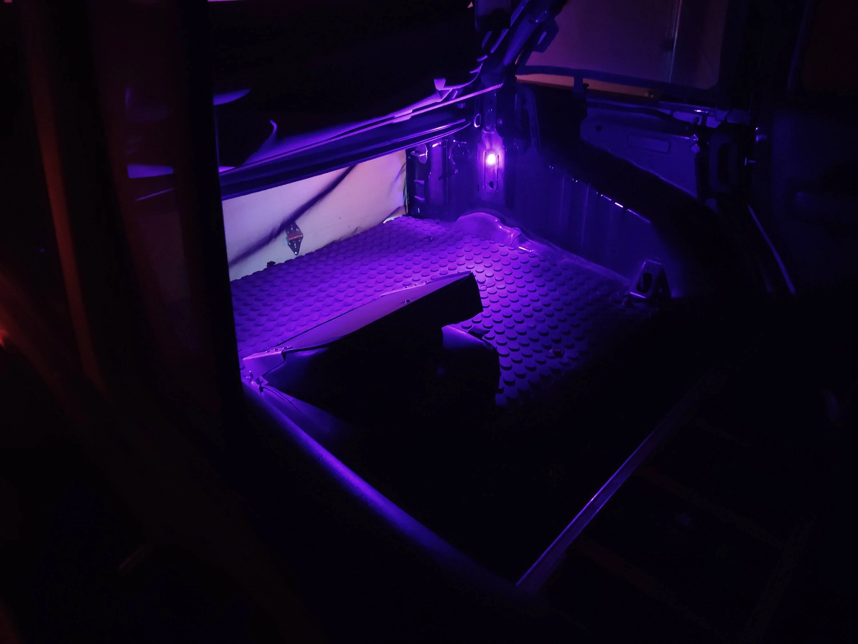

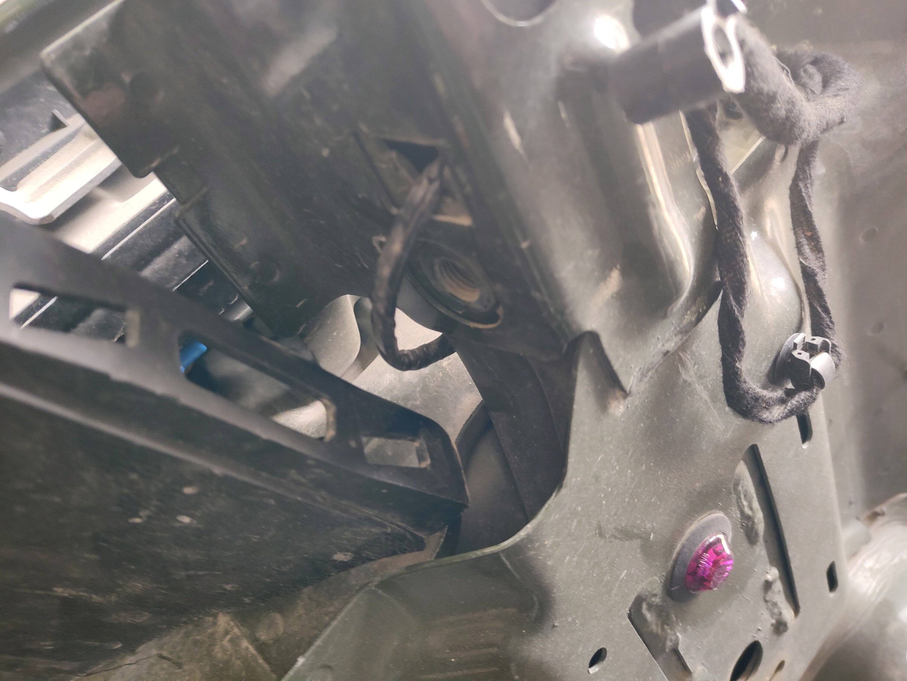

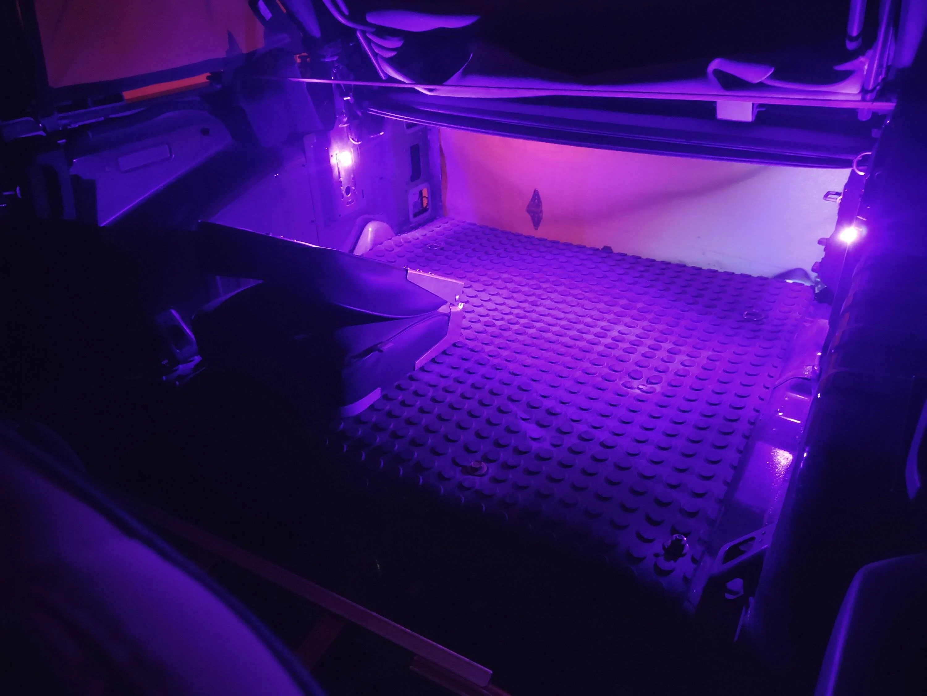

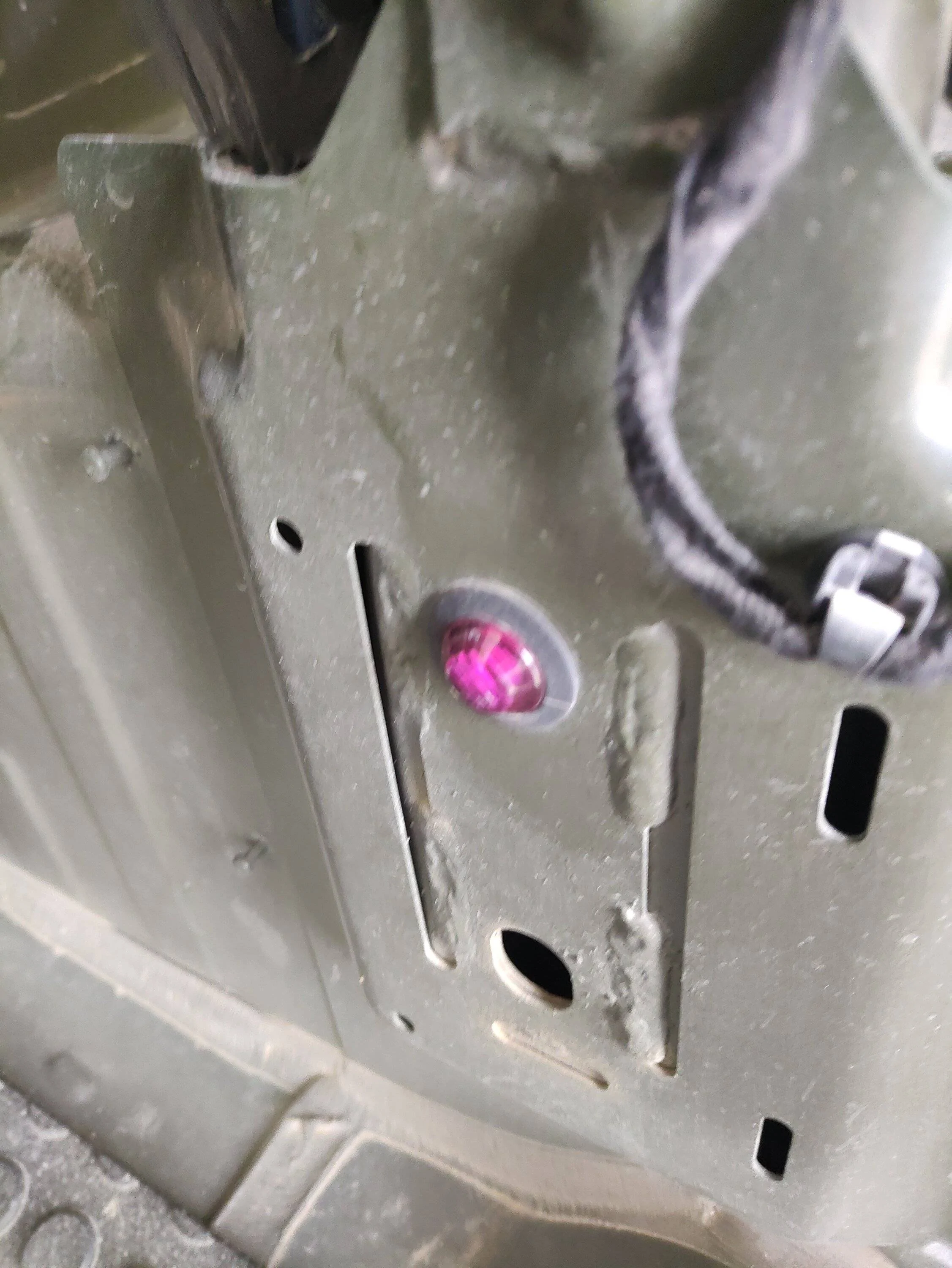

You're not going to like my setup, but it definitely provides ample interior lighting in the cargo area! And it costs about $8 all told!!!
Jeep Wrangler JL Cargo Area Lighting Solutions? IMG_20230418_160115072
Jeep Wrangler JL Cargo Area Lighting Solutions? IMG_20230418_160032710
There's a perfect size hole, I believe it was 3/4 in, OEM from the factory which you can easily pop these into. Wired into your side marker light, It will be on anytime your lights are turned on. Biggest downside is, you can't have trim in your cargo area. But if you like me, and you don't like the trim to begin with, it's perfect!
Jeep Wrangler JL Cargo Area Lighting Solutions? IMG_20230418_155901086
The whole you popped a light into backs into the c-pillar, so you just need to rope the wires out and attach it to the side marker light.
Jeep Wrangler JL Cargo Area Lighting Solutions? IMG_20230418_155917019
If you do run this route, your best bet for identifying the side marker light is to remove your tail light and identify what color wire the side marker light is, and then finding it in the wrap inside your cabin.
Jeep Wrangler JL Cargo Area Lighting Solutions? IMG_20230418_155856956
So long as you wrap it up properly, it's not anymore out of place than the original wires from the factory.
Jeep Wrangler JL Cargo Area Lighting Solutions? IMG_20230418_160919084
Best part is, you get 10 of these in a pack from Amazon for about 8 bucks if I remember right. So I have 8 more purple lights I can do other stuff with.
Jeep Wrangler JL Cargo Area Lighting Solutions? IMG_20230418_160227619
Obviously you don't have to go with purple, I just wanted something that was a little bit different color-wise that stood out. Also worthwhile to note that whatever piles of lights they were picking these out of, it took six different orders for Amazon to get it right in ship me purple lights. They kept shipping me red lights with a tag that said purple. I guess after five returns from the same person somebody thought maybe they should check and see if they're actually purple before they throw it in a pouch and ship it out.
Obviously not an option for everybody, but if you don't like the trim just like I do, it's a really nice tidy and easy to do option for little to no money.

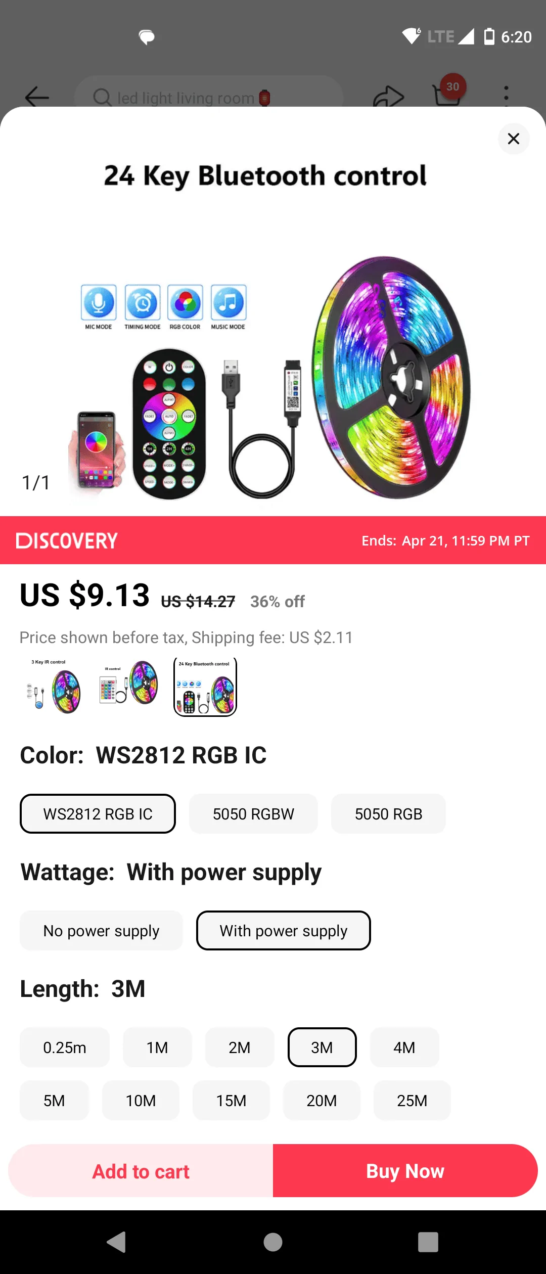

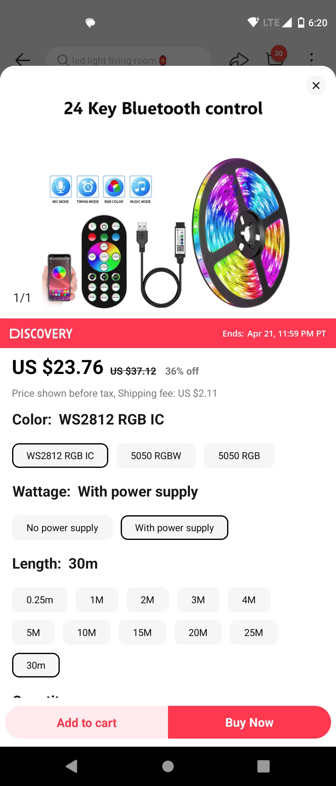

This one's pretty nuts, I saved this one to my cart because I'm going to order this later. However in your scenario I wouldn't recommend more than 3m of stripping because otherwise you're going to be lining your entire interior. Personally I would only recommend 1m or maybe 2 m max.
US $0.68 36%OFF | WS2812B Bluetooth LED Strip lights 5050 RGBW Remote control panel+power supply tape diode LED neon night light for room TV
https://a.aliexpress.com/_msRLacs
Jeep Wrangler JL Cargo Area Lighting Solutions? Screenshot_20230418-182004
Under $30 for 30 m of Bluetooth controlled RGB LED strip lights, that's an insane deal!!!
Jeep Wrangler JL Cargo Area Lighting Solutions? Screenshot_20230418-182023
If you so wanted to, you could probably get this same stuff from Amazon, but you're more than likely going to pay multiples of what it cost to get it from the manufacturer (i.e. China).

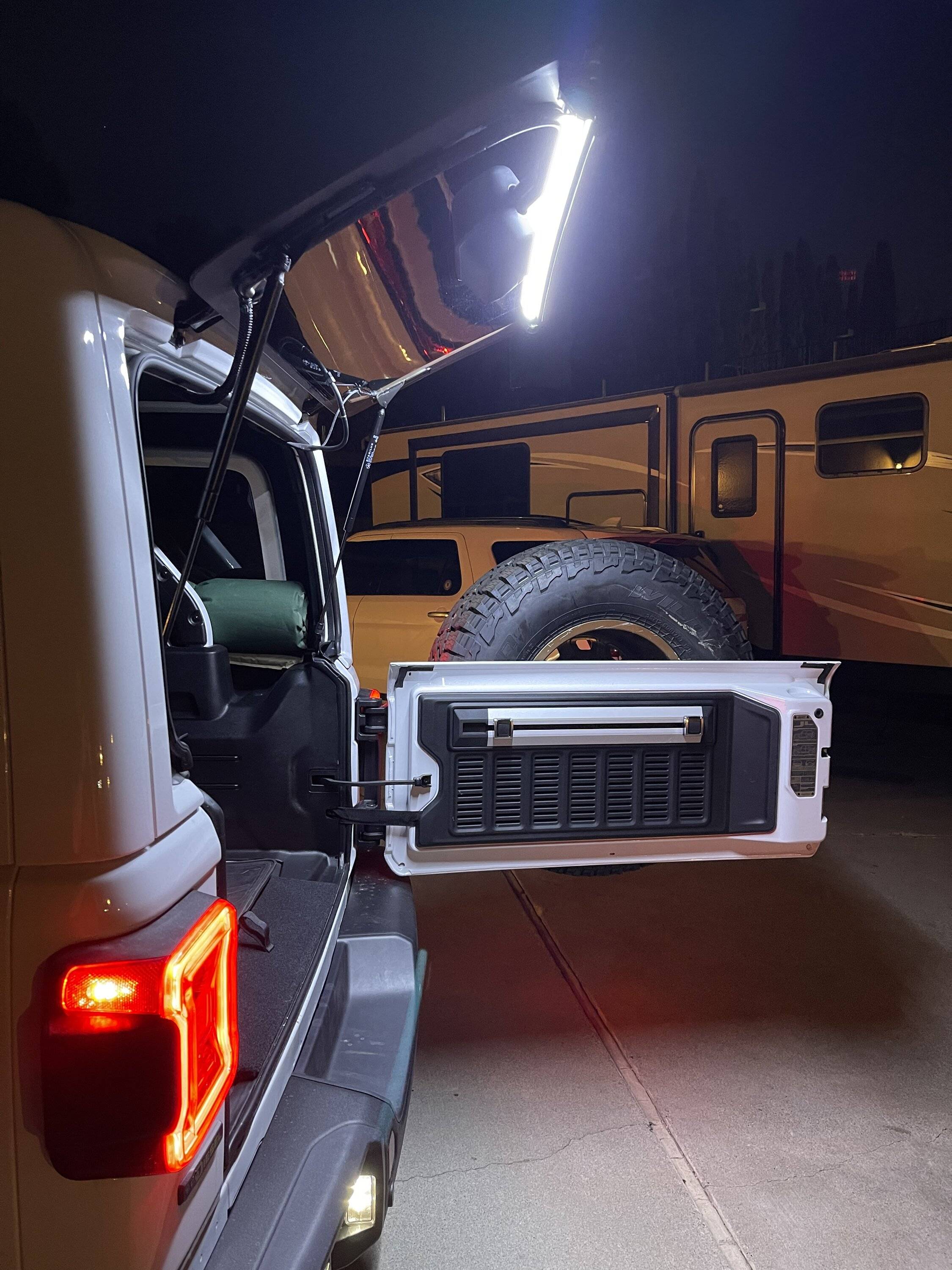

If you’re looking for general lighting, Check out the Brawlee light. The latest version is made with heavy duty silicone rather than aluminum, so there are no issues with it following the curvature of the tailgate glass. For ease of installation, use the Quadratec 12 volt power adapter. There’s a 10 page Brawlee thread on this forum.
https://donerightled.com/collections/frontpage/products/jeep-wrangler-led-lift-gate-dome-light-bar
https://www.quadratec.com/p/quadratec/12-volt-power-adapter-jeep-wrangler-tj-jk-jl-jt

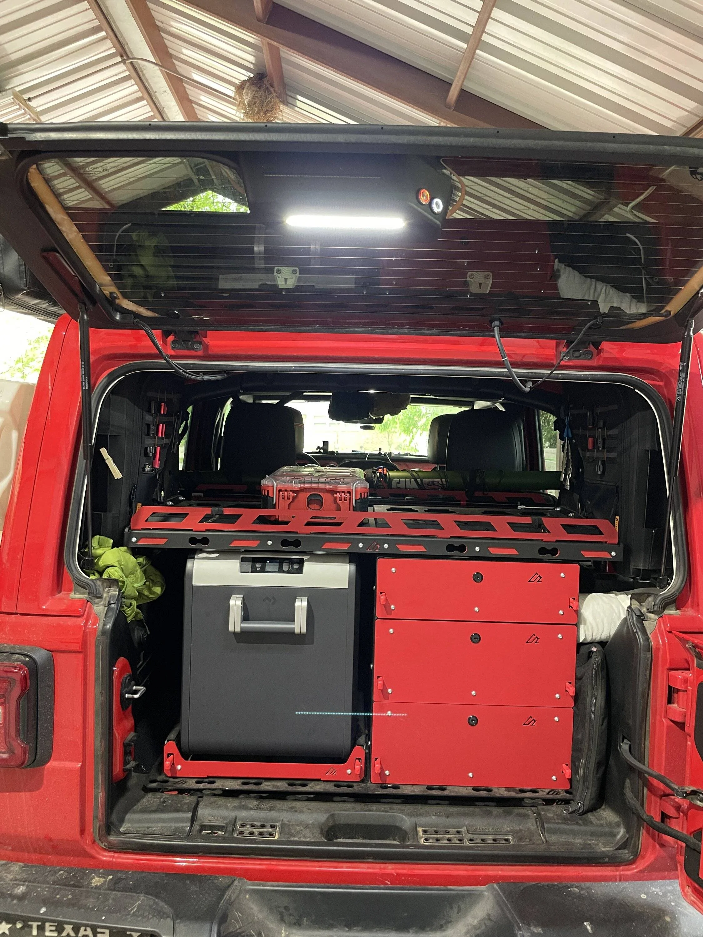

Another vote for the Brawlee. Super bright, looks very clean installed and they have great customer service. I really like that the light spans the length of the glass hatch for total coverage of the cargo area.

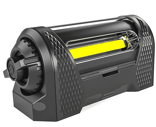

I too have this and am quite happy with it. I also keep one of these in the back. Magnet keeps it stuck to the roll bars and it rotates so you can point it where you need more light.
https://www.amazon.com/gp/product/B07BL5KJ3Y/ref=ppx_yo_dt_b_search_asin_title?ie=UTF8&psc=1
