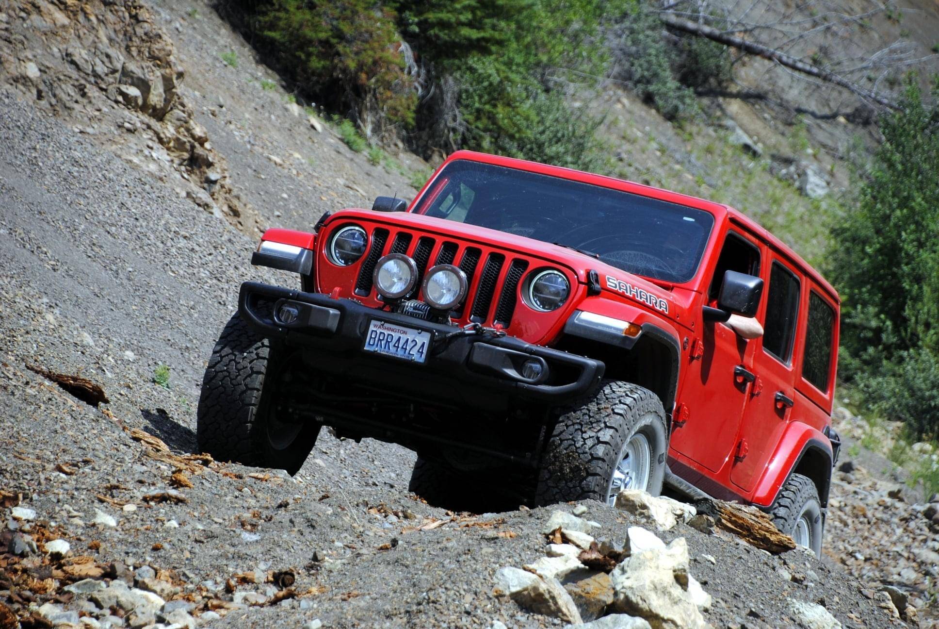

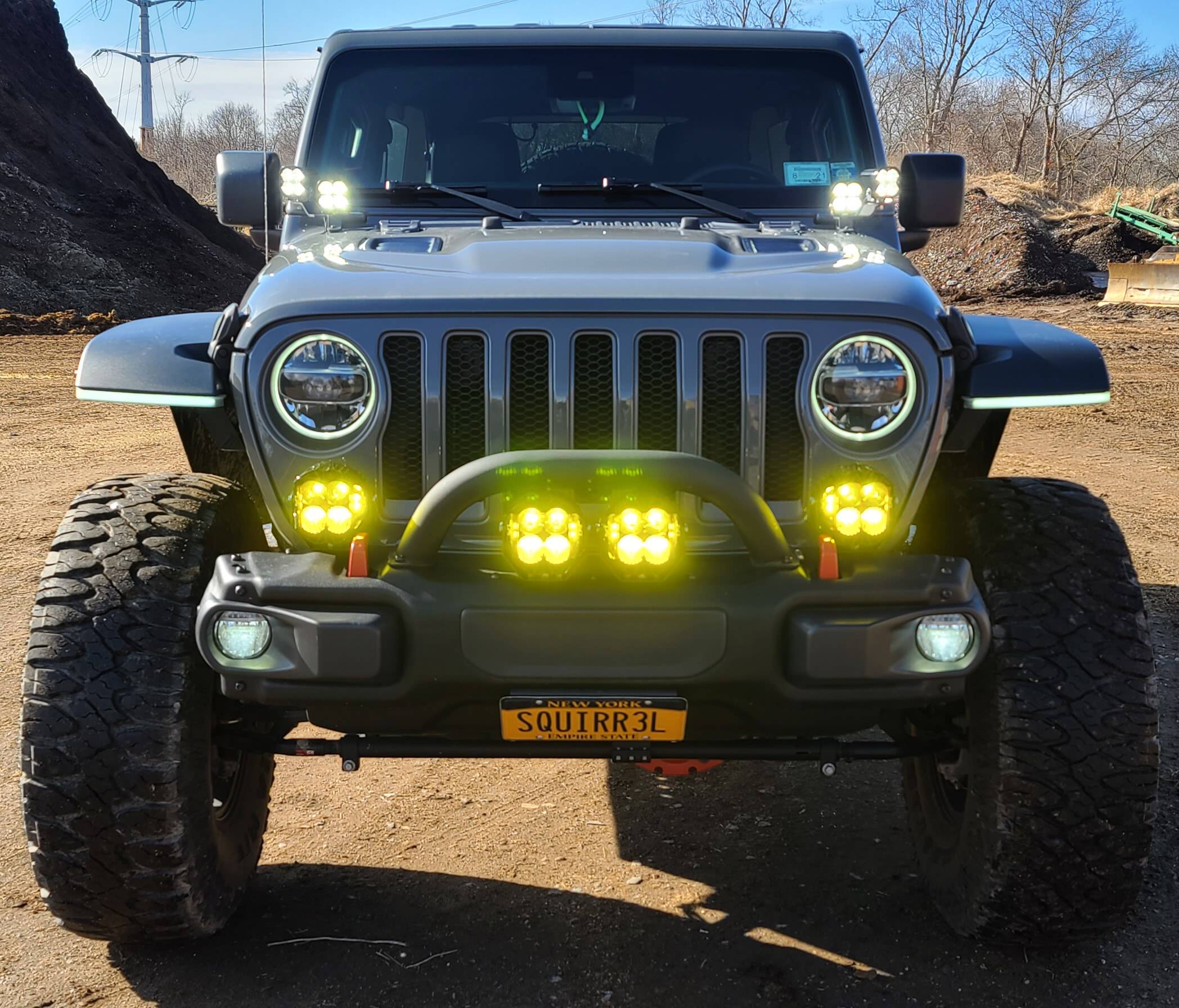

Bumper and a-pillar pod lights have worked very well on my Jeep.
First off, what front bumper do you have? And does it have a bull bar?

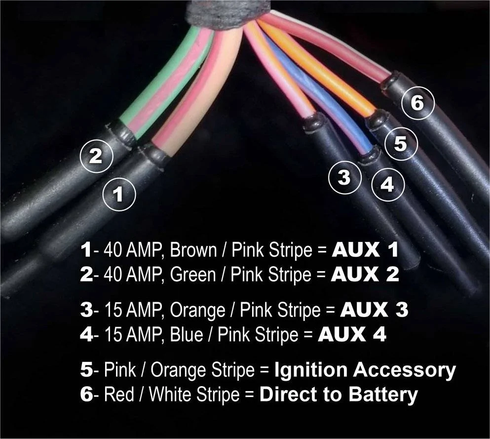

My manual shows that there are factory aux connections both under the hood and inside the cabin for aux #1 through #4. Why would you need to go through the firewall?

there is a wire bundle for the AUX Switches in the engine bay near the battery, no need to go through the firewall to wire lighting.

The aux switches wiring can be accessed from a taped up bundle of color coded wires, both under the hood on the inside of the passenger fender next to the main battery and a 2nd bundle behind the glove box. The system is already set up with fuses and relays, so all you need to do is to wire the positive wire from the lamp to whichever aux switch you choose, and than hook the ground wire to the aux ground studs that should be right next to the aux wire bundle under the hood. Hope that made sense. ?
Jeep Wrangler JL Looking for rally lighting upgrades advice 12v source wires
The bundle under the hood will include numbers 1-4. The bundle behind the glove box will have all 6 wires.

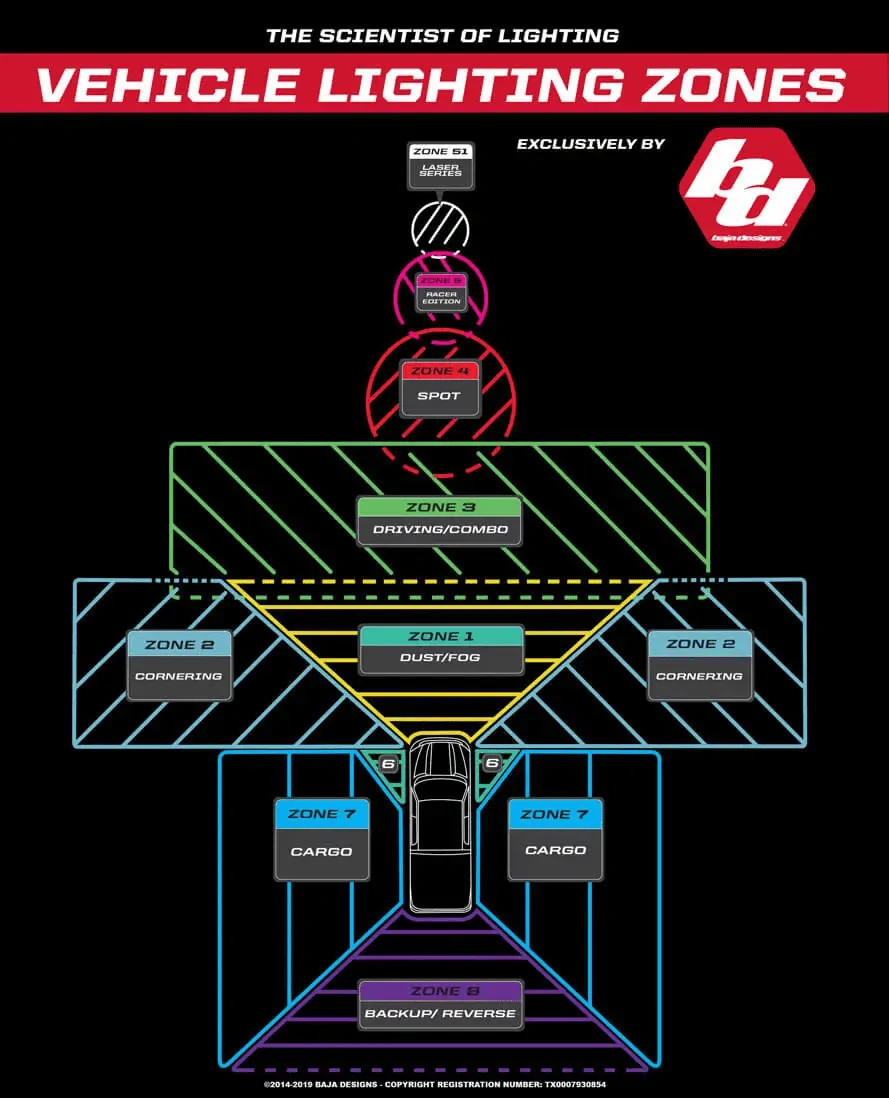

While A Pillars may be the easiest install, it's not necessarily the best location if you are only looking to install a pair. Unless you are ditch lighting to the side, you'll want spots on the pillars to keep the light from getting thrown all over the hood. While spots are good as part of a lighting system, I'd lean toward a combo (driving+spot) beam if you are only doing one set. The best place for that will be the front bumper.
EDIT: I run KCs, but another great brand (and forum supporter) is Baja Designs. They do a great job explaining the lighting pattern basics in their zone information. I'm recommending Zone 3 if you only do one: https://www.bajadesigns.com/help/lighting-zones/

AND wiring is EASY! you DO NOT need to use ANY of the wiring harnesses that come with any lighting kit. Why? each Aux switch wire is already in a fused circuit and a relayed circuit.
You simply cut the positive and negative of each individual light at the farthest point away from the light so you have plenty of wire length to get to the Aux Switch wire under the hood and to get to a grounding point. You WILL need to tie both the positive wires from the lights together and then attach to Aux switch wire & tie both ground wires together and ground to a body ground (there are plenty under the hood and right next to the battery). THAT SIMPLE :clap: :like::rock:

My thoughts exactly, as far as bumper vs a-pillars. That's why I previously asked what bumper was on the jeep. If the factory steel, Maximus-3 has a great bracket that accommodates 2 pod lights, so everything would be bolt on and plug and play. No permanent drilling like OP wanted to avoid. If a different bumper, but has a bull bar, a tube clamp is another non permanent solution.
Also, keeping the light lower to the ground on the front bumper would lessen bounce back when driving in fog/dust/snow conditions, compared to on the a-pillars.
