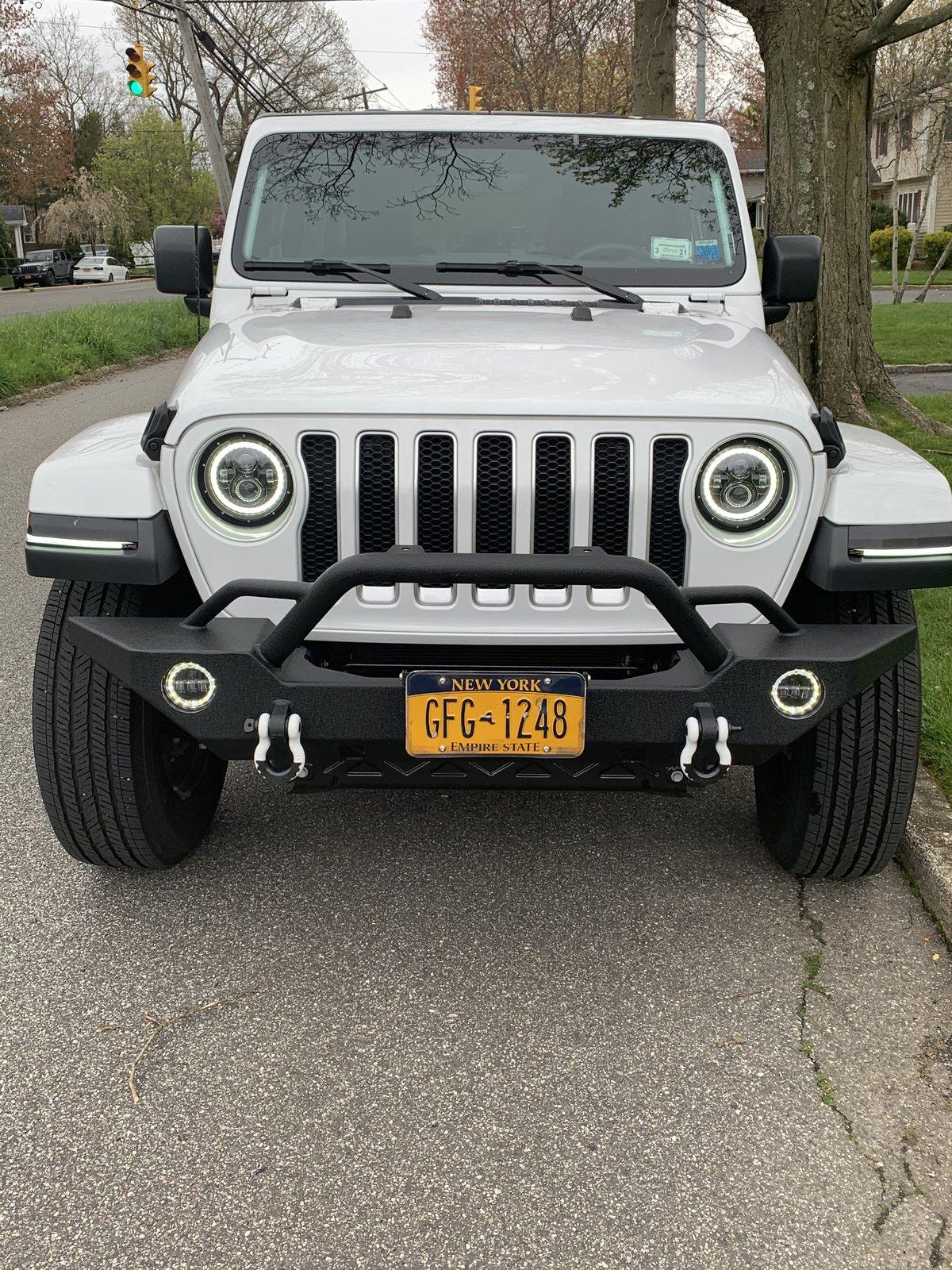

Recently bought a used 2018 Sahara that did not come with the factory LED package. I upgraded my Fog, fender and headlights with their DRL and I couldn’t be happier. These are true plug and play. No dealer flash needed to have the DRL on. I recommend then to anyone looking to replace the factory halogens. I’m getting my tail lights delivered this week and will post a pic once installed.
Jeep Wrangler JL Quake LED lighting upgrade C98A5F8E-4C05-43CF-AE18-8977BF8B6A07

Just curious - did you do any adjustments to lights? I installed these on stock jeep with 33" tires and get flashed by drivers.

I have Sport S with Rubicon suspension and 33" tires. Installed these with no adjustment and never get flashed. Maybe due to my Jeep having some rake?

I have the Quake lights also on a Rubicon with 33's and stock suspension. I did have to adjust them down because I was getting flashed by other drivers. No rake on my Jeep. I think I ended up putting two or three washers on the top bolts only to angle the light pattern down. I think I saw this method on Quake's website. Worked for me, but it is sort of a guessing game as to when you have them at the right level.
