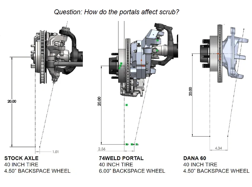

How much more stress is placed on the control arms with that much more leverage from the portals?

I'm waiting for someone on here to buy these and wheel 39's with a stock axle and suspension setup.. If I was a rich man I'd really consider them. Having a shop throw on a lift kit + bigger brakes + regearing adds up for sure. I don't think to $25k but still...
They're claiming that the leverage an axle experiences with portals and big tires would not be much more than without portals (with correctly offset wheels for each respectively). Since the portals push the hubs out a few inches, you can get away with a higher backspaced wheel (like 6" or so) for something like 40's. Where as without portals, you'd need 4.5 of backspace or less to clear that big of a tire. The wheel backspacing evens out with the added leverage of the portals. Whether that's 100% true or not I don't know, but this diagram looks believable..
