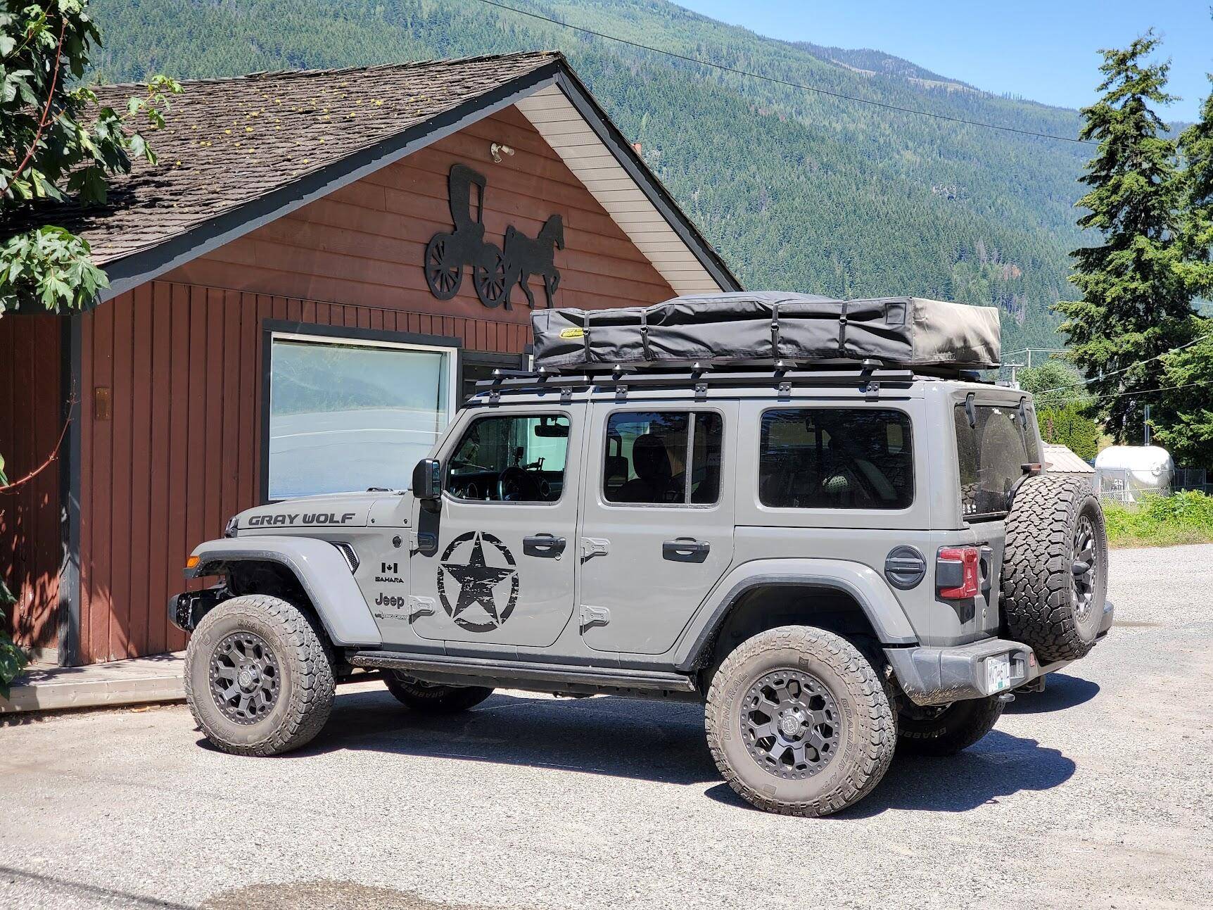

If you are looking to run 35s on a 2021 Willys with low clearance fenders you would need about 2 to 2.5" lift.
My previous jeep was a 2020 JLU Sahara. Stance and lift wise it should be similar to Willys with the low clearance fenders.
I had a @Clayton Off Road 1.5" Ride-height kit and later on I added 1" spacer in the front and 0.5" spacer in the rear as I loaded up more and more (steel bumper, winch, roof rack, camping cargo, fuel, water etc..)
Jeep Wrangler JL Lift advice thread # 13892 1719805364271-f8
Before I added 35s, and the 1/0.5 spacers - I used to run 33s on Clayton's 1.5 lift as is. It doesn't look that bad.. i felt it looked great on 33s
Jeep Wrangler JL Lift advice thread # 13892 1719805624141-29
Now coming to tires - you are likely on narrow track axles, M186/D30 front and M210/D44 rear. You are better off sticking to 35s as maximum. Since you have narrower axles than rubicon (0.75" less inward clearance for tires per corner) you will need to think about whether you want to go regular 35s (35x12.5r17 width or 315/70/17) then you might need to use wheel spacer or invest in another aftermarket rim with less backspace. If you love the Willys black rims, Quadratec makes a replica of it with better specs 17x8.5 +10 offset that will clear regular 35s on narrow track axles.

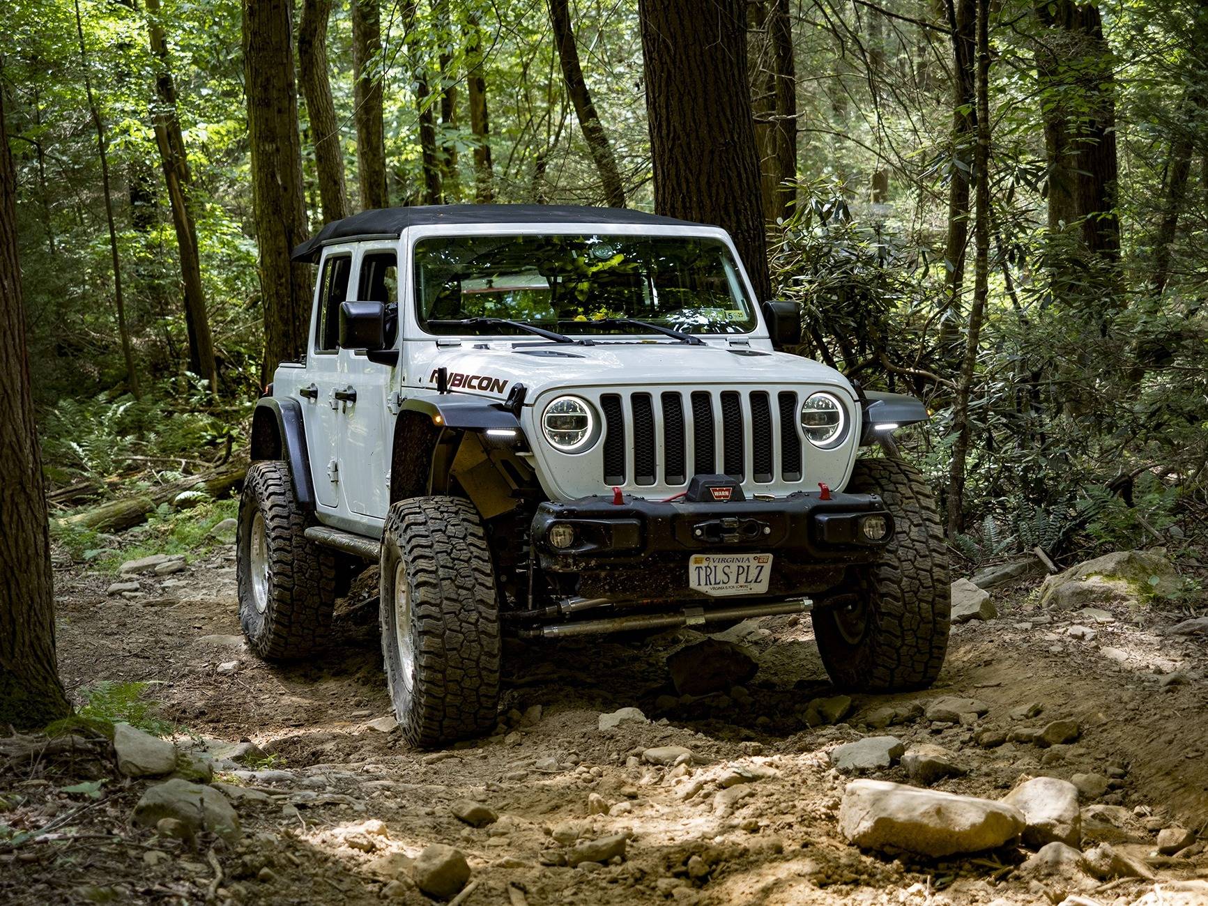

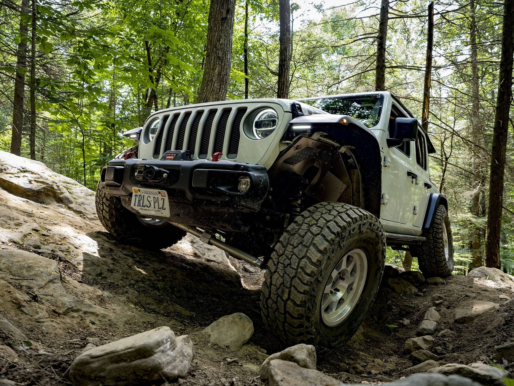

I have the Clayton Ride Right, 1.5" lift and have done everything from commuting to black trails on this lift. That's 2 F Upper control arms, F / R track bars, springs, shocks... Everything else is stock (other than bumpstops/endlinks). This can be had with the Fox shocks for the low $2k area you're looking for.
It rides very well and flexes fine, more than most will ever use IMO.
Given I now have gutted fenders so it'll look different, but prior to my current wheel/tire combo I had skinny 35s and the overall setup did the 3 BOH trails + others at Windrock without issue

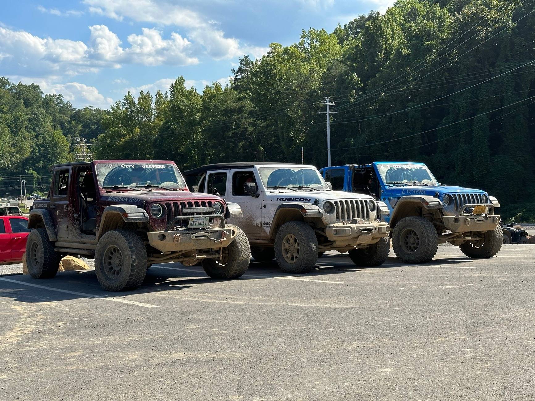

Here it is next to a few MC lifted jeeps at Windrock
