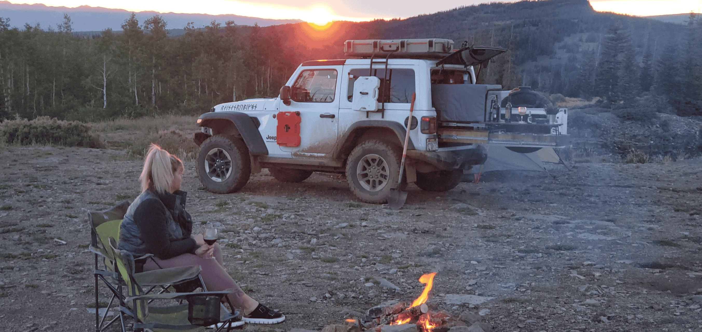

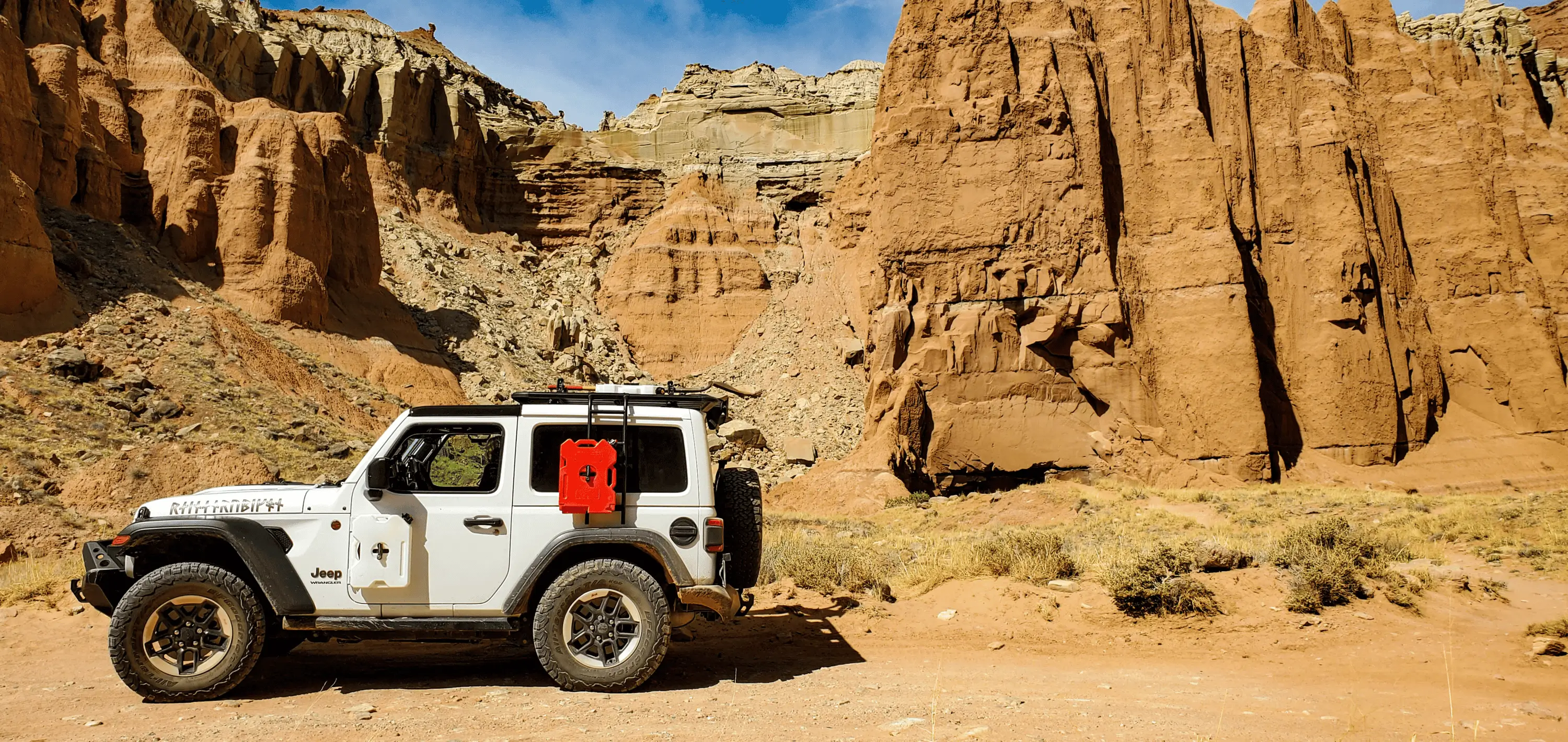

I dunno what they're talking about. I had the OEM Rubicon suspension.
Did I have a squat problem?
Did I bash my bump stops if I wasn't careful?
Did people flash high beams at me?
Did OME resolve it?
See for yourself.
OEM Rubicon Suspension:
Jeep Wrangler JL (Yet Another) Lift/Spring Advice Thread 1695008347237
OME 2" Heavy Load Suspension:
Jeep Wrangler JL (Yet Another) Lift/Spring Advice Thread 1695009113770
And I'm very likely carrying more cargo on the OME.
