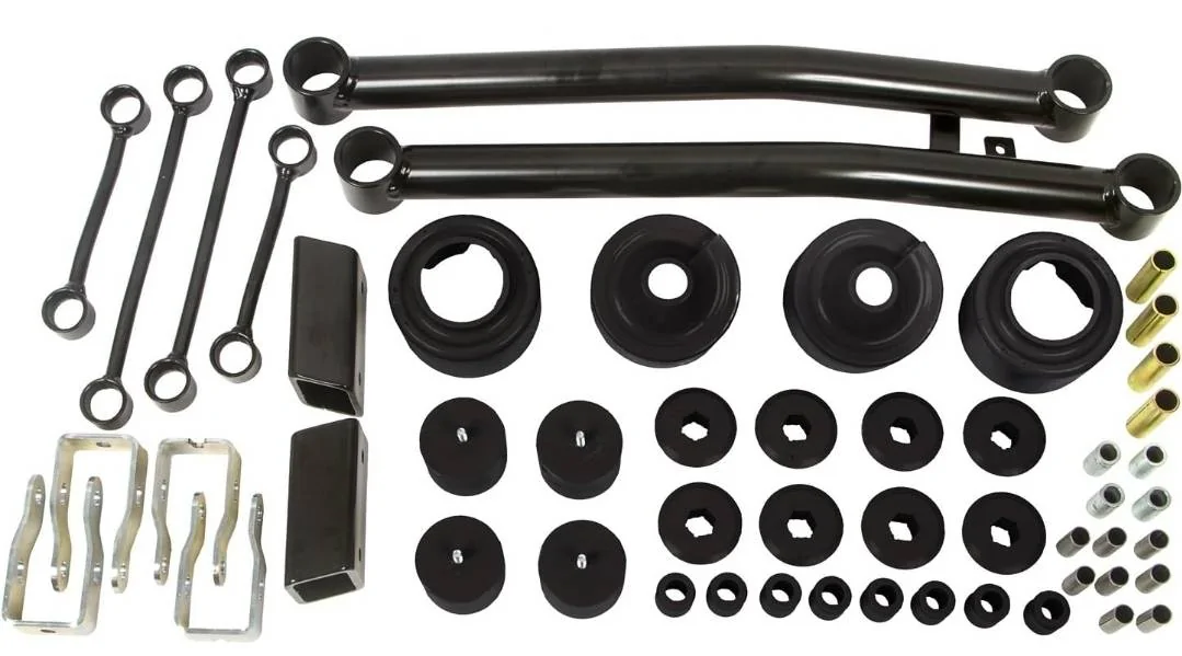

I don't understand why everyone does this lift vs the Daystar like I started with. Both of them are similarly priced, but the Daystar kit is so much more complete. It hits Amazon regularly for 300. And it actually includes a lot of things.
Cuz it has all sorts of scary looking pieces when you're a weenie who just wants to level things out a bit (and maybe get another inch while at it). But food for thought!
All that "scary" stuff helps to make your Jeep ride better. If you don't want to do this kit because you have to assemble the bushings and stuff, then I still recommend adding lower control arms, the Mopar ones work, and are cheap. Move the rear sway bar links forward, and get longer rear sway links. Shock extensions, and bump stops.
