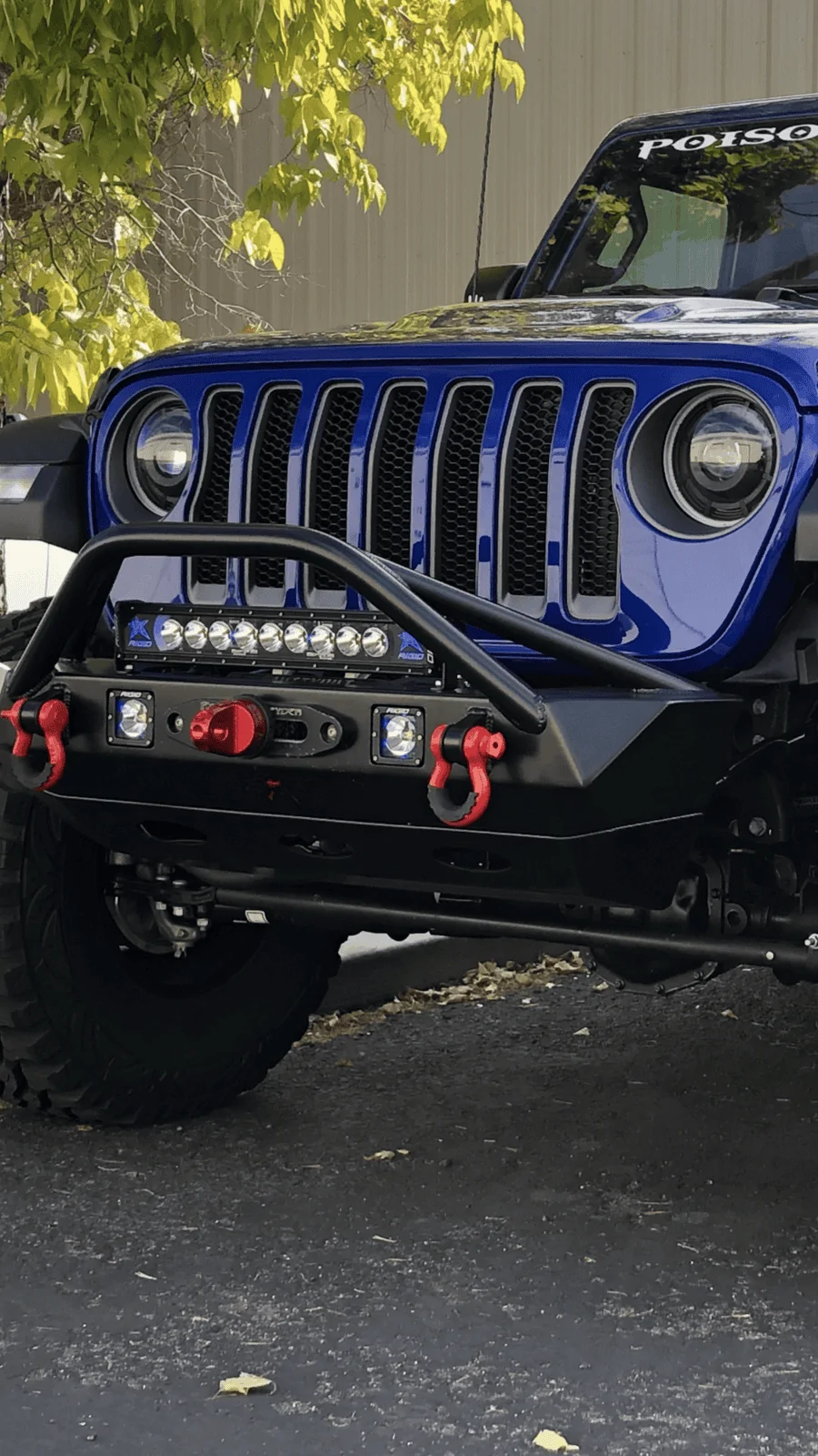

It's a common problem with all LED lights. LED lights don't generate heat so they don't melt snow. Many cities in the Upper Midwest found this out when they switched their traffic signals to LED for energy conservation. It's a great idea in theory, but when it snows the traffic lights are covered and no one can see them.I just drove 2 hrs in the PA incoming rain/snow. And couldn't even see the road. It was like my headlights pointed up and I was driving into a white wall. Even the stock jk shit headlights had more light.
After stopping for gas I saw the lights covered with slush all but the top 2". After clearing it was easy to see thru the snow. This pic is after 2 min drive from gas to job I think these lights need heaters!
