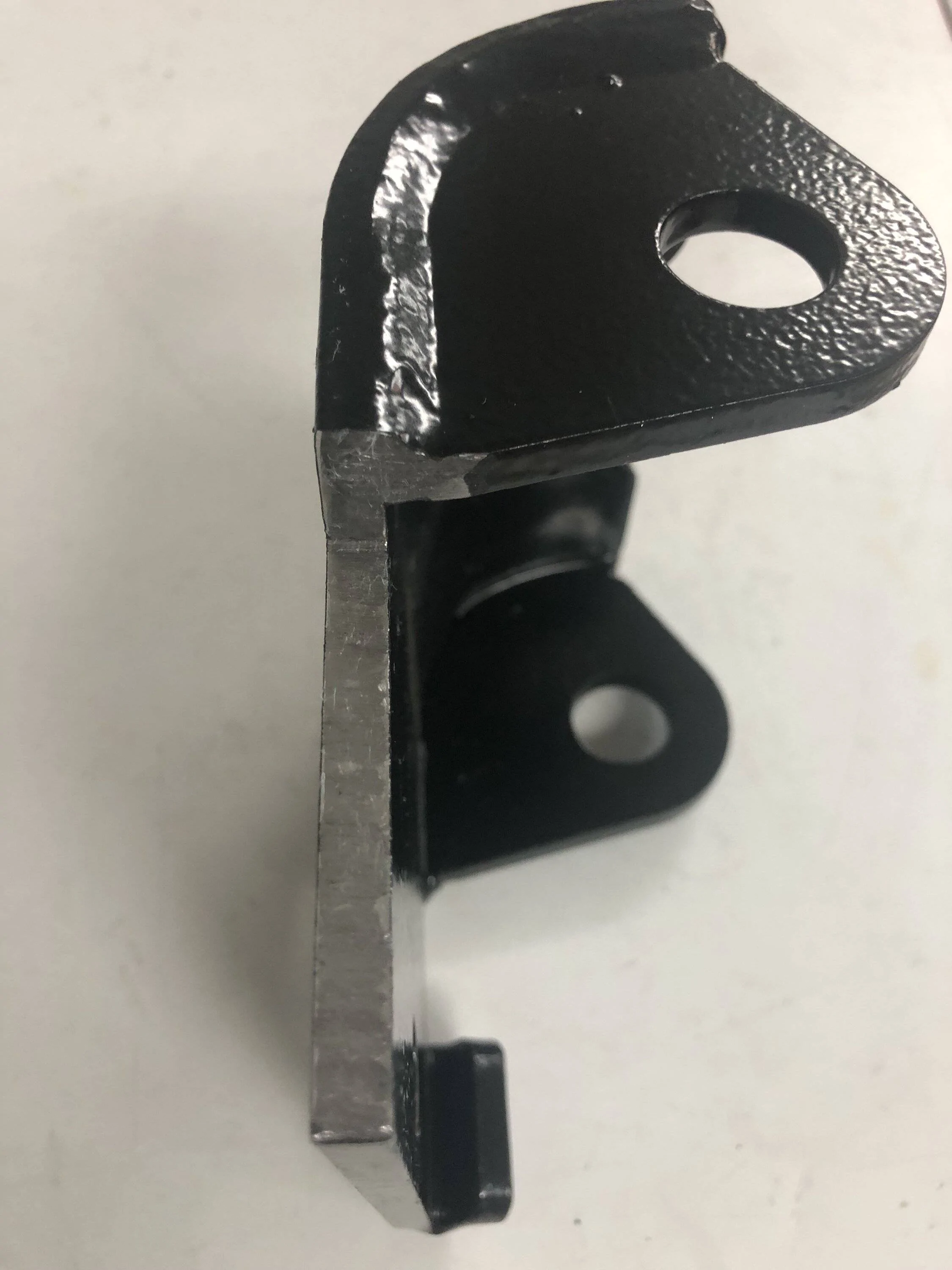

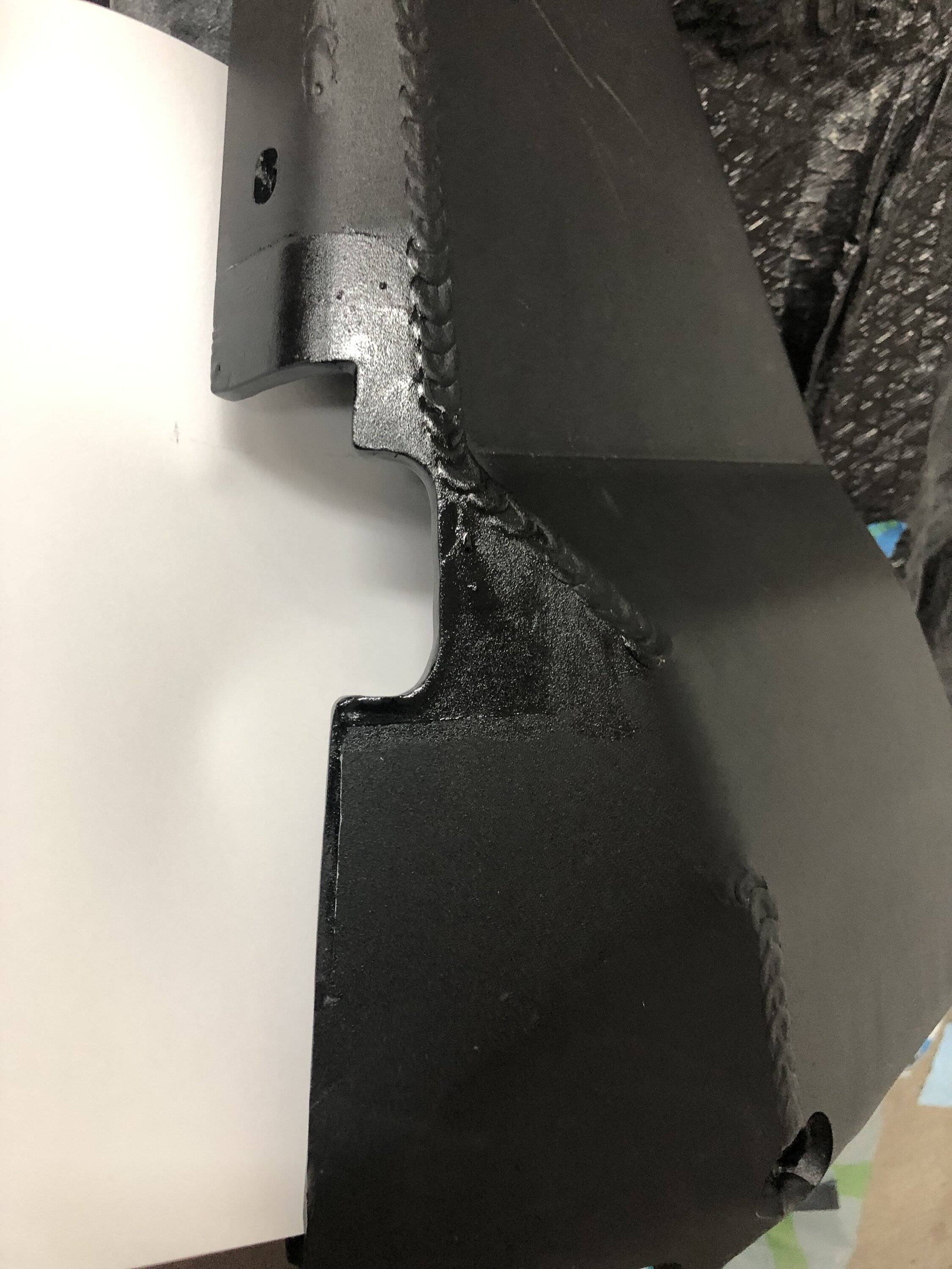

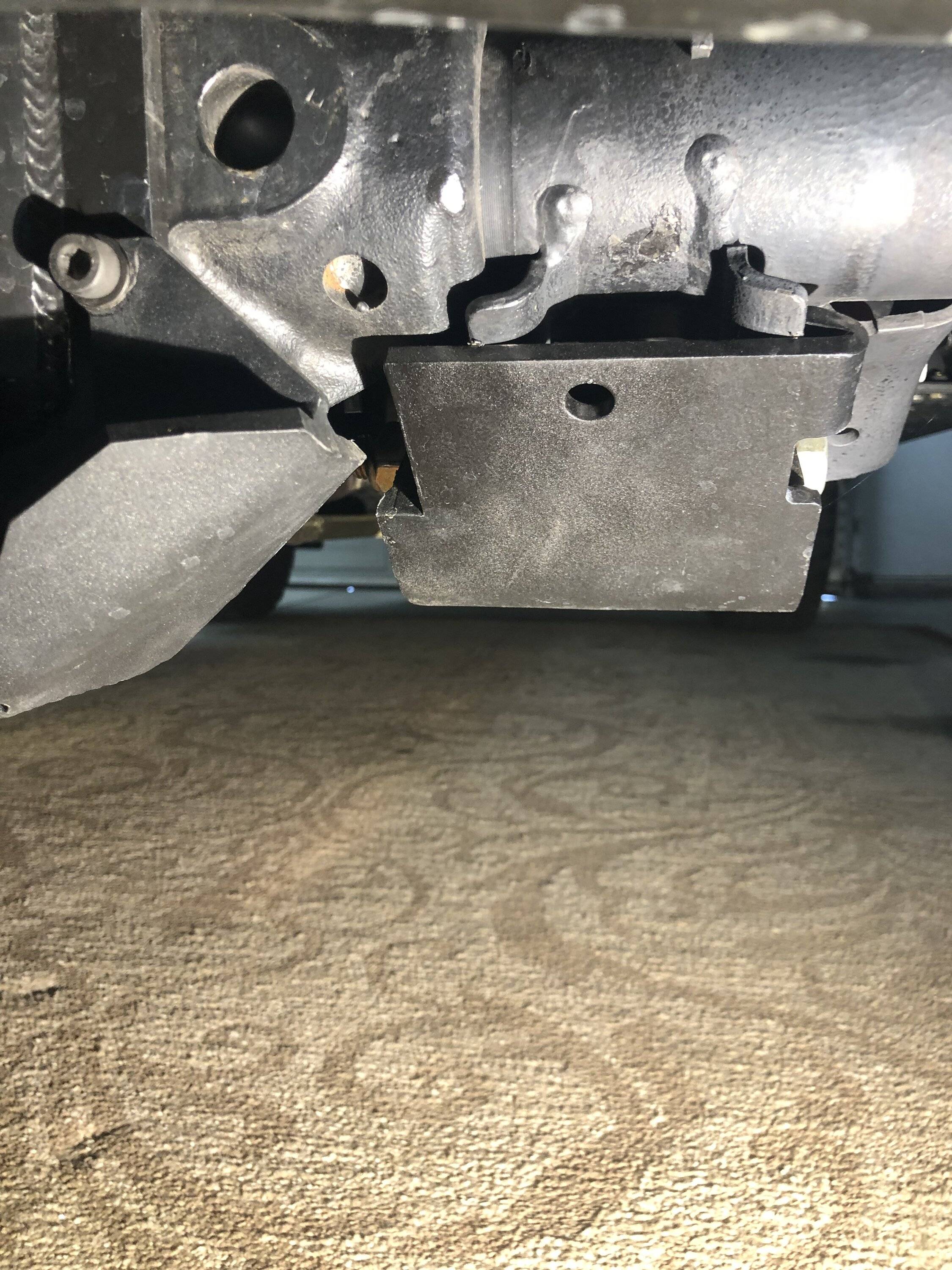

Hardrock4x4 front lower control arm skids will require you to modify the Metalcloak FAD skid if you have it. I switched to the Hardrock4x4 FAD skid. They may also also interfere with the newest version of the Next Venture Rubicon front diff skid and require modifying both pieces to have easy access to the LCA skid mounting hardware. As was already said their hardware is prone to rust.
https://www.jlwranglerforums.com/forum/threads/rock-hard-4x4-front-control-arm-skids.45721/
