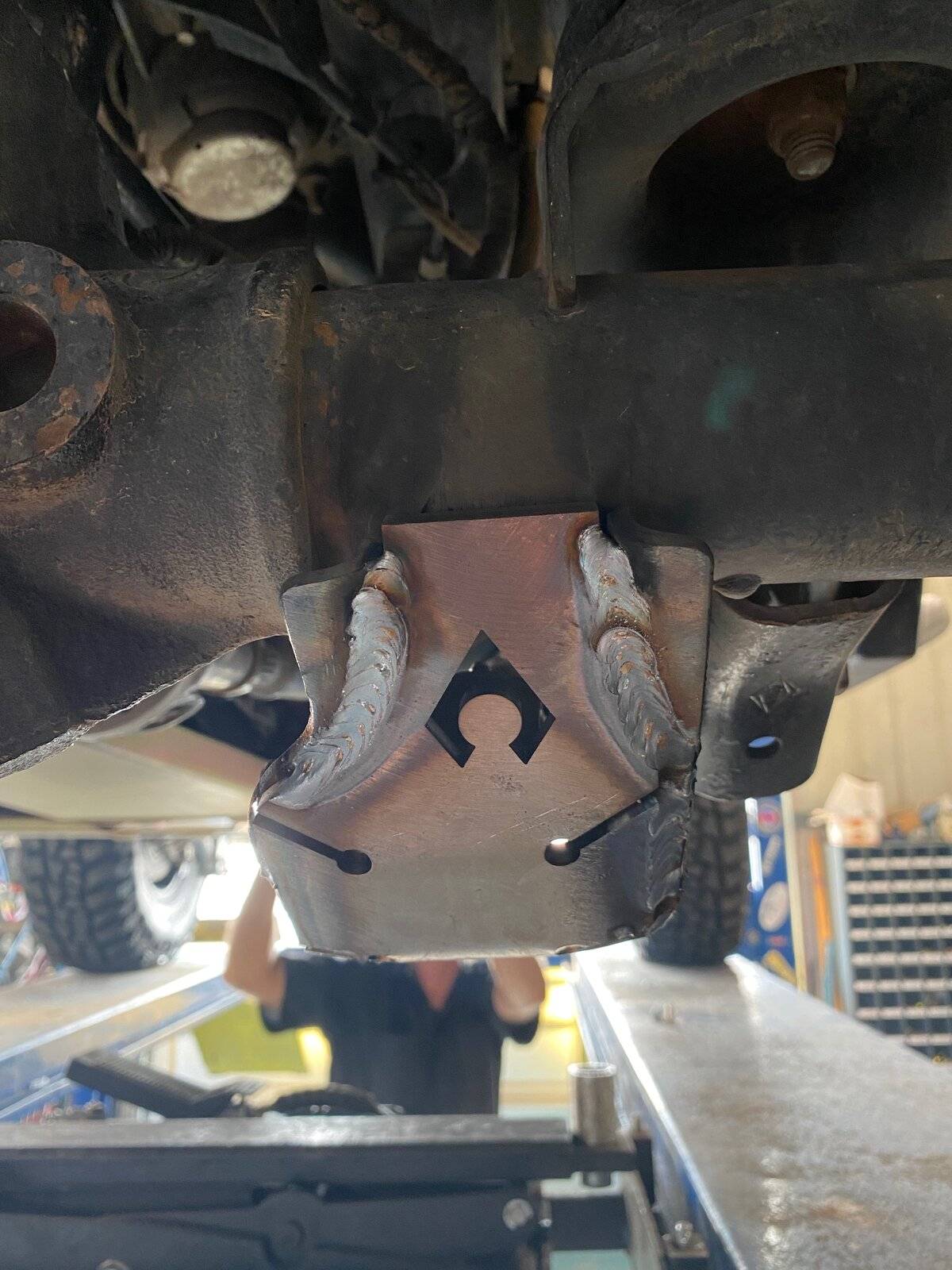

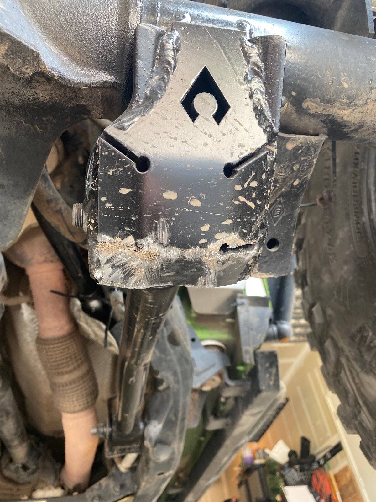

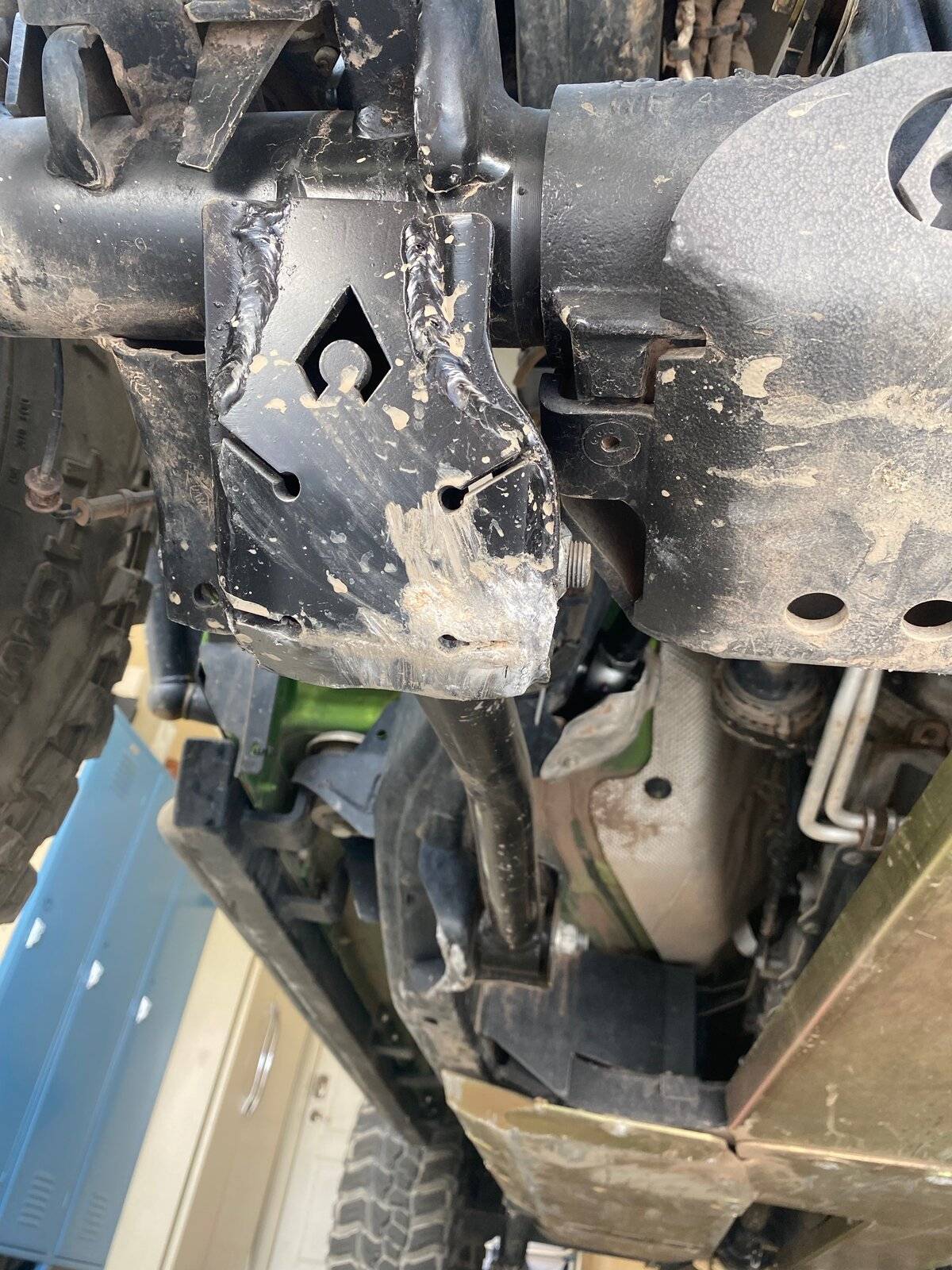

I have them installed and they are worth it. Had mine installed, since I don't weld, for $40 by a local fab shop. They were installed right before going on the Rubicon and I'm very glad I did. Both of the LCA skids took some hits and it was comforting knowing my mounts were getting trashed.

Personally, I’d not think twice about having someone else weld it up. Having just changed my LCAs, it makes me wonder how much harder any LCA adjustments will be with the skid in the way.
Also, there’s not a ton of room in the bracket. You may want to put a piece of stock in the bracket that’s the same size as the LCA just in case there is some warping from the heat.

The skids don't make adjustments any harder. My LCA's were bolted in while they were welded in. He made a lot of small welds, jumping around to different areas to keep from too much heat building up.
