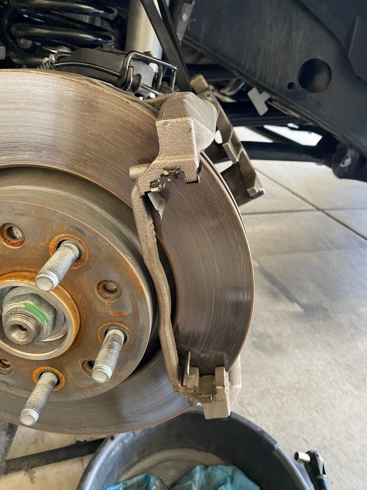

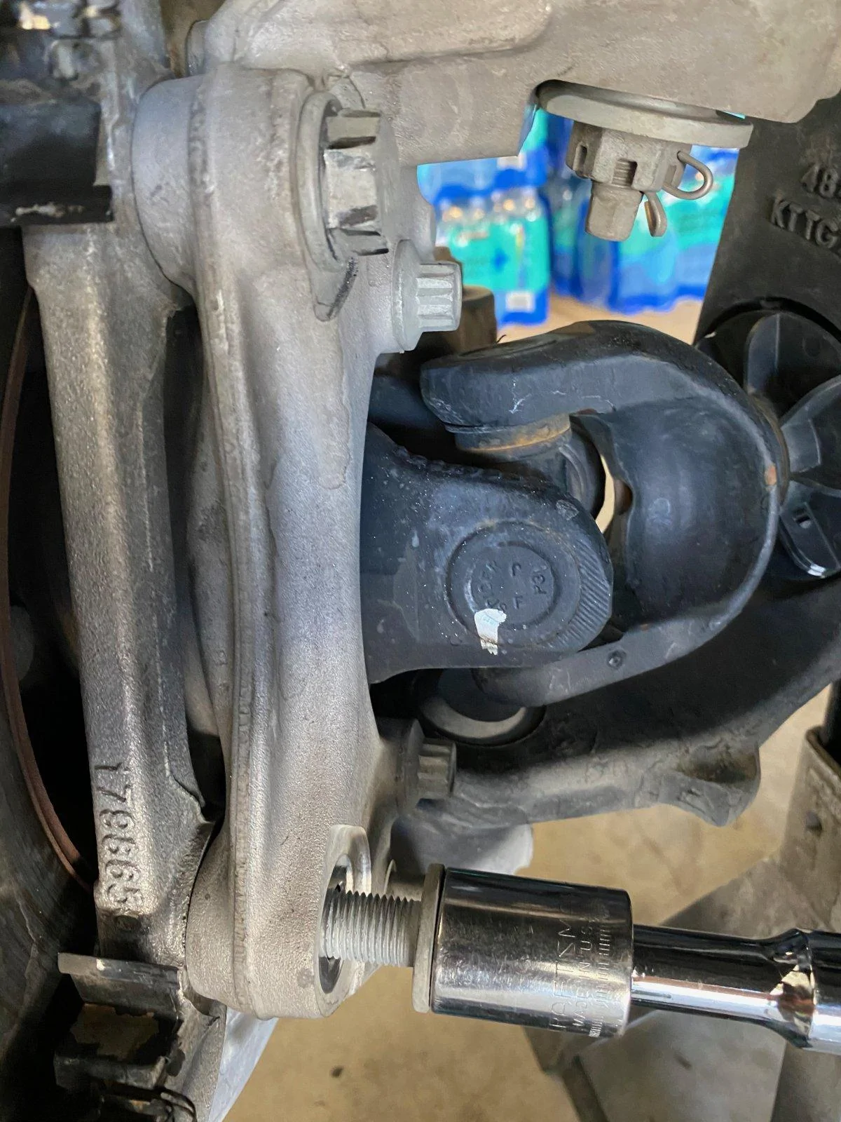

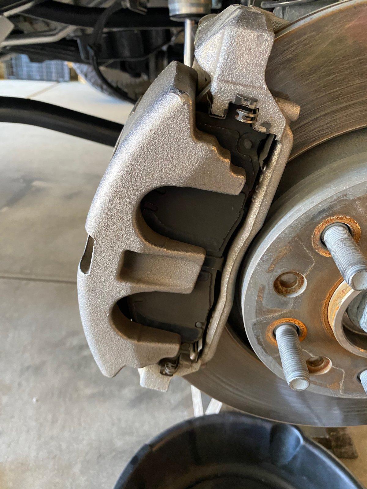

Here's some pics of the brake components, I think these are the fronts, but the rears are essentially the same. These are from a Rubicon. I believe Sahara's have the same brakes. I disassembled both my front and rears due to them squealing and found the clips and rear of the pads were bone dry. After lubing the correct places with Sil-Glyde, they've been quiet.

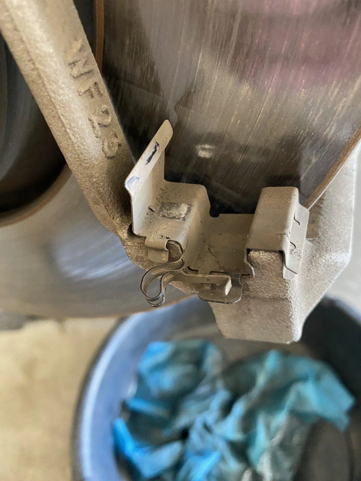

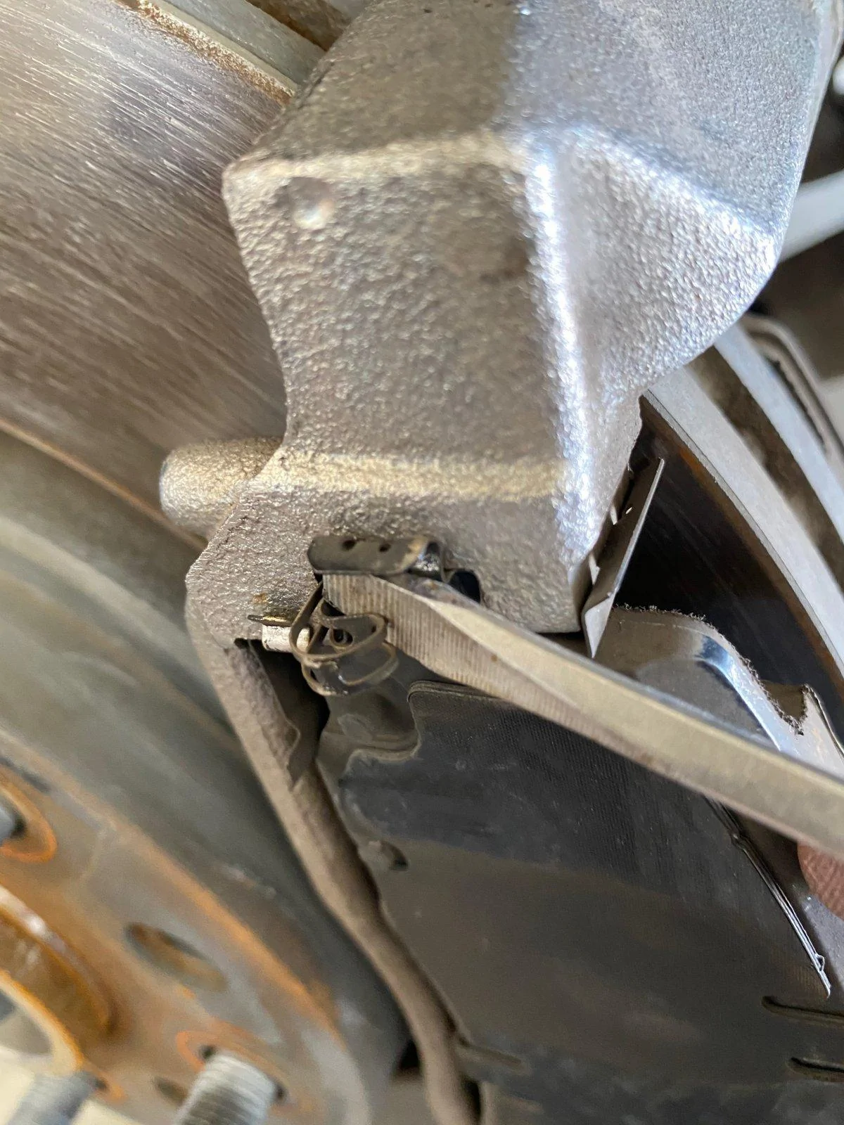

The brake system is pretty easy to work on. To get the pads out of the caliper bracket, theres a spring clip you have to pull back (as seen in the second photo with a screwdriver). There's a clip at the top and bottom of each pad, so 4 clips per bracket. It's easiest to pull the top and bottom clip outwards together, which forces the pad to come out. When you reassemble the pads into the bracket, you put the ends of the pad into the flat part of the clips and then push it in until it's seated. Make sure the round part of the clip is sitting back flush against the pads.
Hit me up if you have any questions......I'm pretty experienced with brakes. I'll be swapping my stock stuff out for the PowerStop Z36 pads and rotors in a couple of weeks.

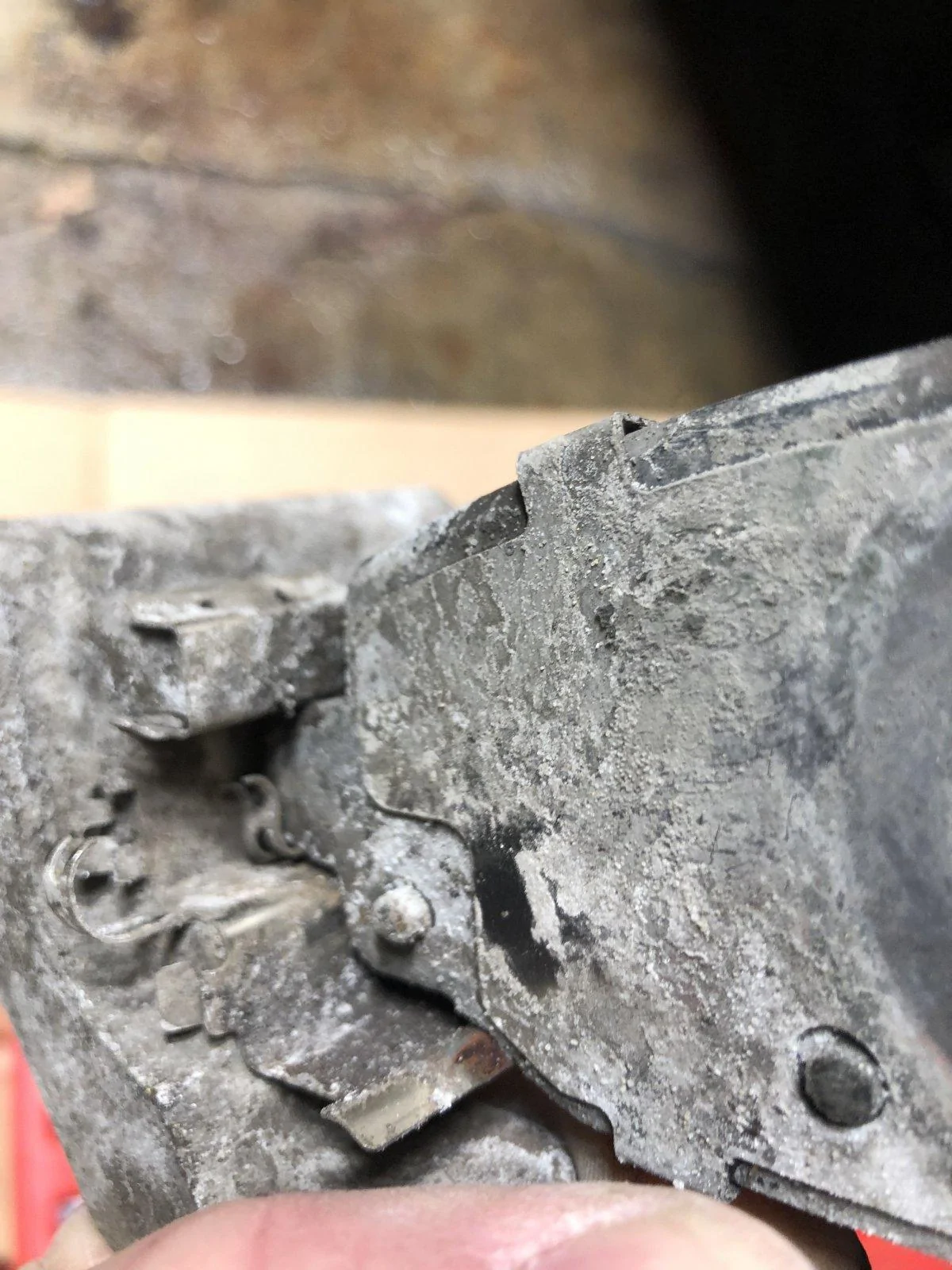

Here you can see the clips and hardware and dry. It appears there's some type of dry-lubricant coating on the hardware. It pretty much flaked off when I disassembled them.

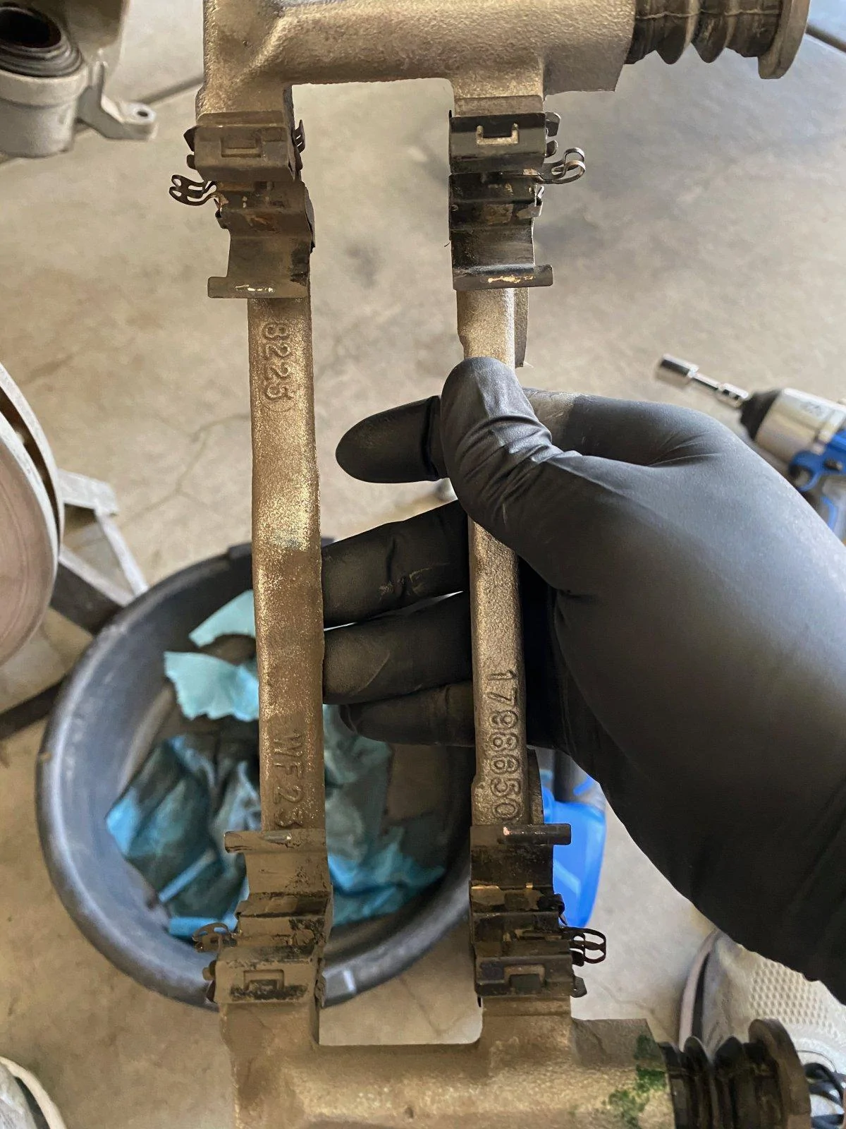

These two hex head bolts need to be removed to remove the caliper bracket.

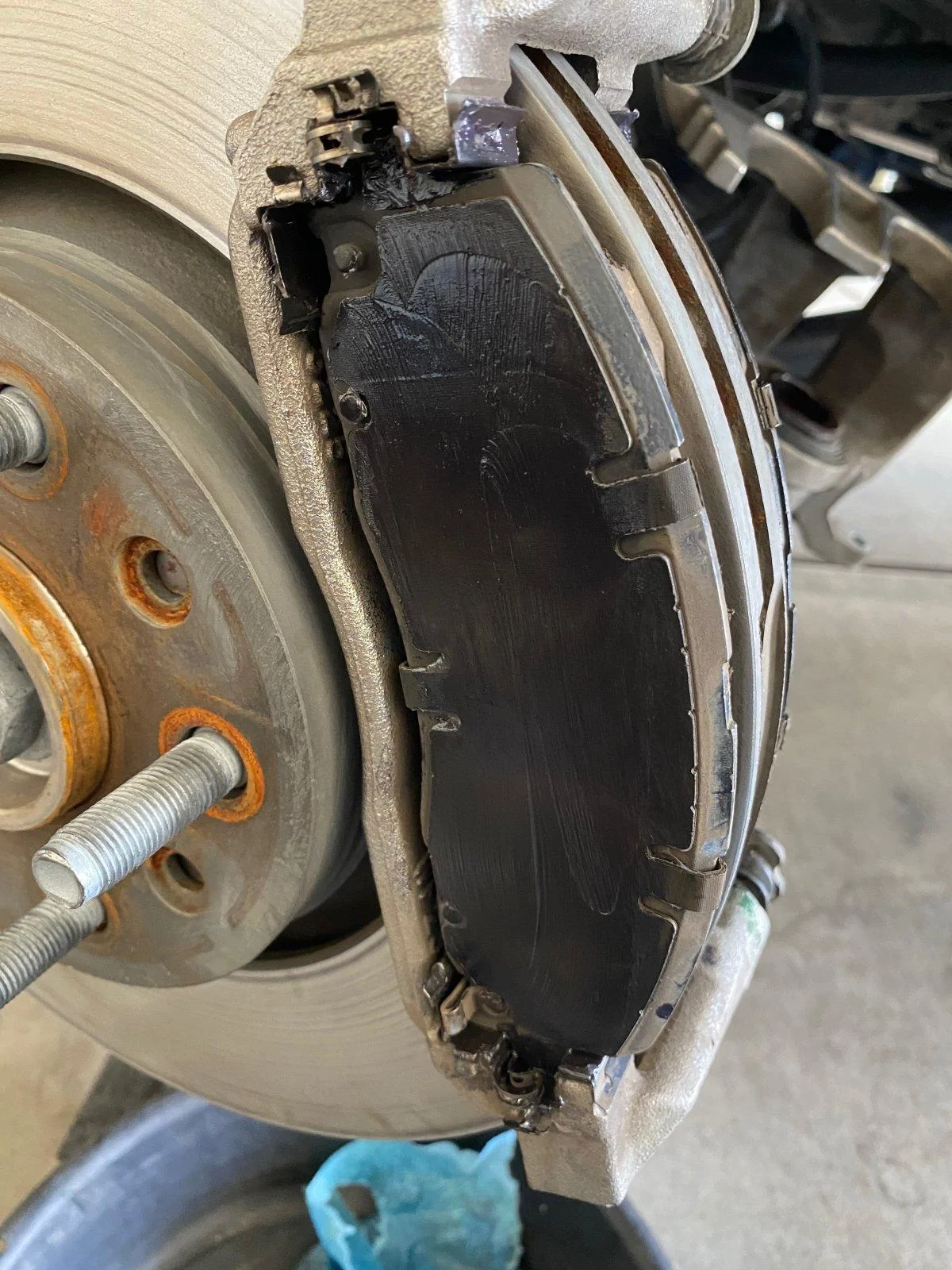

Everything is all lubricated properly.

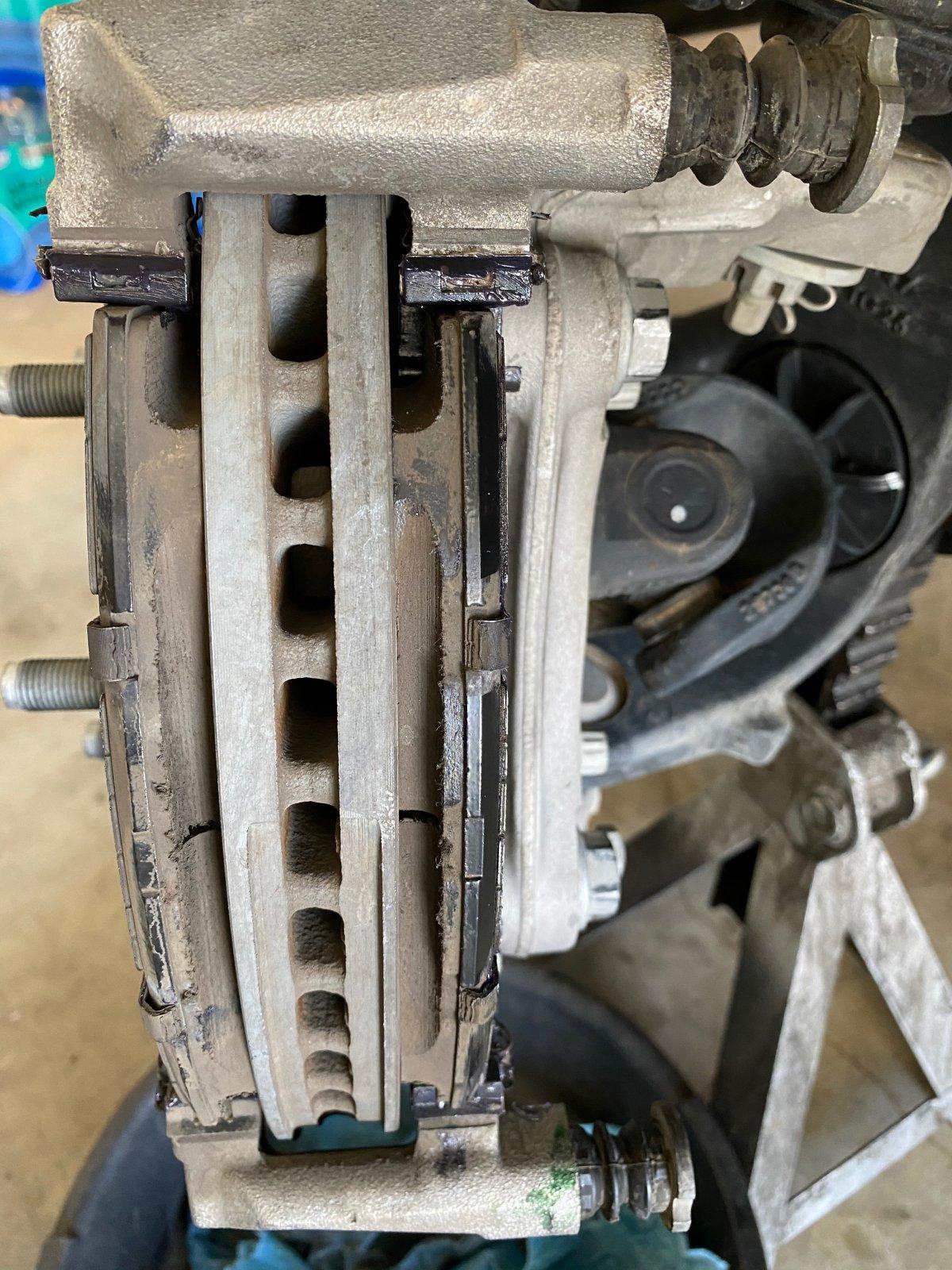

this happened to my power stop clips. All of them! I’ve had probably 4-5 power stops on different jeeps.

I’ve never had issues until this time. Only the inside clips broke. I’m ordering Mopar ones for my replacement kit power stop sent me today.

Power stop support is awesome! They sent me new set up. I ordered the mopar spring clips and I’ll be swapping them out in next two weeks. Only my inside spring clips broke. I’m not sure what could of caused that. I have put power stop on 4-5 other vehicles and I’ve never had an issues. And I will continue to use them.
