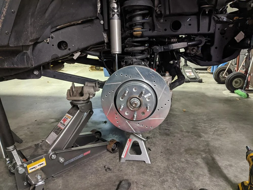

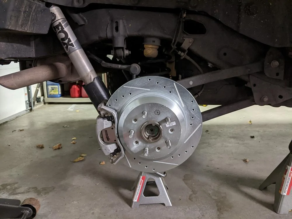

I installed the Powerstop Z36 kit a couple weeks ago and so far it's a solid product. I didn't really need new pads, but my front rotors keep warping and definitely needed replacement. I have no idea if this will solve the problem, but I paid $360 for the kit shipped and they were incredibly easy to install. I've got slightly better stopping power, but I'm not expecting much in that department with 37" KM3s.

Just to add on to what limeade said, you can remove the caliper bracket, but you don't have to. Just remove the 13mm bolts that hold the caliper to the bracket and wiggle the caliper off. Have a bucket of stool handy to set the caliper on, DO NOT let the caliper dangle from the brake line.
Just take pictures of how everything looks installed from the factory, and reference the pictures when you put the new stuff in.
For those who are doing the power stop z36 pads, you'll be a fan. Big difference in stopping power with our 39" KM3s, in fact wife just told me that she put them to good use after being cut off today.

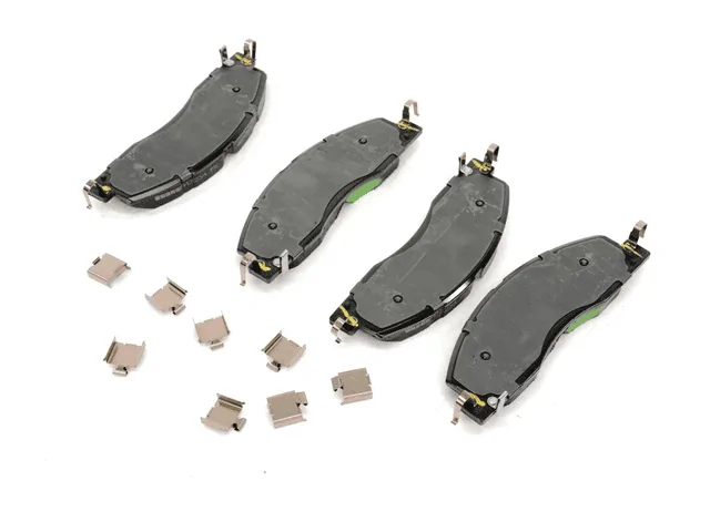

Every replacement disc brake pad kit I've ever done come with new clips. Not that it 'really' matters if they're still in good shape but I'd swap those with the pads.
