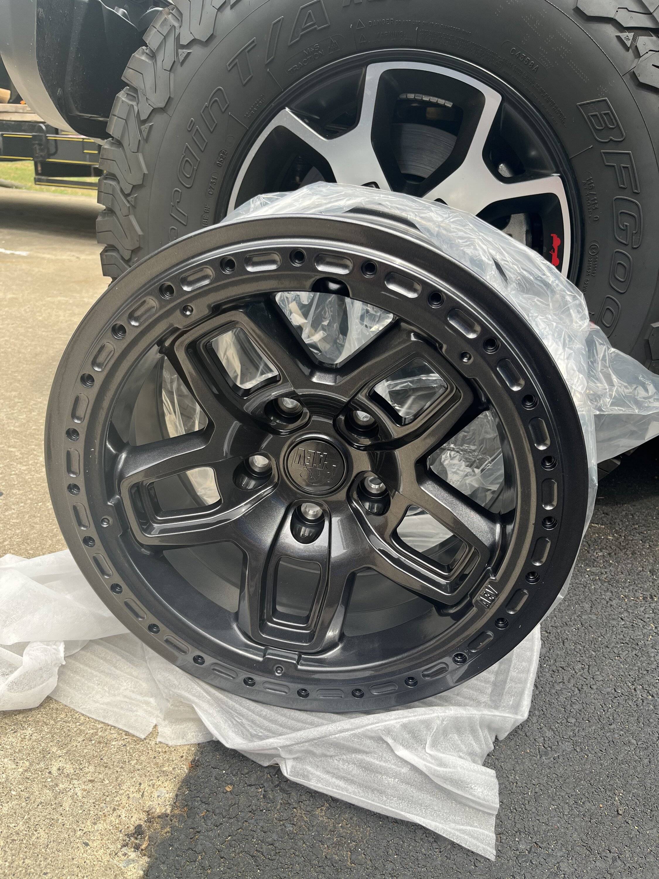

The AEV JK spec Pintler wheels have +10mm/5.2” backspacing and the JL are +25mm/5.72”….should I get the 5.2” or run the 5.7” with a 1.5-1.75” spacer? Concerned with rubbing on flex. Lift is 3.5” JKS Frankenstein of parts. Thanks
