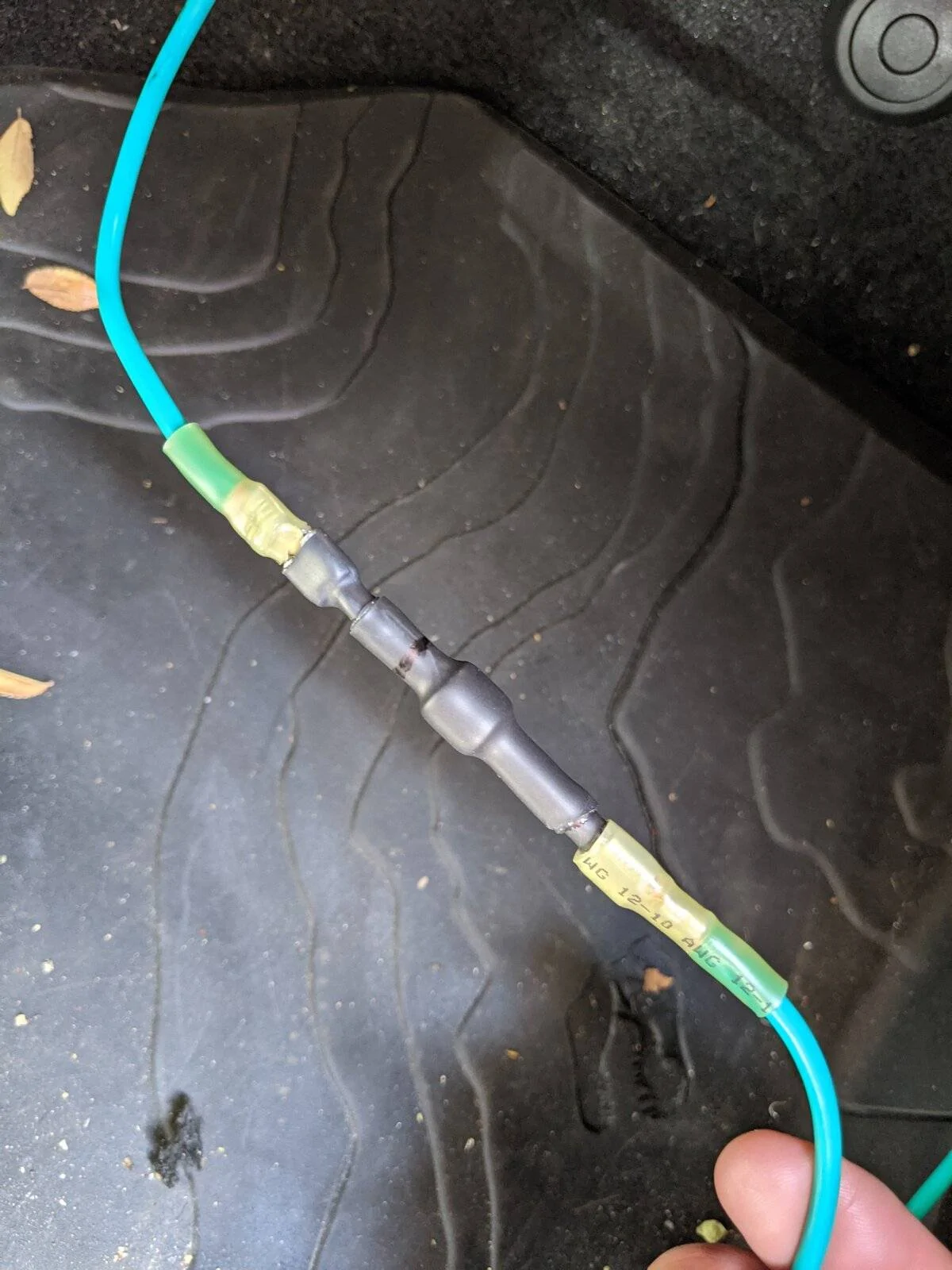

Added a diode into the brake sense cable

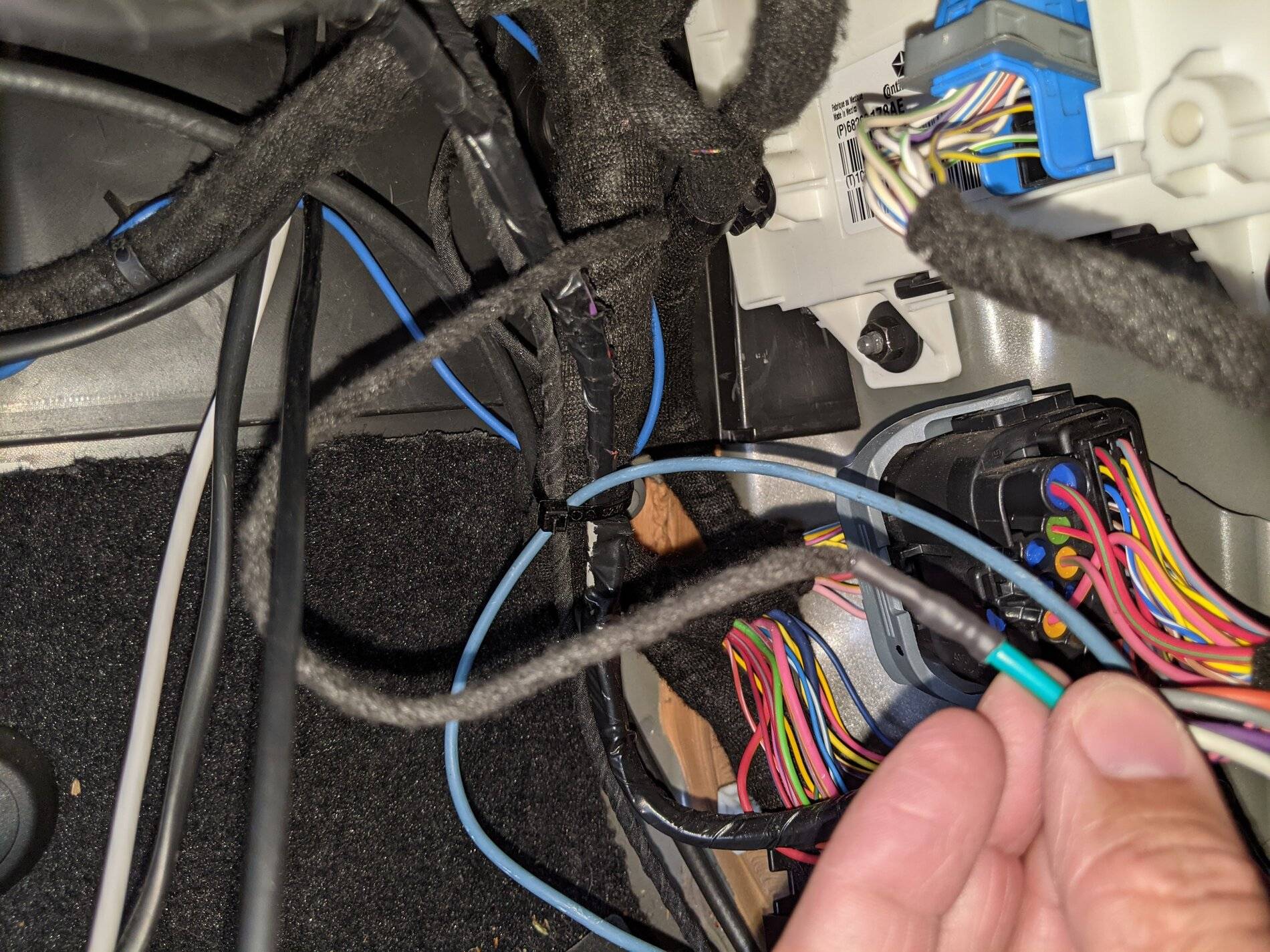

Brake Sense cable coming off the harness
