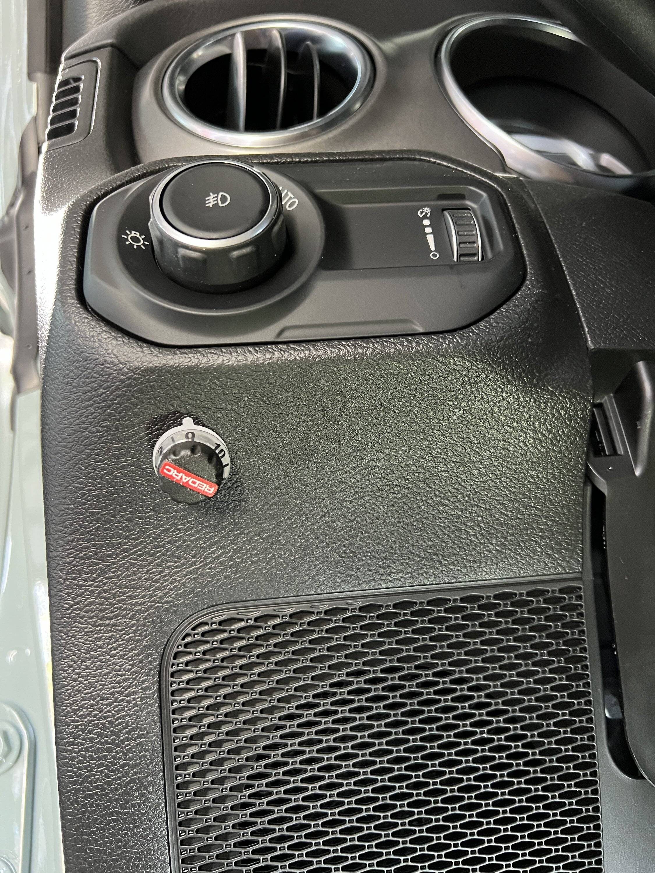

I made a mount from some plastic tube I found on amazon and attached it to the side of the console out of the way. I remember seeing a photo around here where someone mounted it right next to the 12V outlet, which I might try if I were doing it again.

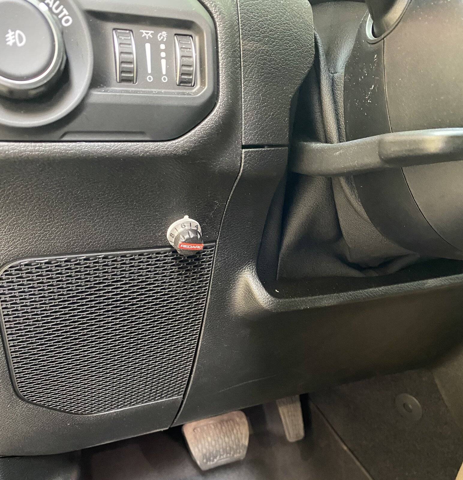

This is where I put mine …

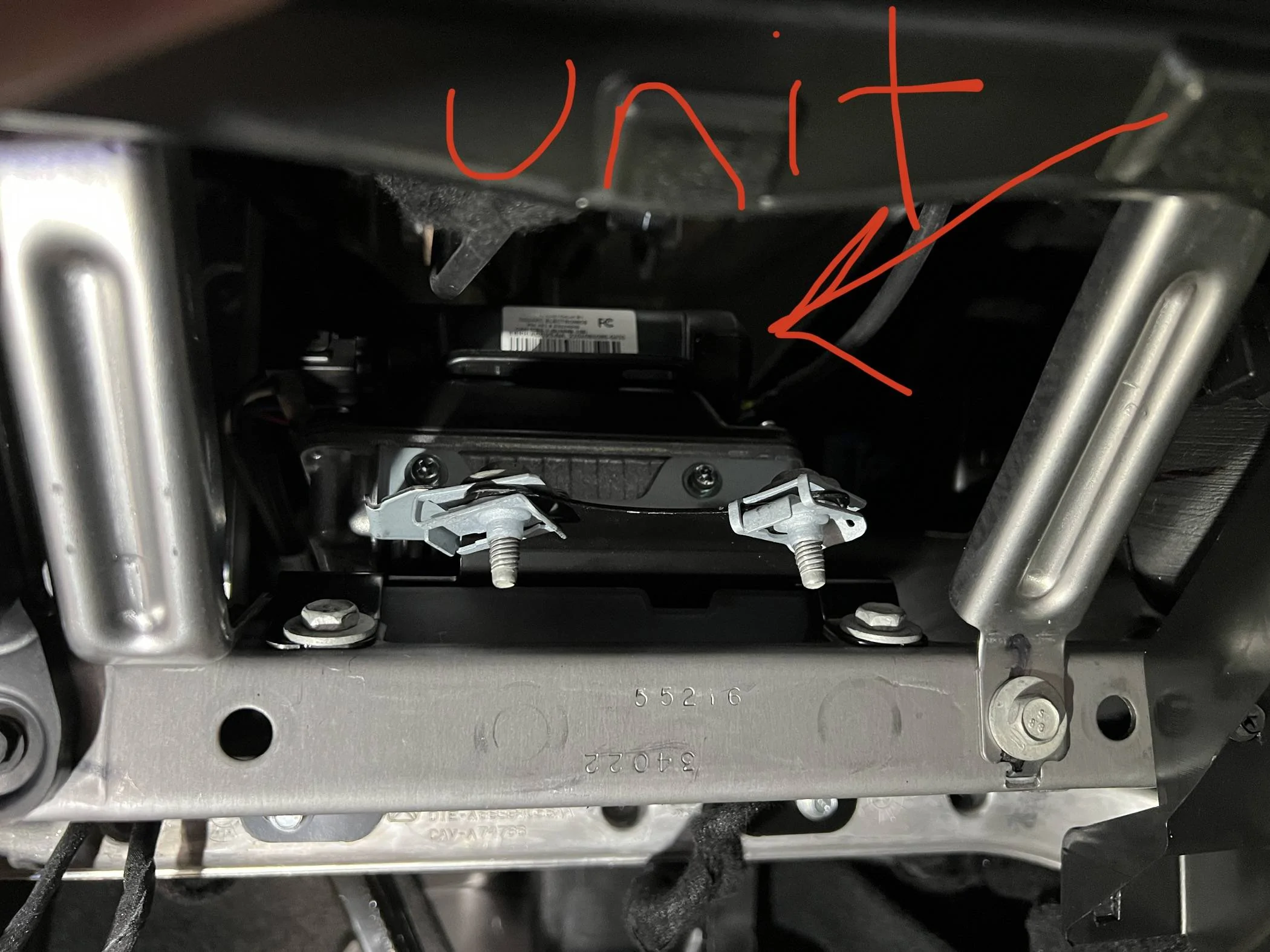

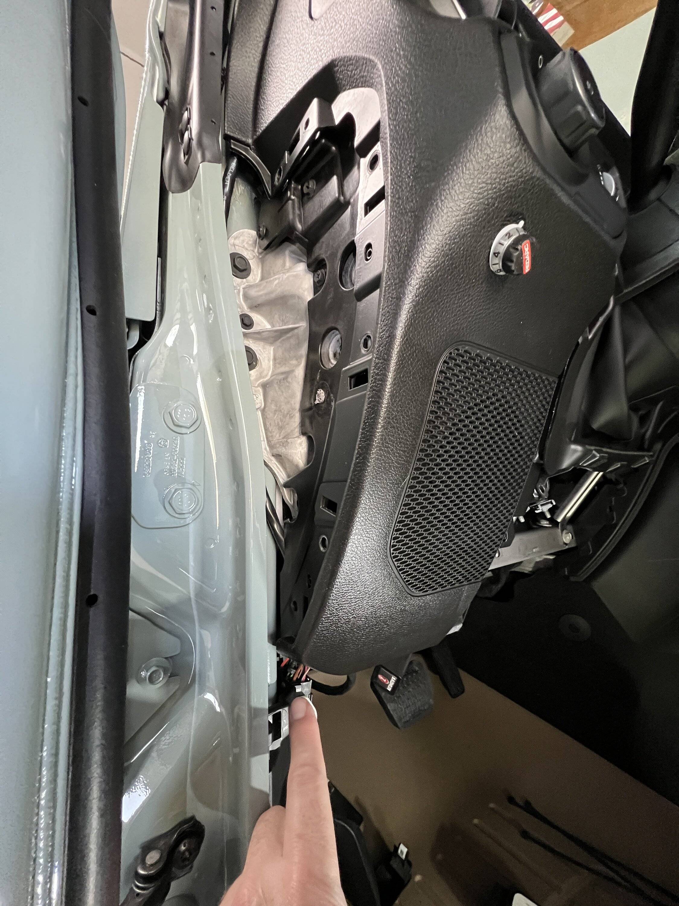

I did mine this weekend. You can see it perfectly sitting in the driver seat. It was 100% plug and play without a single splice.

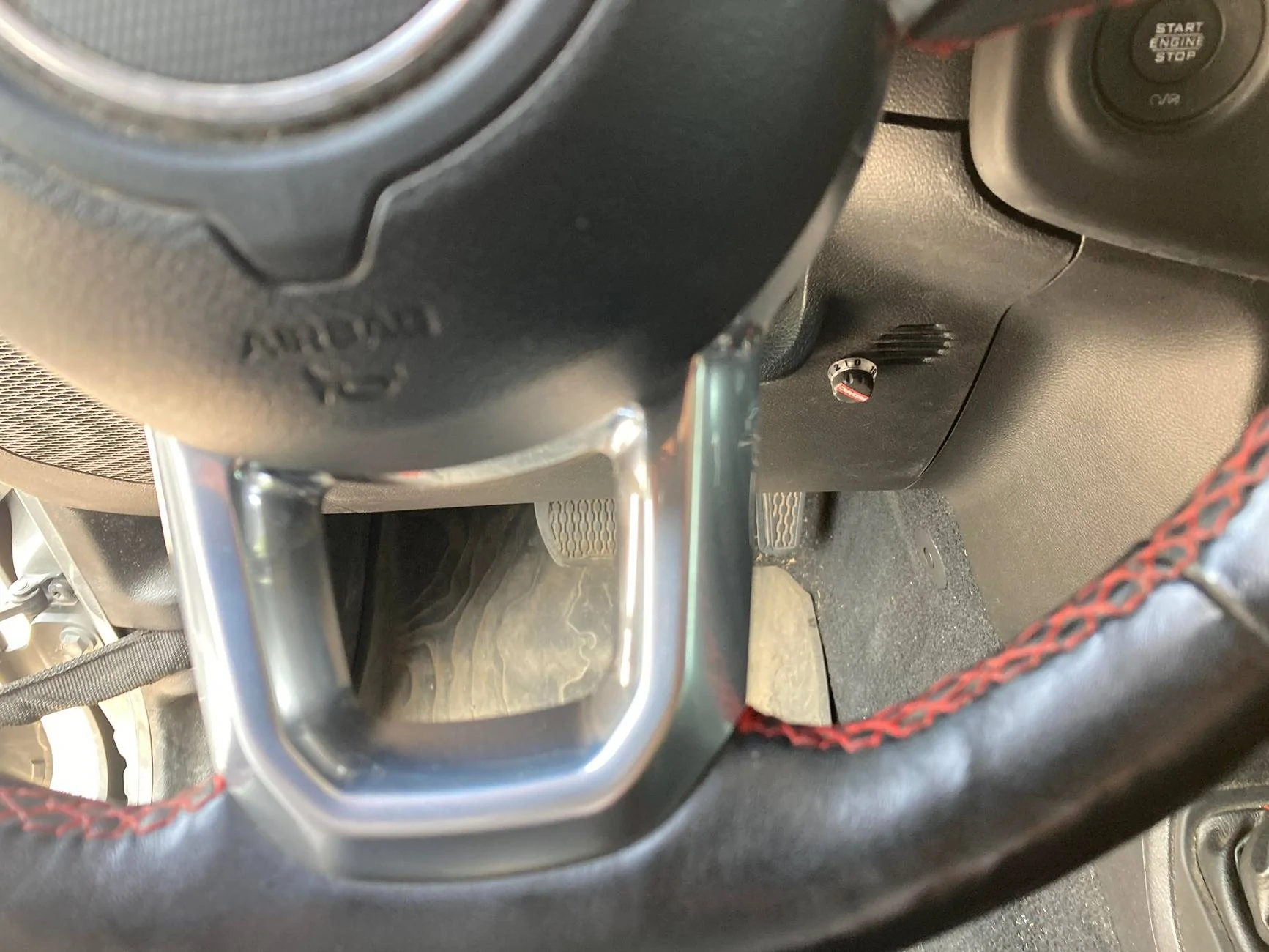

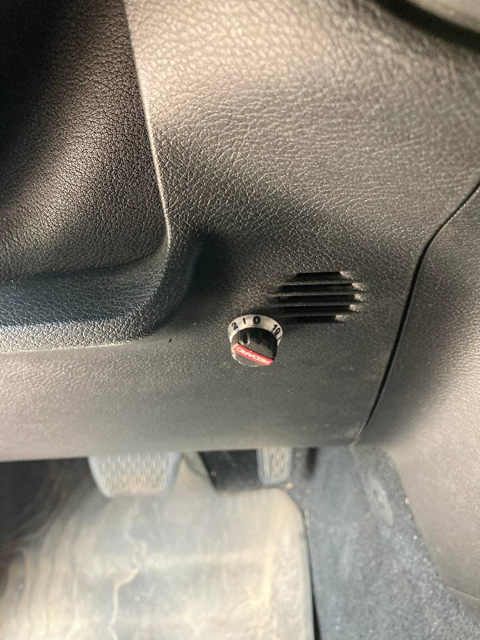

Just wanted to update this thread to show where I installed the controller switch. Very convenient location: can be seen through the steering wheel, only have to remove one panel. Minor trimming required on the inside of panel.

Just wanted to update this thread to show wear I installed the controller switch. Very convenient location: can be seen through the steering wheel, only have to remove one panel. Minor trimming required on the inside of panel.
Exactly where I put mine, and after a few years, it still feels like a natural placement second only to where the Mopar location is.
