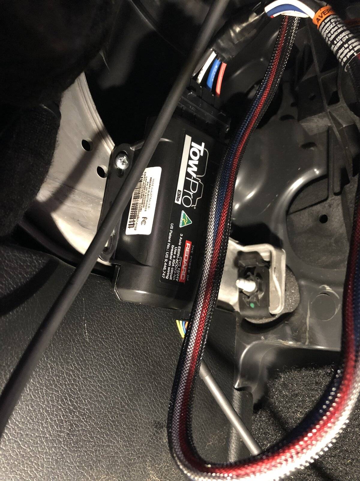

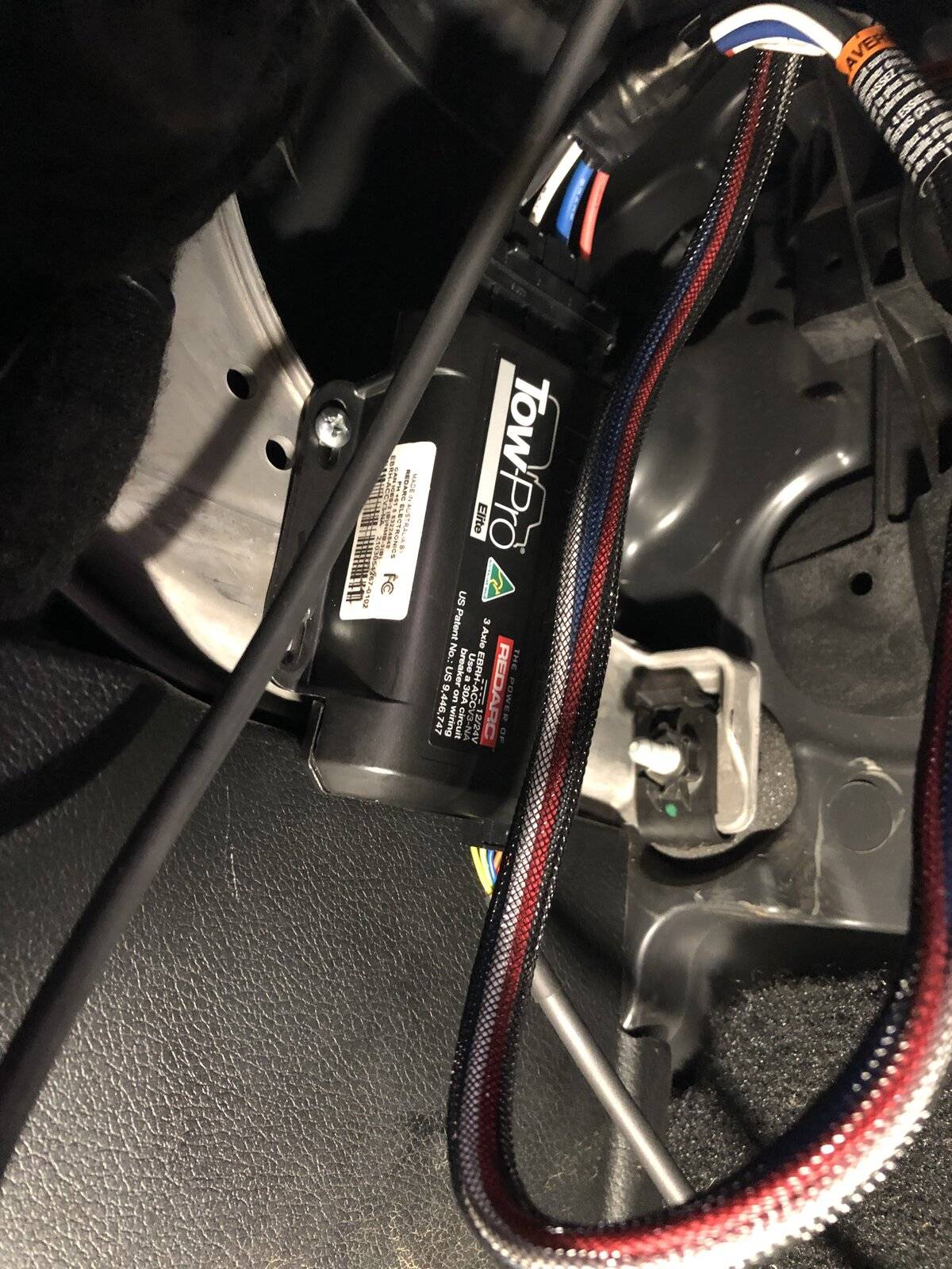

Figured I’d show folks what I came up with. Three 1/8th inch holes and some sheet metal screws worked like a charm. Attached to an aluminum plate under the drivers side dash left of the break pedal.

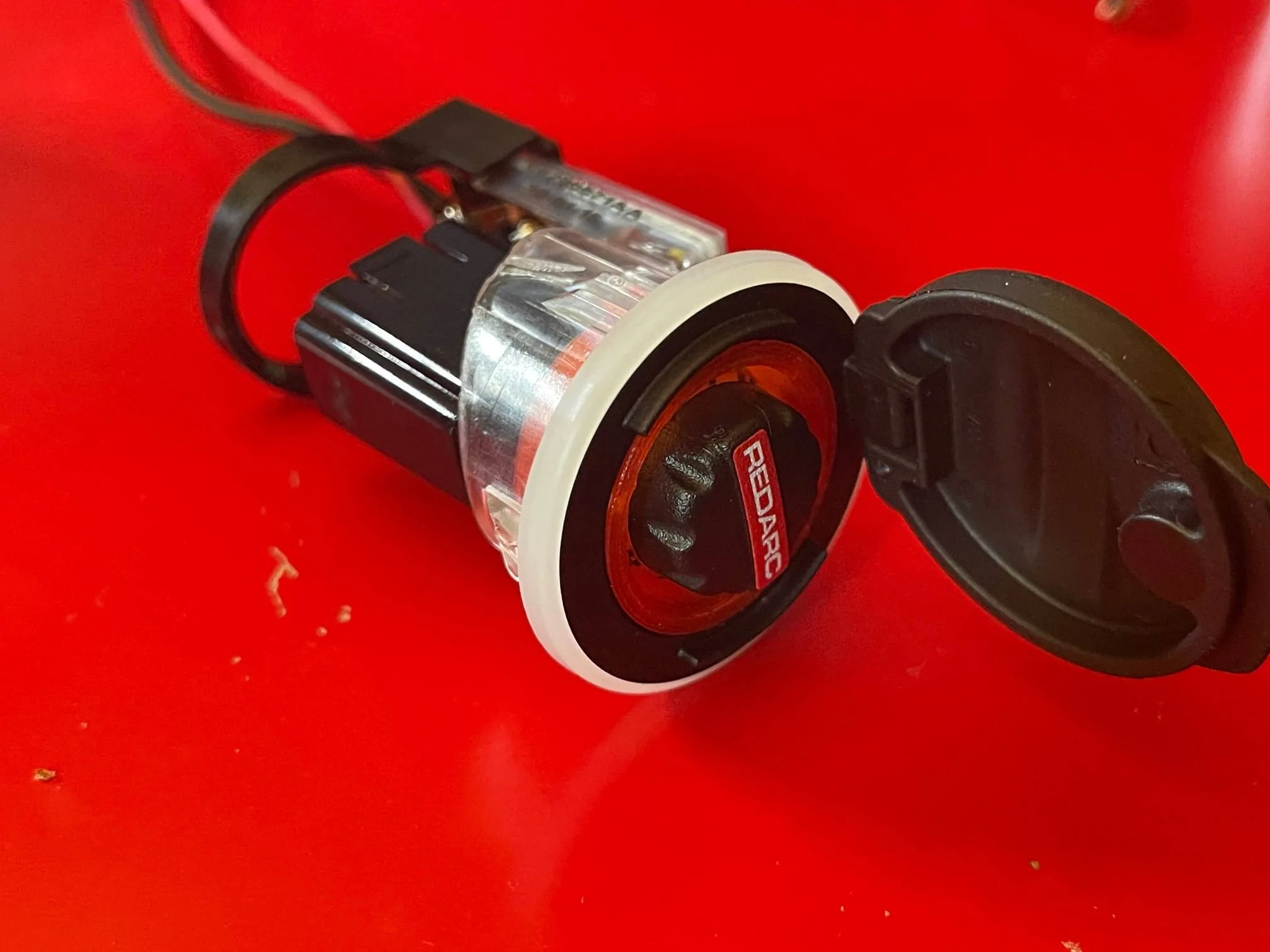

Jroever, the install looks great, how did you get the knob to go into the lighter hole?
jroever
Jens
Aug 21, 2020
CA
2020 JLUR

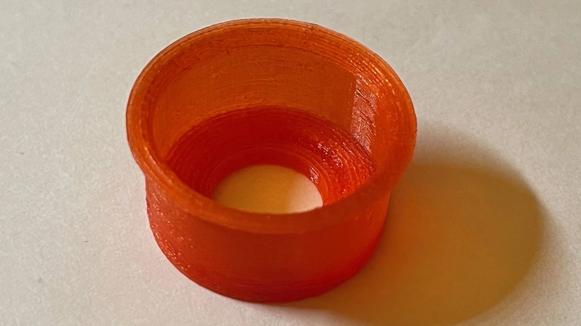

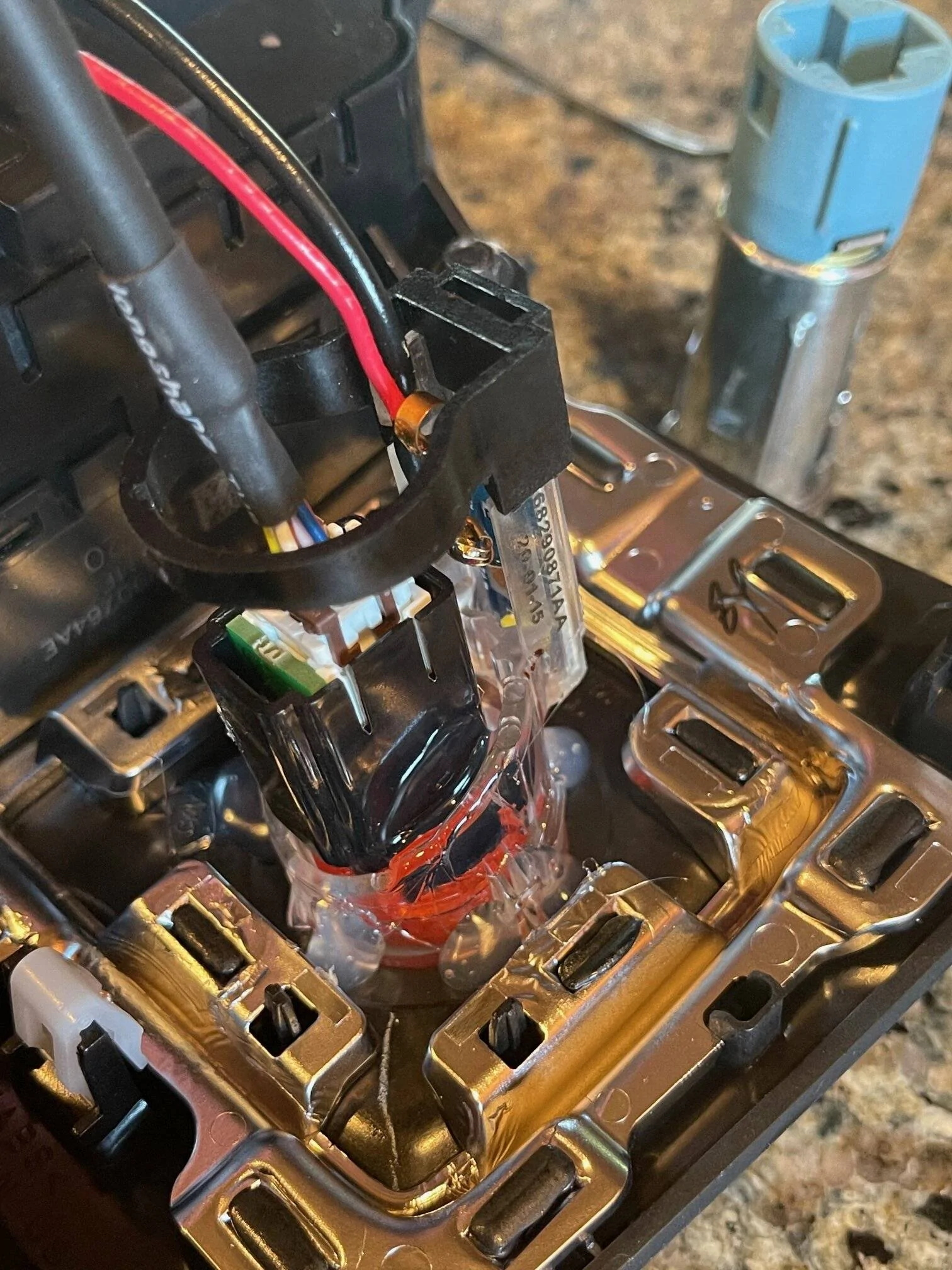

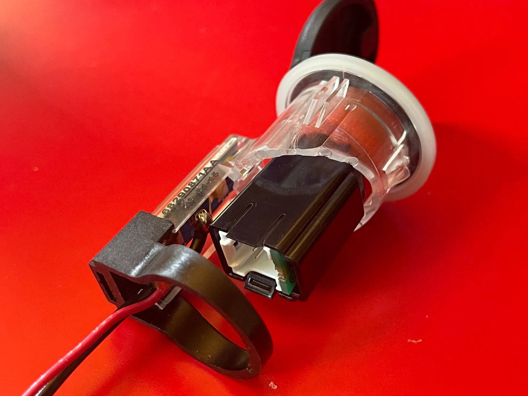

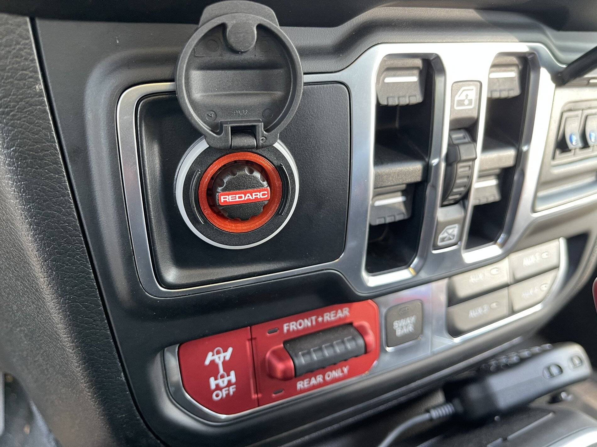

There are threads that describe how to get the lighter out - it's a bit tricky. There is a tool for this but if I remember it right I just stuck some small zip ties or screw drivers in to separate the pieces. After that I simply 3D printed this adapter and the knob fit in just perfect.
Jeep Wrangler JL Feedback on Redarc ToPro Elite trailer brake controller? IMG_4041
Only bummer is that the magnet in the cap has nothing metallic to snap to so you don't get that snappy self closing feel from the original.
Jeep Wrangler JL Feedback on Redarc ToPro Elite trailer brake controller? IMG_9330
Jeep Wrangler JL Feedback on Redarc ToPro Elite trailer brake controller? IMG_9331
Final assembly with classy hot glue to make it a bit more snug.
Jeep Wrangler JL Feedback on Redarc ToPro Elite trailer brake controller? IMG_9335
PM me if you want the 3D print file and I'll dig it up.
