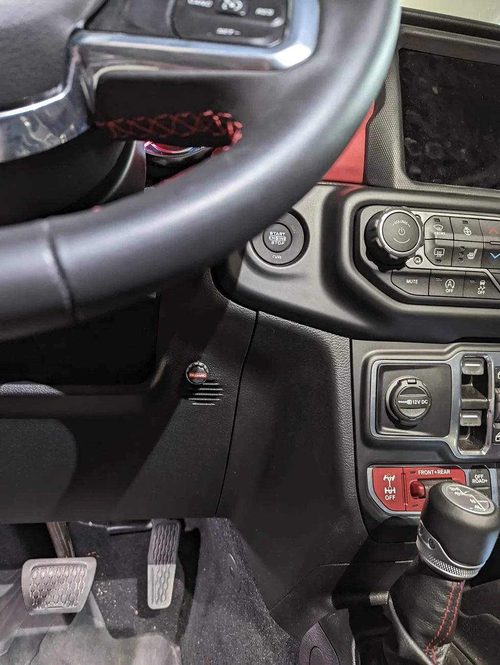

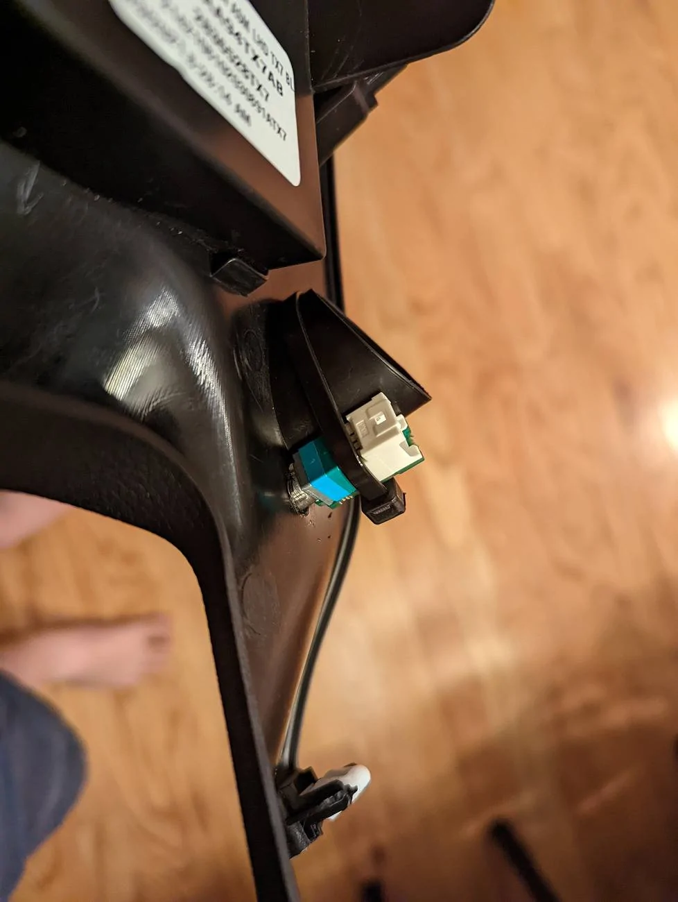

Just received my Redarc controller. I like your install location but after pulling my panel it looks like a tight fit. Were you concerned with the switch fitting behind the panel? TYIA

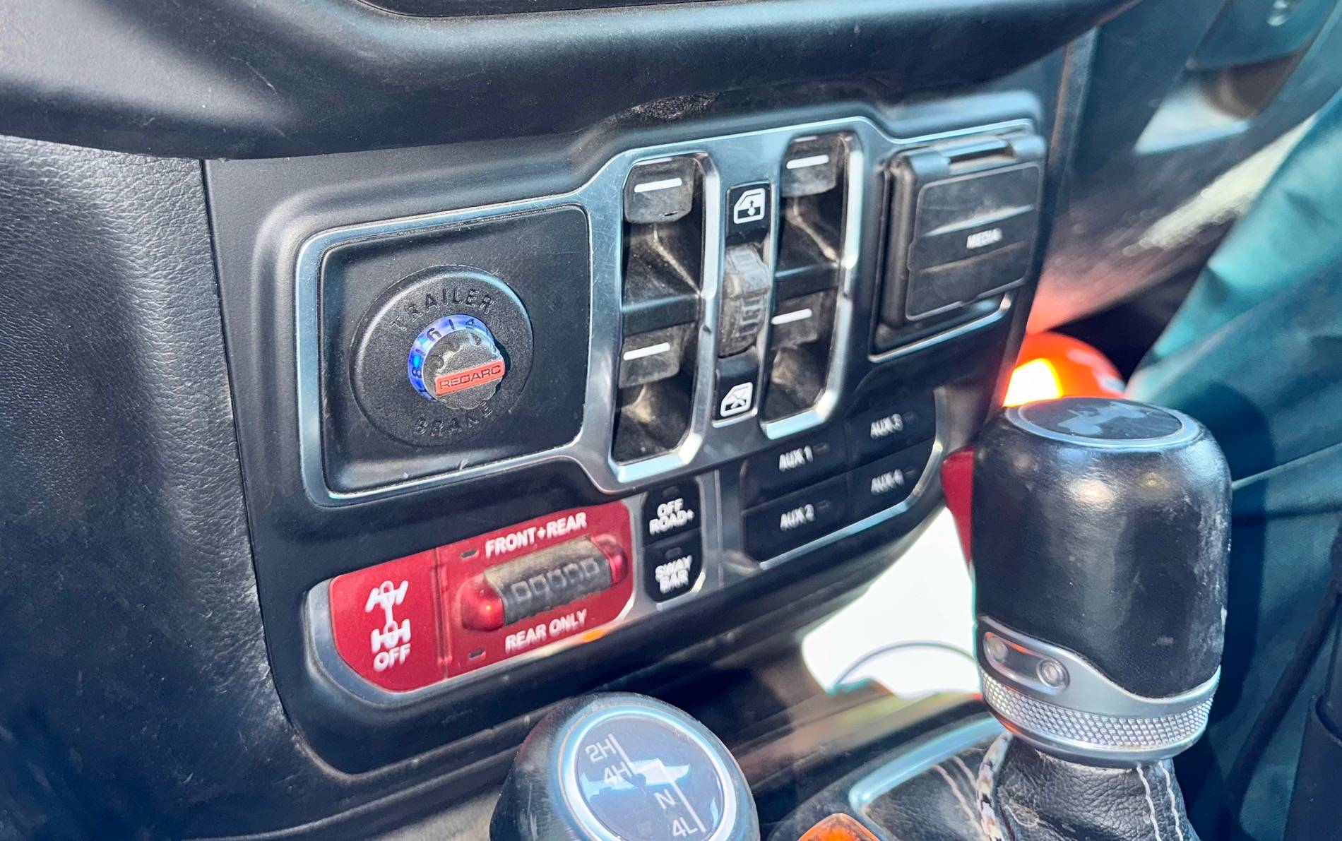

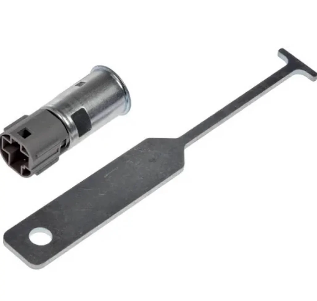

If you're not set on keeping the 12V socket, the Redarc knob fits there very nicely. I followed the video on the Redarc website, it was actually pretty easy (with a special $9 tool for pulling the 12v socket). Most of the work for me resulted from my not having a factory tow package...

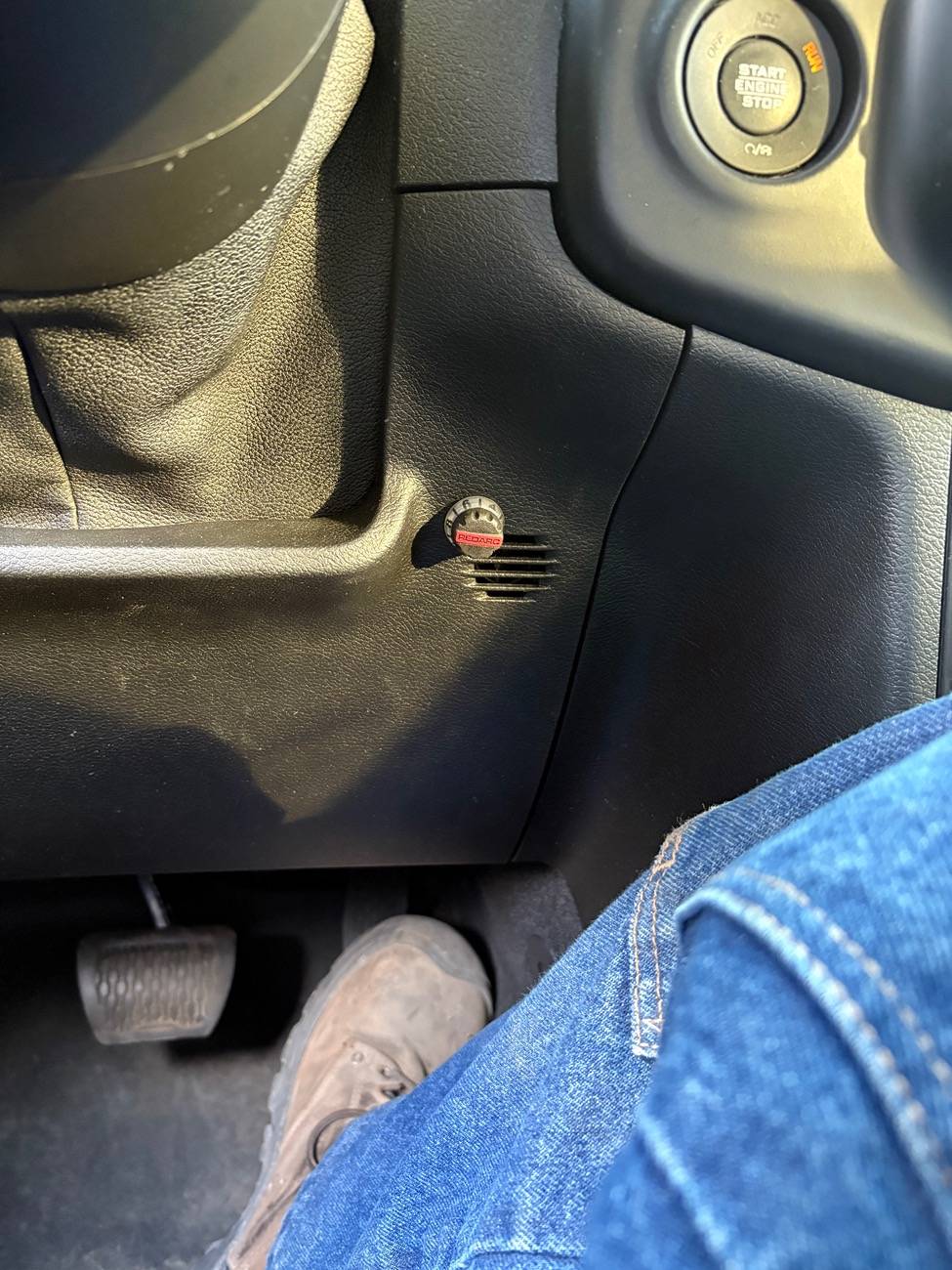

Actually was looking to use the same location as @driventoadventure used and it seemed there may be some clearance issues and there were. Slight trim of some unnecessary plastic and whalla it’s done. His location was perfect for a 15 minute install.
Thanks for the reply.
🇺🇸B
edit/ps : I don’t use the 12v socket and I’m sure that’s a real clean look but to take all that apart when it wasn’t needed…. 👍🏼
edit 2 : Photo added of completed install and evening beverage 🤪

Bro, so sorry that I didn't get to you sooner... I didn't have any clearance issues, because I didn't install the black shroud - I literally zip-tied the knob PCB to the channel for that speaker pod (or whatever it is.)
