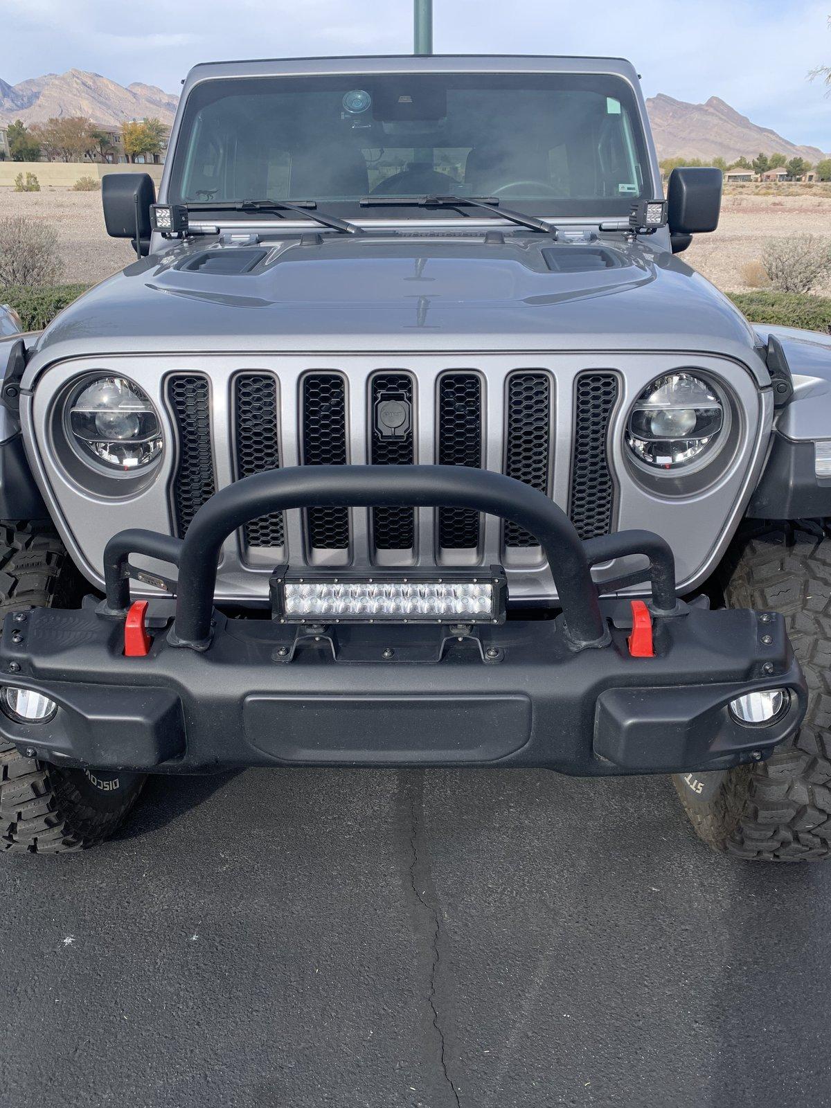

Finally installed my Bolt hood lock this morning. Started at 9am and was washing my hands shortly before 10am. Very simple install process and it works as expected. I reused all of the existing hardware.
The only delay was going to Harbor Freight to purchased the riveting tool.
Is it the camera angle, or does the grill piece provided not match the original grill piece and remaining grill pieces?
It matches perfectly. What you’re seeing is the new, un-faded Bolt panel next to the slightly faded OEM panels. Some Armor All or some similar product on the OEM sections would help until the Bolt section weathers a bit.
Awesome. Thank you!
