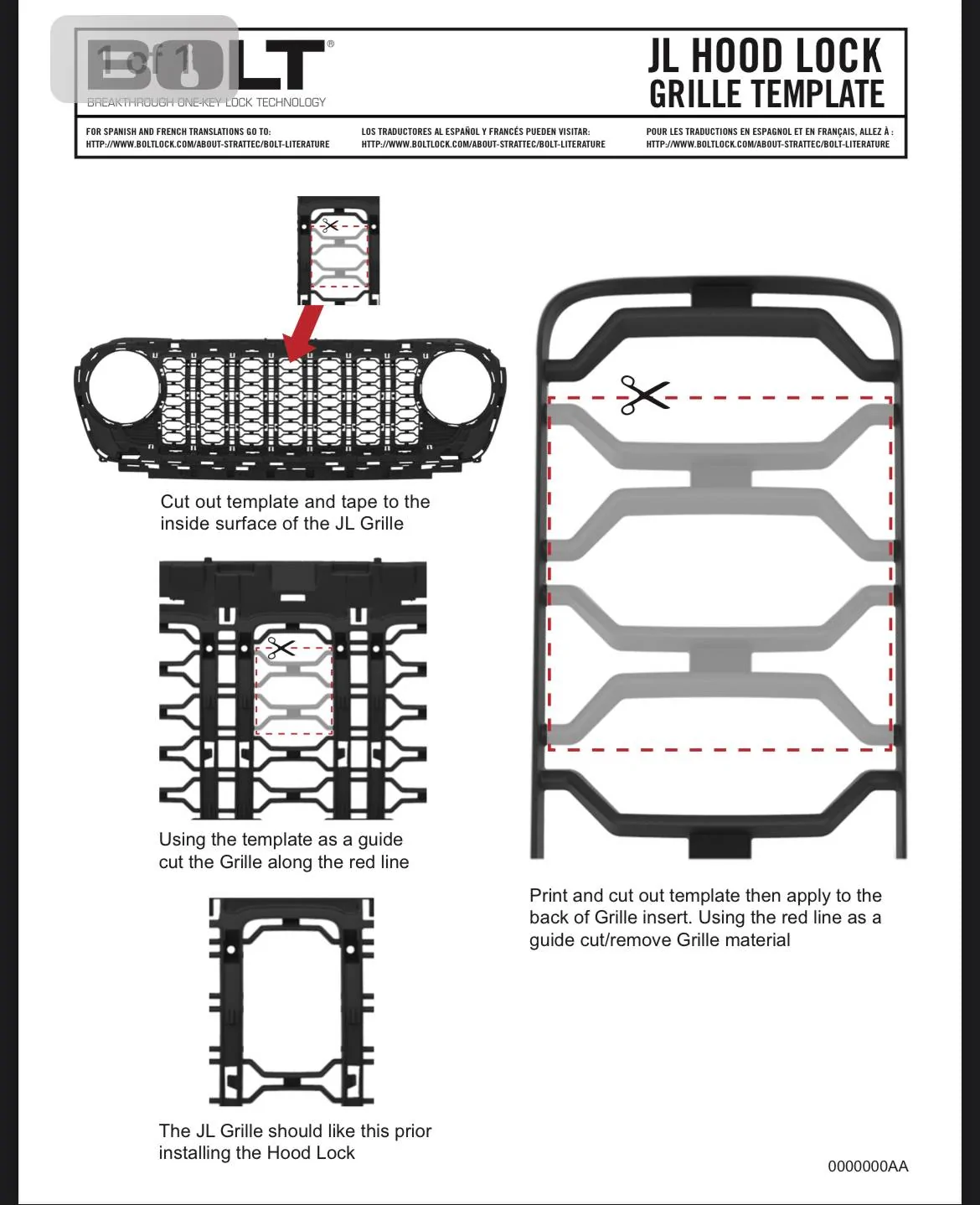

Hi. On various pages it says it fits with the new grill but I also read that bolt sends a template and you have to cut the grill? I don’t want to do that to be honest

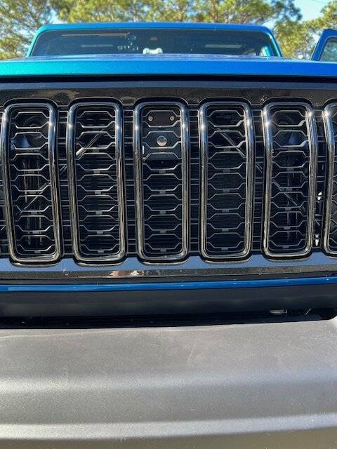

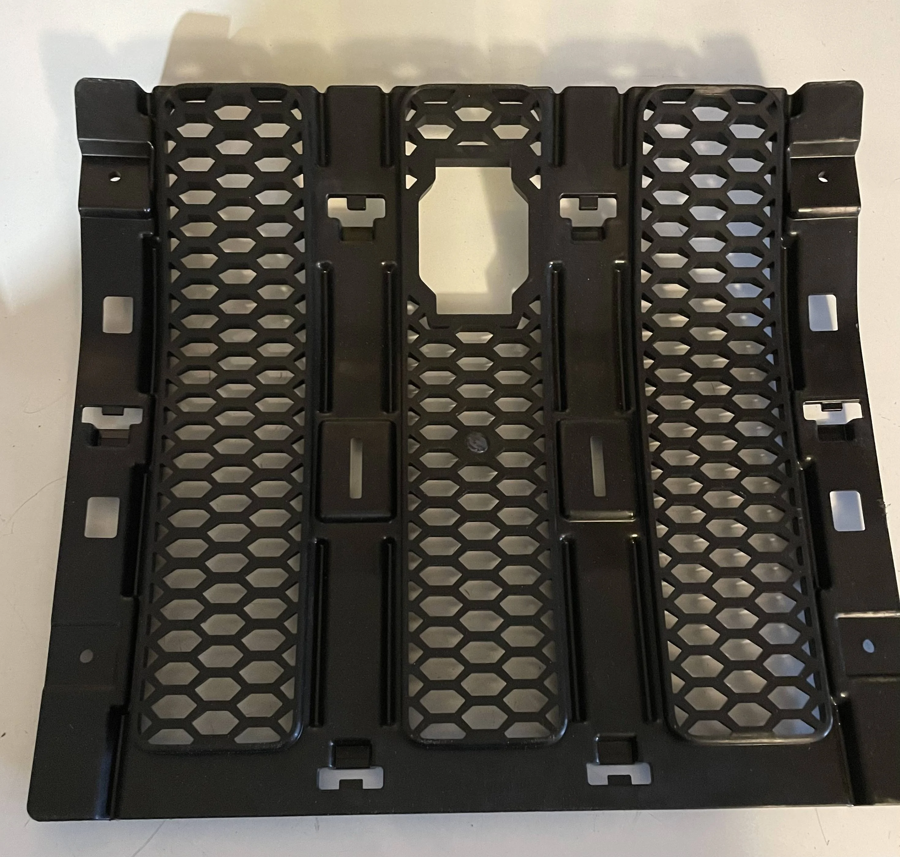

I ended up cutting mine. Used a fine tooth hack saw blade. Left minimal “scuff” marks where the plastic was cut. Is it ideal, no, but I like the hood being locked more than I hated cutting the grille. The template provided won’t fit the 24 grille. I did buy on Amazon so I’m not sure if anything has been updated.

I am not sure if I can do that …. Urrrg ? just because I am not super handy. I figured i can follow you tube to install, but I assumed it simply fits (no modification needed)

The plastic was surprisingly easy to cut. And they supply a template to follow. I used a similar handle with the hacksaw, give you a little more control. If you’re capable of riveting the bolt lock on cutting the grille will be easy. Just take your time. ??

@Jackiemohro If you have a Dremel tool, using that with a plastic cutting wheel is also a good option for cutting out a portion of the grille insert. For me, if I had to use a hack saw, even a small one, I would be hesitant at trying to cut the grille insert.

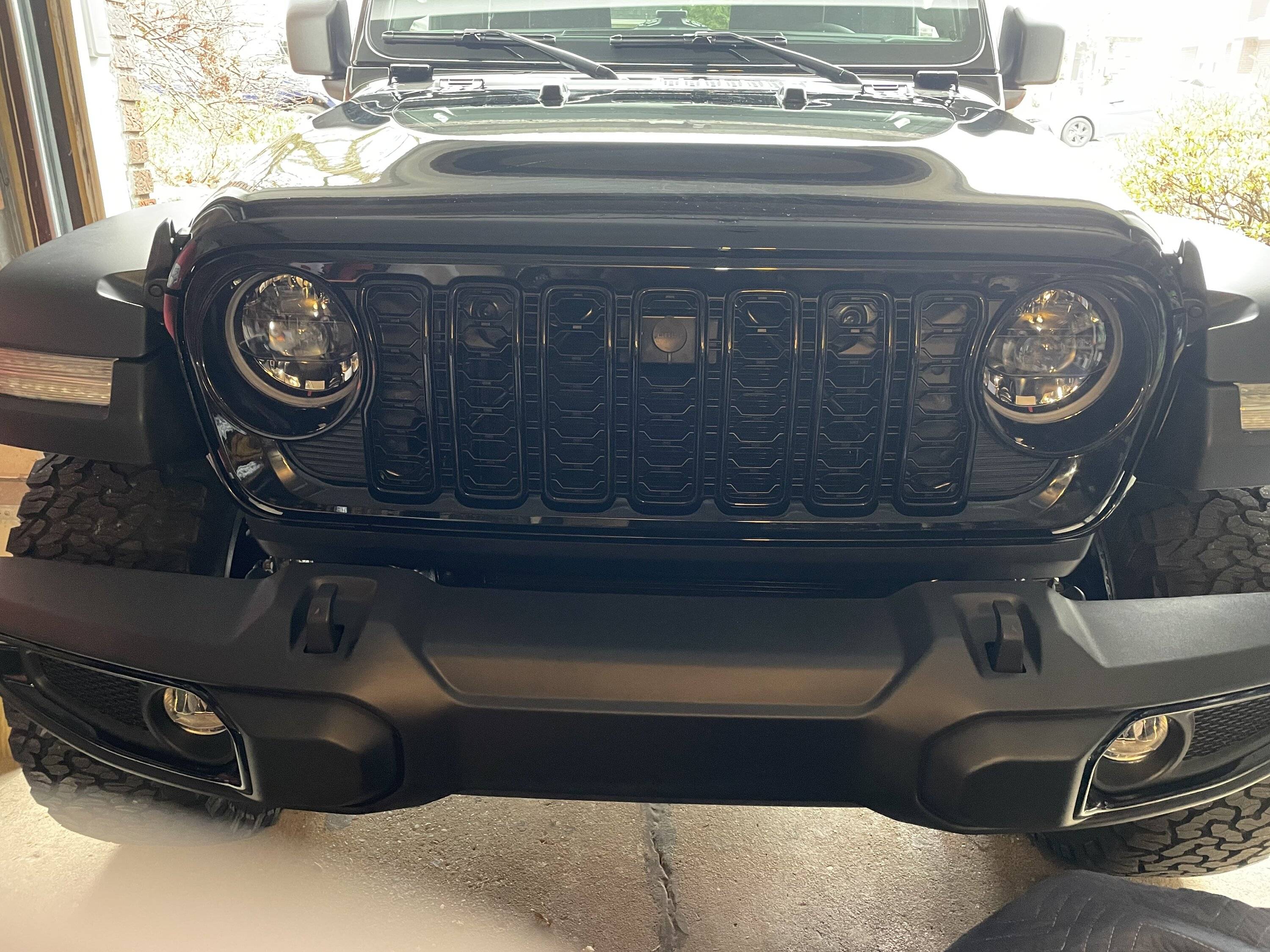

I tried the Lasfit and it did not work, the under dash bracket is not compatible with the 2024. I also could not bring myself to cut my grill, which eliminated the Bolt! I ended up getting one of the knock-offs from Amazon.
https://www.amazon.com/JoyTutus-Ant...-1-spons&sp_csd=d2lkZ2V0TmFtZT1zcF9hdGY&psc=1
It has it's own key that is almost 4" long, but it works and I lock the key in the glove box. No cutting was required, the key fits right through one of the openings and right into the tumbler!
Probably not the same quality as the Bolt model, but still a deterrant to the casual thief!
Note, I do attach that huge key to the key ring for my huge key fob when leaving it anywhere for service so it doesn't get lost, and I also provide instructions on how to get under the hood.
This has worked well for me thus far.

If it helps, here is a picture of the Amazon one installed on my 2024 Willys:
Jeep Wrangler JL Bolt Hood lock for JL2024? IMG_3889
Jeep Wrangler JL Bolt Hood lock for JL2024? IMG_3890
Hindsight being what it is, I probably should have painted the lock cylinder and the two bolts black so they wouldn't show like the silver does!
