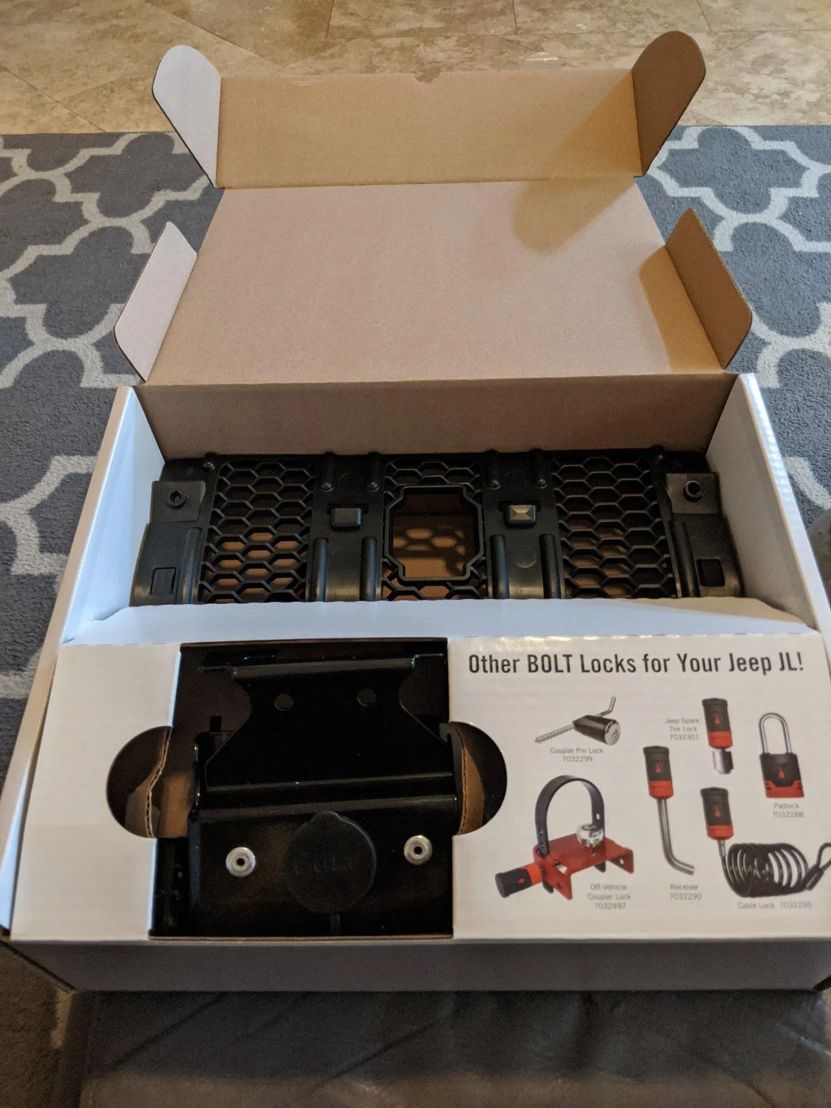

after waiting 6 months for mine, it's still sitting in the box... now I'm waiting for the 1/4" rivet gun i ordered to install it
Luckily I already had a rivet gun from previous JK hood lock install.

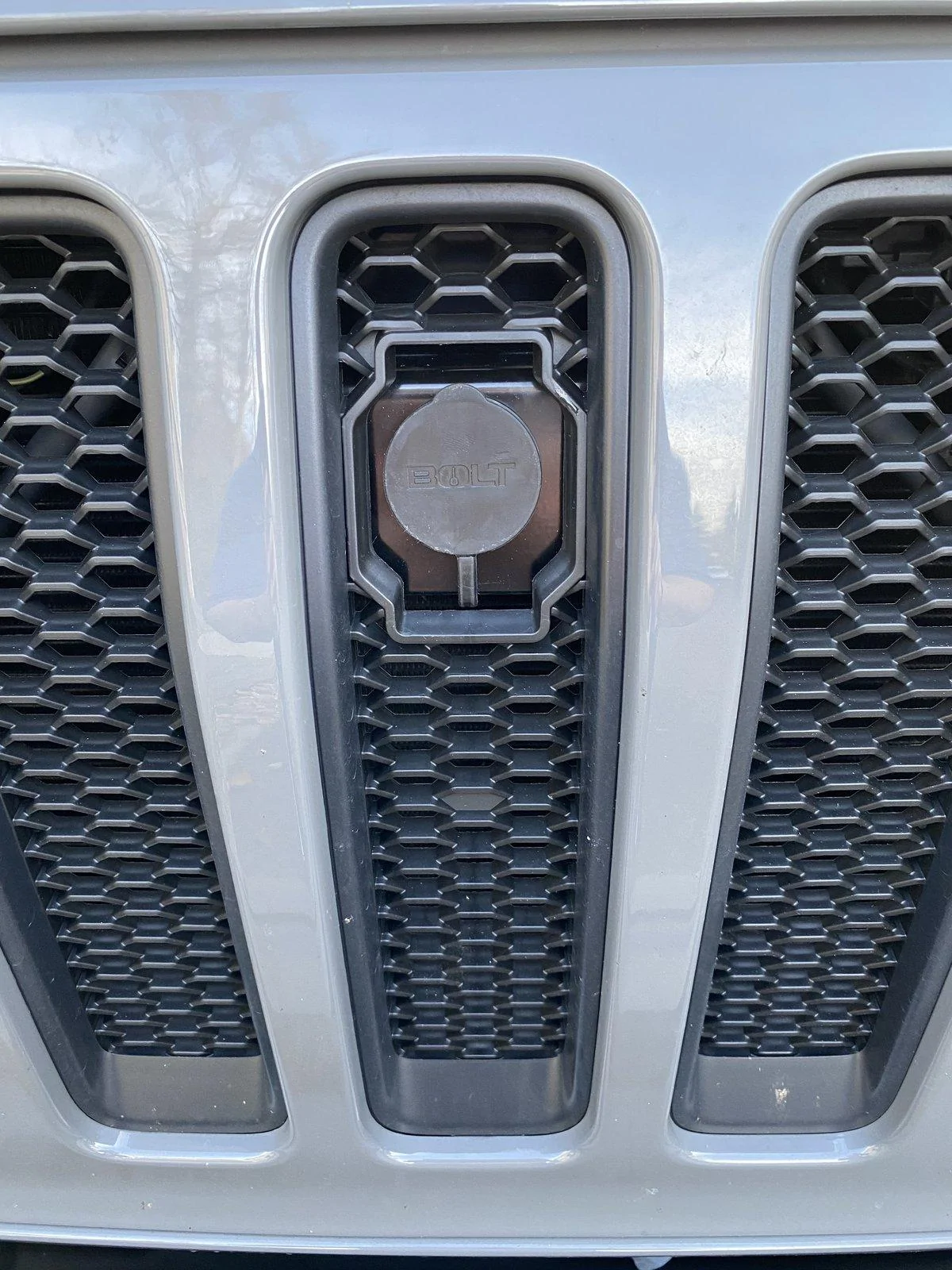

Pic of mine installed. These are really a no-brainer at half the price of the Mopar version, and with the lock learning your key on its own:

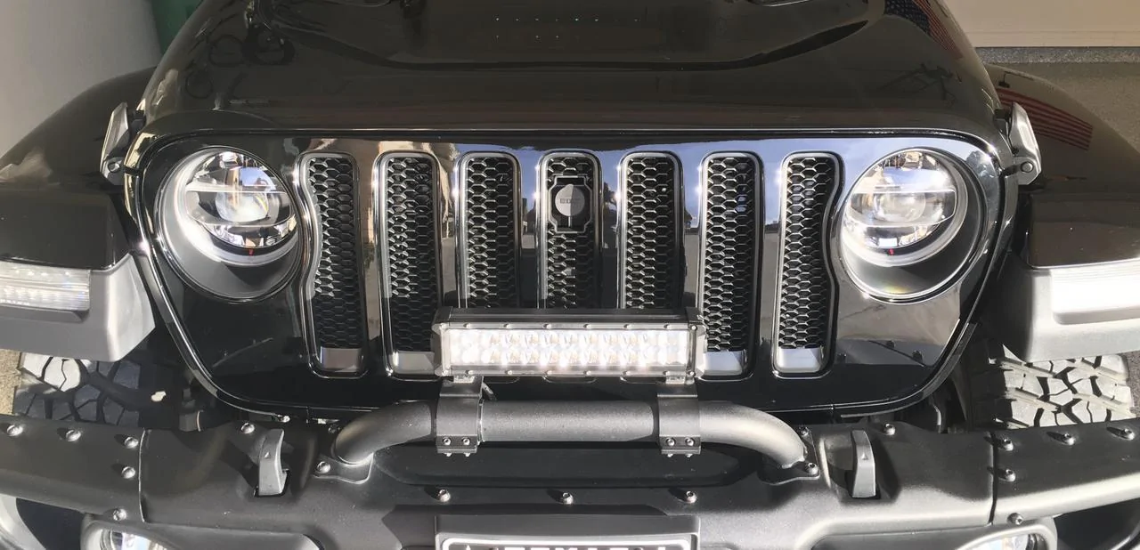

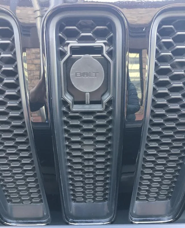

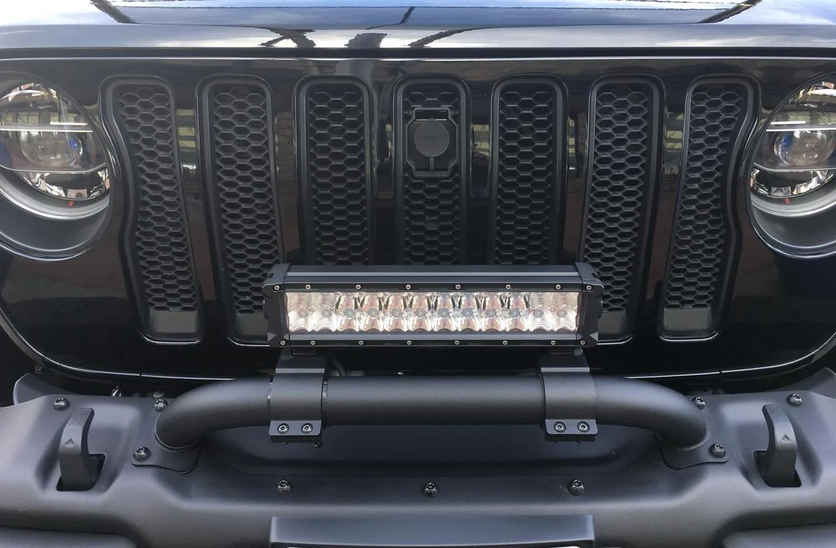

I installed mine this morning. Took about an hour start to finish including clean-up and putting everything away. Although I was getting very impatient with BOLT, I have to say that I’m glad I waited. The ability to remove the key in both the locked and unlocked position is a major plus. And, the fit and finish of the parts are top notch. BTW, I ordered mine from Northridge and with a discount code it was $111 with no tax and free shipping.

I'm skeptical the little rubber cover over the key hole is going to last very long. and once it's gone, I wonder what's going to happen when rain is forced into the cylinder at highway speeds...

I
BOLT has a lifetime warranty. The rubber cover holder slips on from the front so it’s easily replaceable. If it breaks or it gets lost, keep your proof of purchase and BOLT will replace it.
