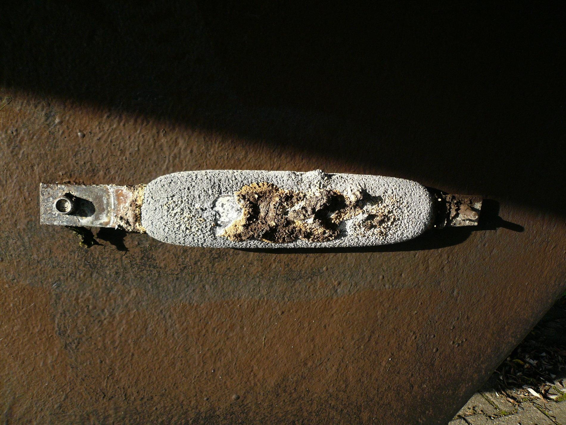

Galvanic corrosion. 2 dissimilar metals cause electron transfer from one metal to the other. OR one is giving stuff up to the other. One acts as a cathode (electron receiver) the other acts as an anode (electron loser).
Aluminum is a preferred sacrificial anode in certain applications such as submerged or buried metals.
Fix: don’t get your Jeep damp or dirty.
ADD an electrolyte and you have a battery.
Picture of sacrificial anode.
An argument (electrolytic one) could be made that: It’s supposed to do that!
