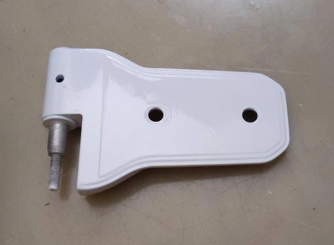

I don't believe '21s have the new hinges. I have an Oct '21 build and don't. The TSB was released in 2/23 so I'm pretty sure they cut in the new hinges around that time frame. I would say late '22 at the earliest.
Mine is a late 21 and has the barrier between the hinge and the body panels.

How did you confirm that? The new hinges have a slightly different shape.
Did you compare yours to a pic of the new style hinge or remove it to check for the zinc shim?
I looked at my jeep. it has the shim. lol.
There was an intermediate redesign of the hinge that looks like it has the shim because it has a sculpted edge, but does not have the shim. You can't tell by just looking, you have to remove the hinge to see if it has the shim.

Here's the back of a new hinge where you can see the sculpted edge around the perimeter of the hinge and the outline of the shim. You can't tell by just looking if your hinge has the shim or not.
Yeah, my '21 looks like it has a shim behind it too.
I compared it to a pic of the new hinges and I still have the old hinges. The new hinge part #'s were in the TSB dated 2/23. You have the old hinges. 🤷‍♂️
