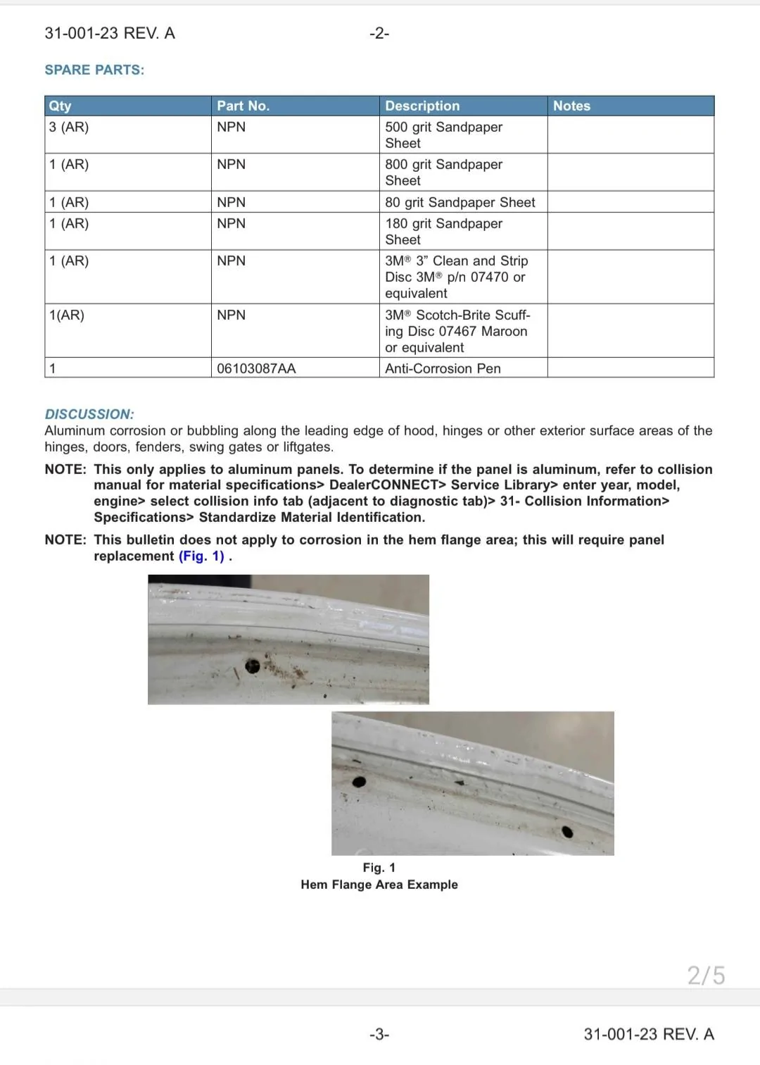

If they are just sanding and painting corrosion that has formed along the edges of the doors, hood, tailgate etc it will come back in short order. New TSB requires panel replacement not refinish. Take it back for the new corrosion and have them inspect for corrosion on the inside seems of the doors, hood, tailgate and even the windshield frame. If there is corrosion along the seams (aka the hem flange)the panel should be replaced, not refinished.

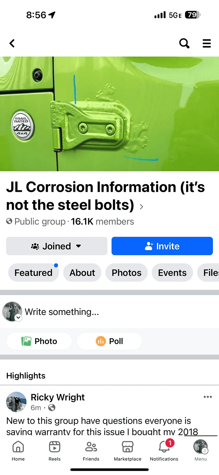

This. As mentioned above you need to join this Facebook group and deep dive into the knowledge there:
