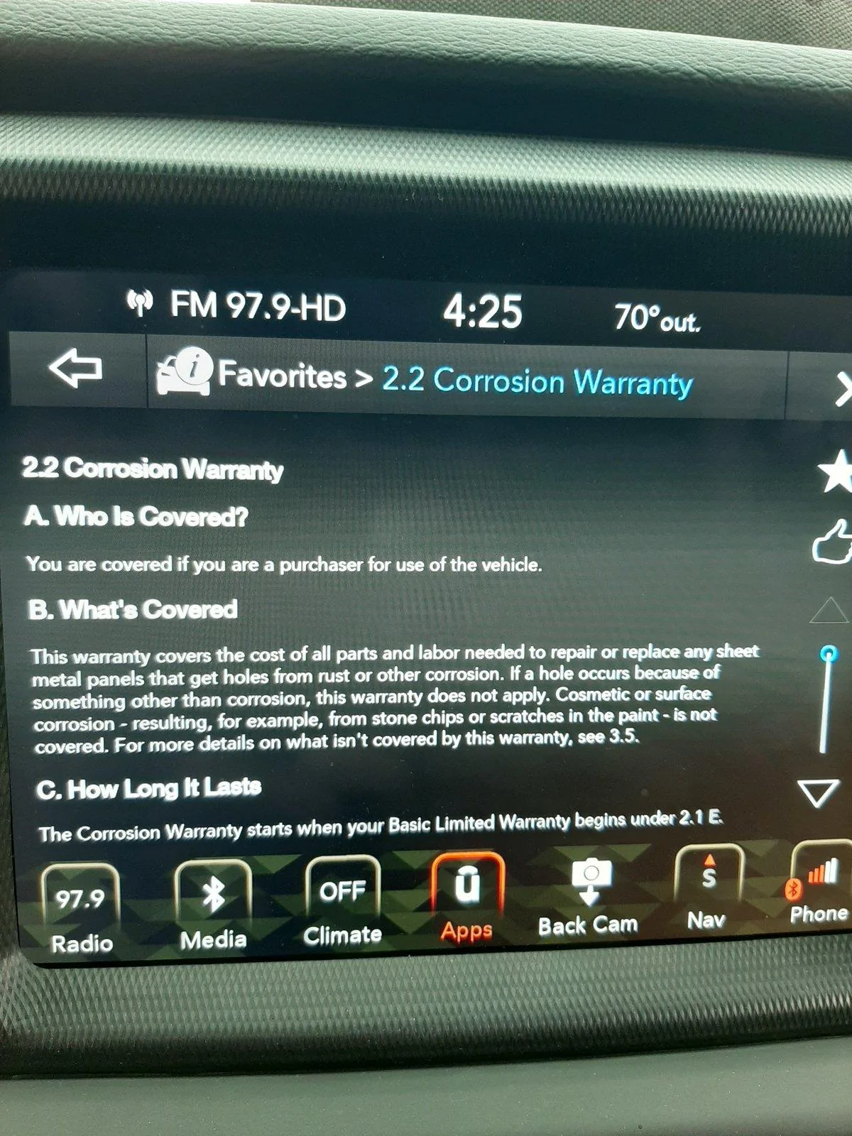

also its covered under warranty
I appreciate that it’s covered under warranty, but right now I have it on 3 of 4 doors, I’ll guarantee they won’t paint the 4th door until it “surfaces”. Plus on a $55,000 vehicle less than 2 years old I didn’t plan on beginning the process of countless lost hours running a vehicle between the dealership and body shop, since my dealer doesn’t have it’s on shop in my smaller rural area.
I bought this for my wife, who at 46 and 26 years of marriage, actually says “she loves her Jeep”, which she has NEVER said about any vehicle she’s ever had before, they were just a means to get around. So I’m seriously stuck with this thing, otherwise it would be gone!!! Sorry for venting, I think we are all finding this issue a real nuisance!
My dealership did it on all 5 doors and the hood, even though only was showing on 3 doors, just need to find the right dealership
