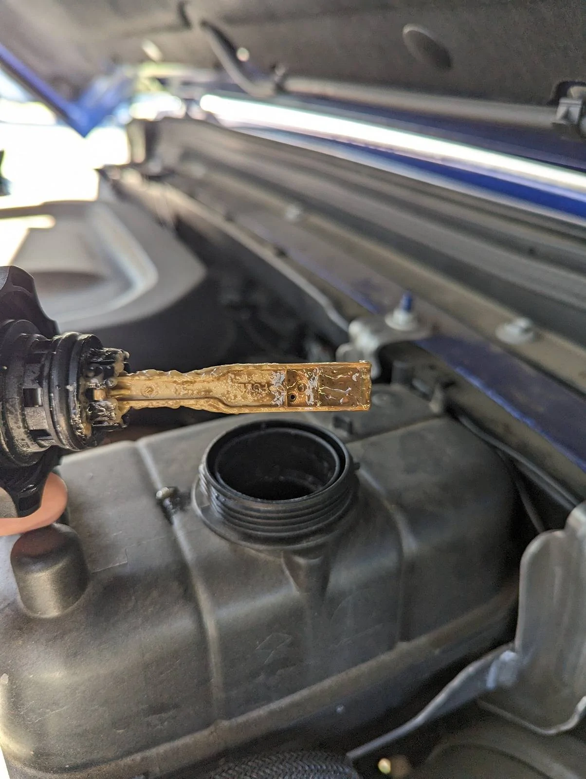

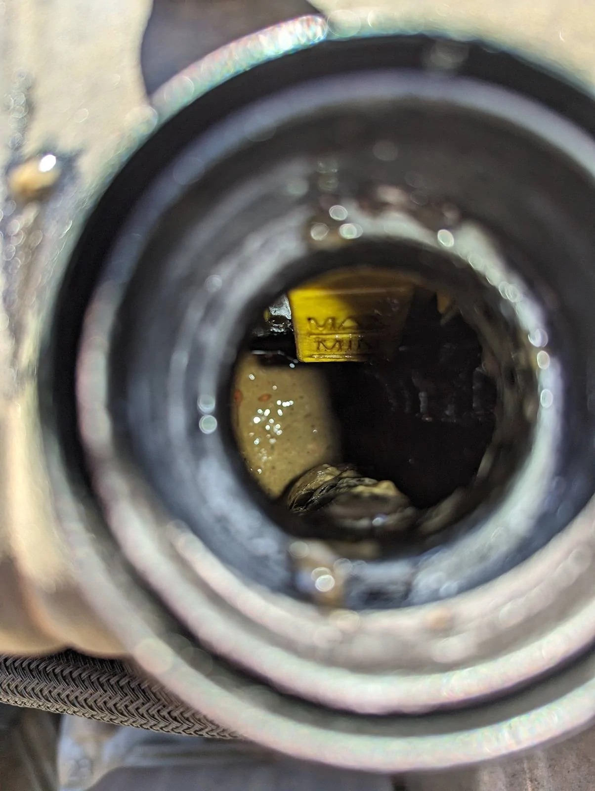

Hi,
I have a 2020 JLU Sport with the 2.0 and 60,363 (of course just over the powertrain warranty) miles on the odometer. This morning in the drop off line for school the cooling fans kicked on full blast. I had never heard them do this at idle before, only when doing long steep off road up hill segments. Of course this made me check the engine temp and it had started creeping up over the center line. I cranked on the heat full blast and this dropped the temp back down. It got around 235 at the highest. I thought maybe my coolant was low and on the way home, even when moving, if i turned the heat off it would start to overheat. I got home and let things cool off. I checked the engine coolant tank (of course it's completely opaque) and found it almost empty with a milkshake inside of it. I checked the oil cap and so far no milkshake, but when i pulled the dipstick it seems extremely over filled. Is this a blown head gasket? Any chance I could get Jeep to cover this slightly out of warranty or am I the proud owner of a future LS swap?

So this is a very long update. Of course my Jeep overheated again after I put about 50 miles on it. I called Jeep customer cares again and they advised me to take it to a different dealership. I towed my Jeep up there on a Sunday and on Monday around noon they contacted me to tell me I had a cracked oil cooler. It took about a month of back and forth with Jeep and the dealership (some of that was because of the dealership software getting ransom wared), but Jeep came through and I only ended up paying 100 dollars to get the oil cooler, thermostat, hoses, and coolant bottle replaced. I picked up the Jeep a couple days ago and there's still a bit of oil in the coolant. I let the dealership know and they stated that they could flush it 50 times and there would still be some oil. I've read that flushing with dishwasher detergent could solve this issue. Does anyone have thoughts on that?
