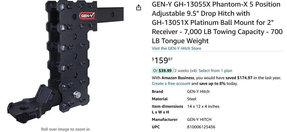

The drop hitches are the expensive part. The balls are usually relatively cheap, and often included with the drop hitch. I'd never move one, just buy a new one.
I recently got one of these Gen Y adjustable, the price was much better than the competition.
Jeep Wrangler JL HTF do i tighten this?! 1734750723358-wd
