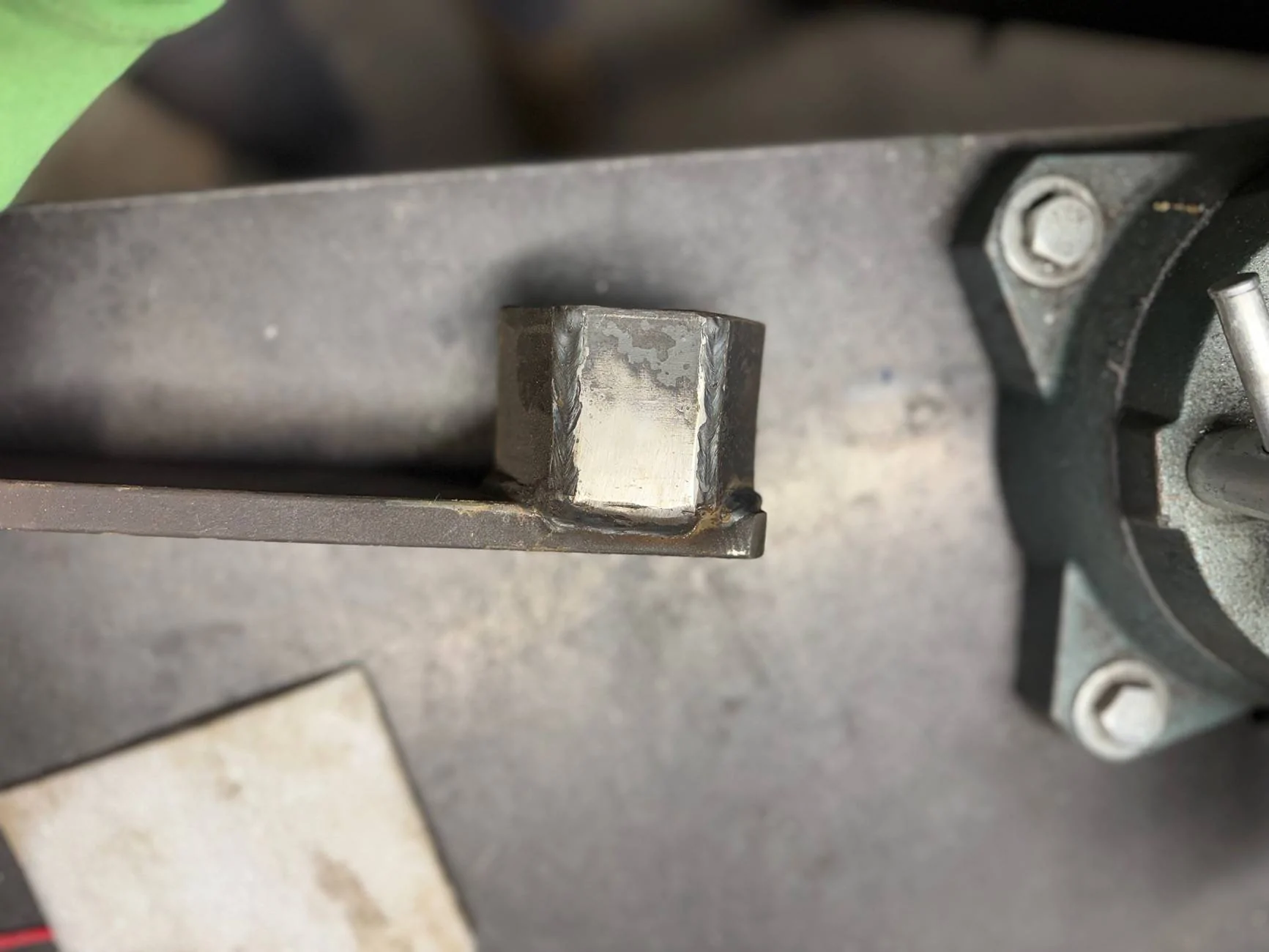

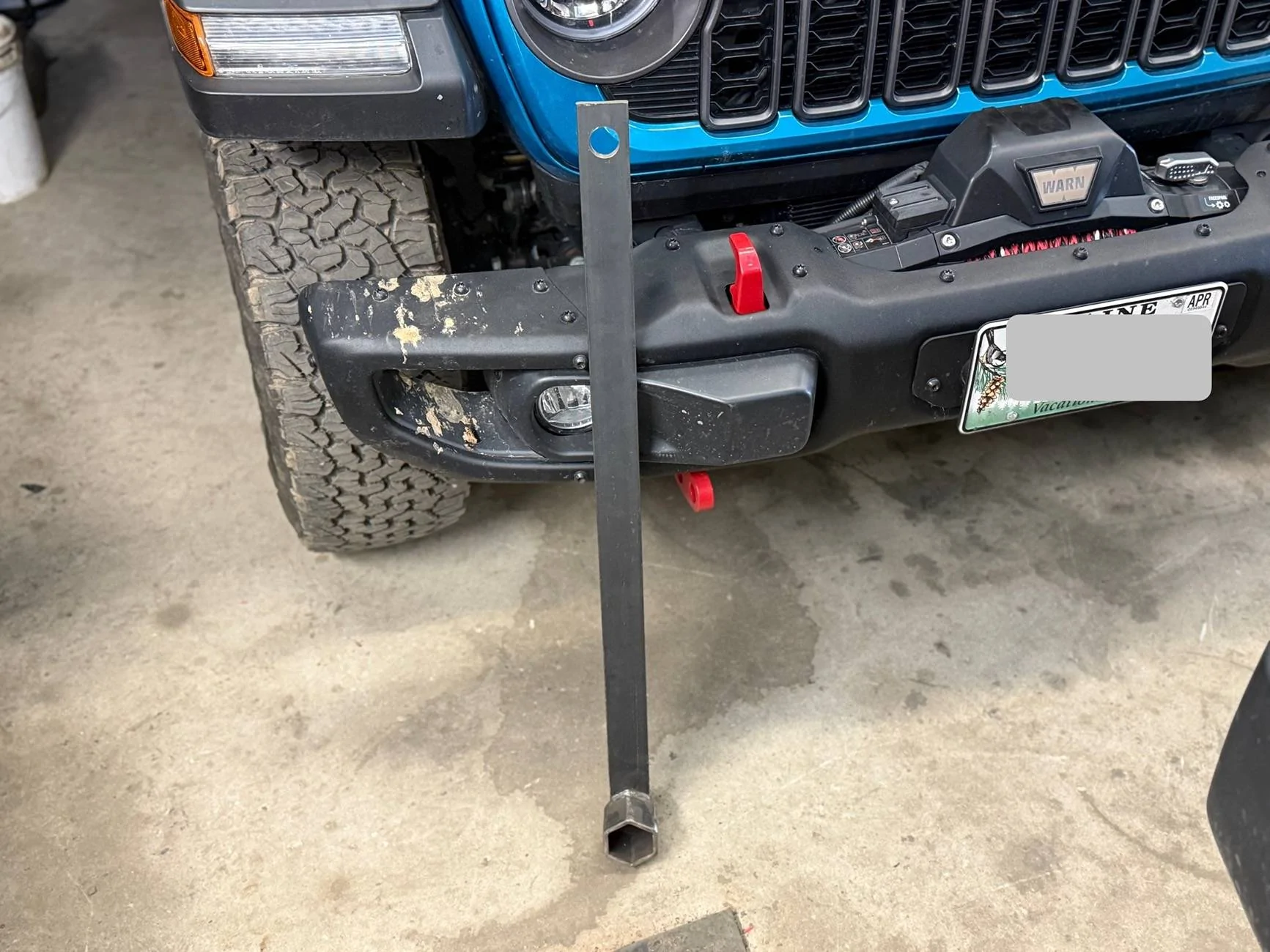

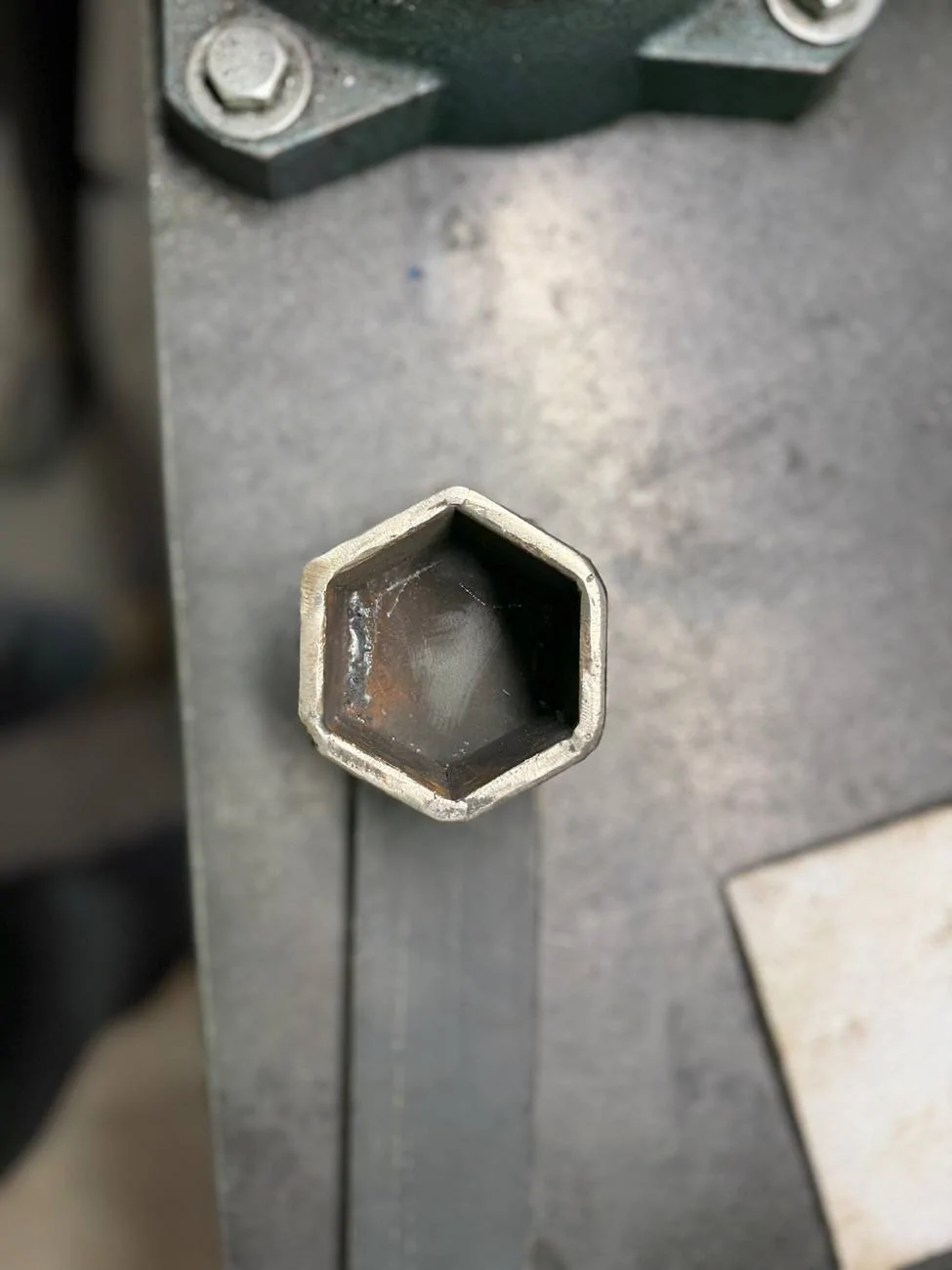

I have an 8 foot bush hog that can cut 4 inch hardwood trees. The 4 ft disk that holds the blades got bent and I had to remove it. It has a 2 1/8 in nut and nothing could budge it, so I made this wrench out of 1/4 plate. with one side of the disk chained to the hog frame I used a 5 ton come-along to pull the wrench handle. When the nut broke loose it sounded like a gunshot and I thought I snapped the shaft off. This version was the second attempt, the socket held up but the first handle bent, it took a 2 X 3/8 handle to get the job done. If the right tool isn’t available, make one.
