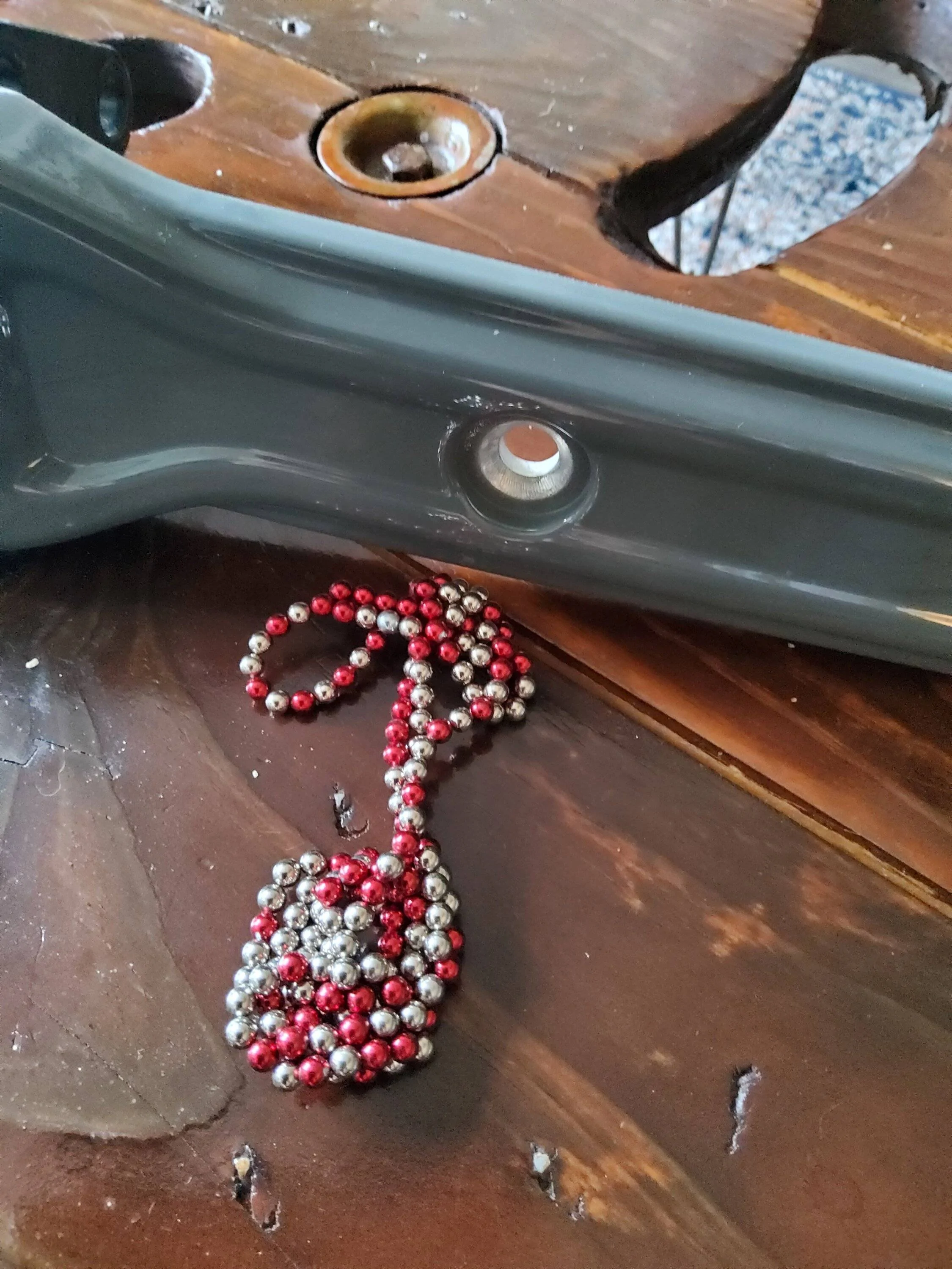

These are extremely strong magnets millimeters beside my tail hinge.
Interesting... Isn't the whole issue about the hinges being steel and the doors being aluminum, or is that totally not how things are?

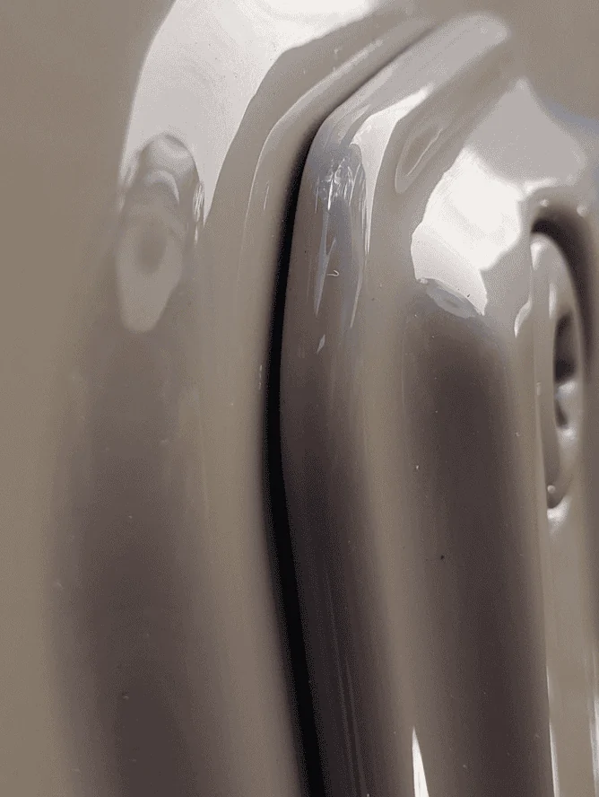

I recently (3 weeks ago) picked up a new 2022 Gobi Rubicon and the hinges have a thin gasket between them and the doors. I'm not sure if this is a new thing they started doing, but it's definitely visible.

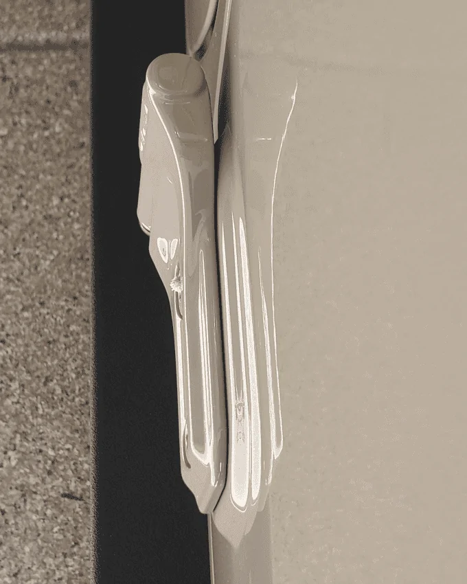

Can you take a picture of this. I want to compare it with my Willys Xtreme Recon in Gobi to see if I have the gasket your talking about.
It's a bit hard to see in the pictures, but there's a slight gap and if you look really closely in person you can see a super thin layer of foam.
I'll take a look. Hopefully it's there.
Got a magnet David? It's easy enough to check out. The hinges on my 2020 MY are non-ferrous.
Interesting, if that's the case, why even add the gasket if it's just aluminum on aluminum?!
