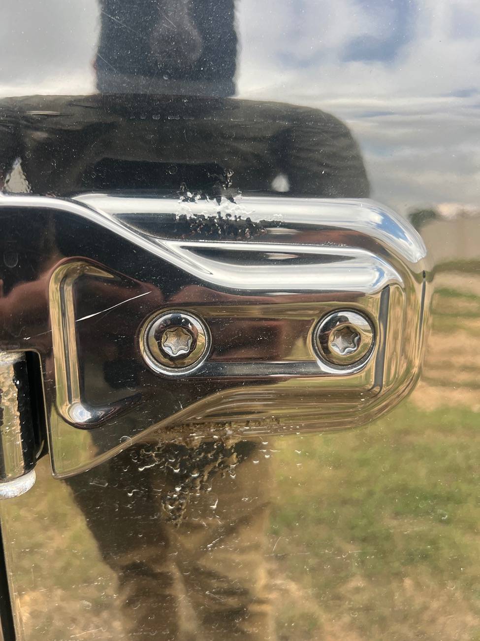

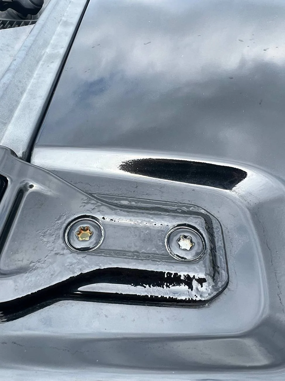

Well I’m about a week ish into owning a Jeep and I found out of the door hinge corrosion issue and sure enough I have it .. has anyone els had this and what should be the next steps to fixing it? I have seen that Jeep offers some kind of 3 or 5 year warranty ? Thanks

5 year corrision, get it to a dealership with a body shop for pictures and corporate approval immediately. Depending on the date it was put in service by the first owner you are cutting it very close.

Look at the edges and inside seams of your hood and doors, chances are you have more corrosion than just around the hinges.

No to be honest it was not the vehicle I went in to get and I rushed the process my bad I know better than to do that but I’ve talked to the company I bought the jeep from and they are going to fix it here soon

Fix it? That's an insanely expensive proposition.

The zinc shims should help a little.
Only for galvanic corrosion directly associated with the bolts. Not for the corrosion around the edges of the aluminum door or hood.

Dealers outright replace the panels now, they don't repair them anymore. One the chemeical process has started it'll always come back, so replacement is the only solution. If the panel isn't properly treated before painting then that's on them. Due to the raw chemistry involved I suspect this to be an issue throughout the entire models lifespan. It effects more models then just our JLs. The pacifica hoods are notorious for it as well.
