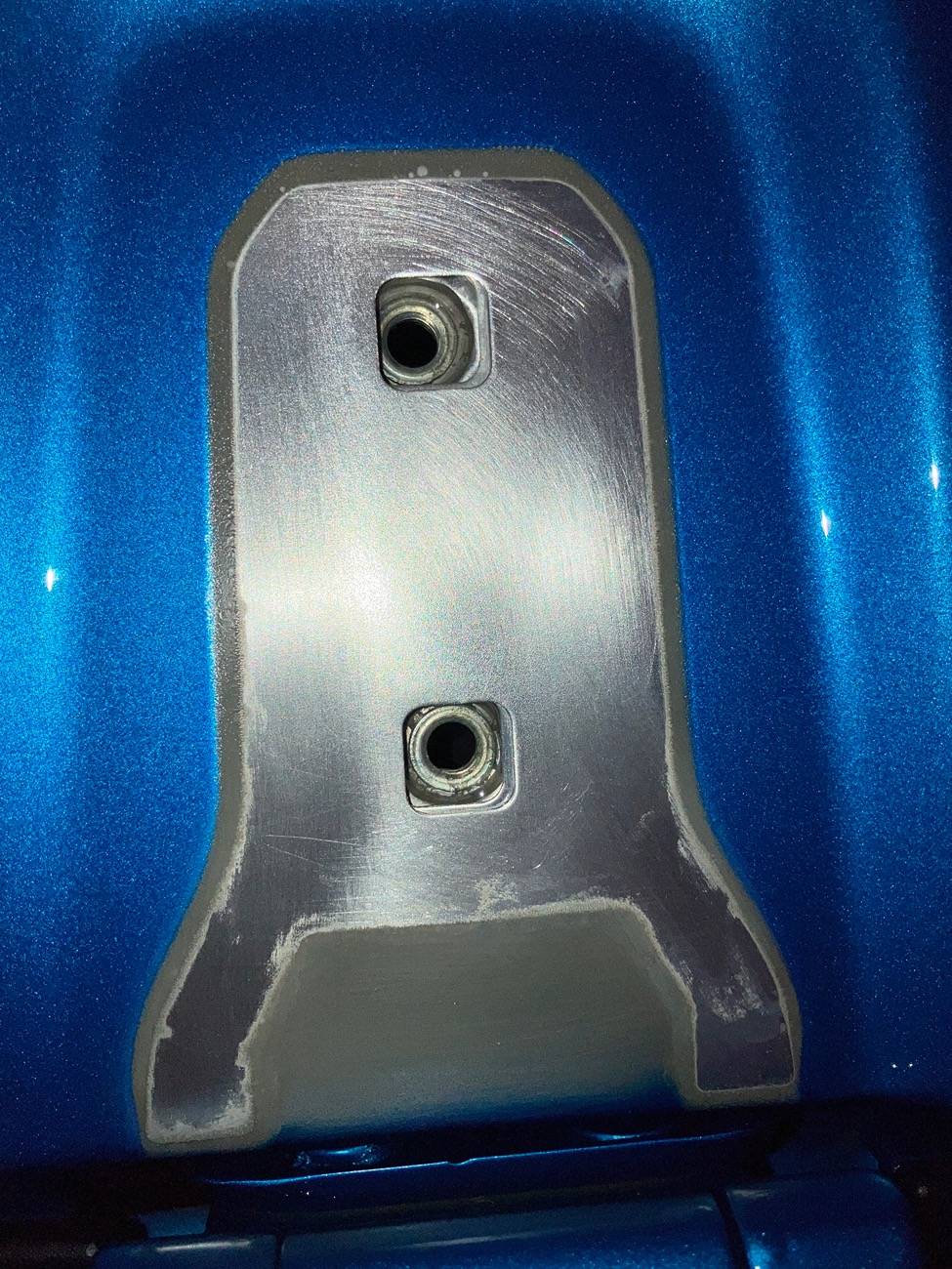

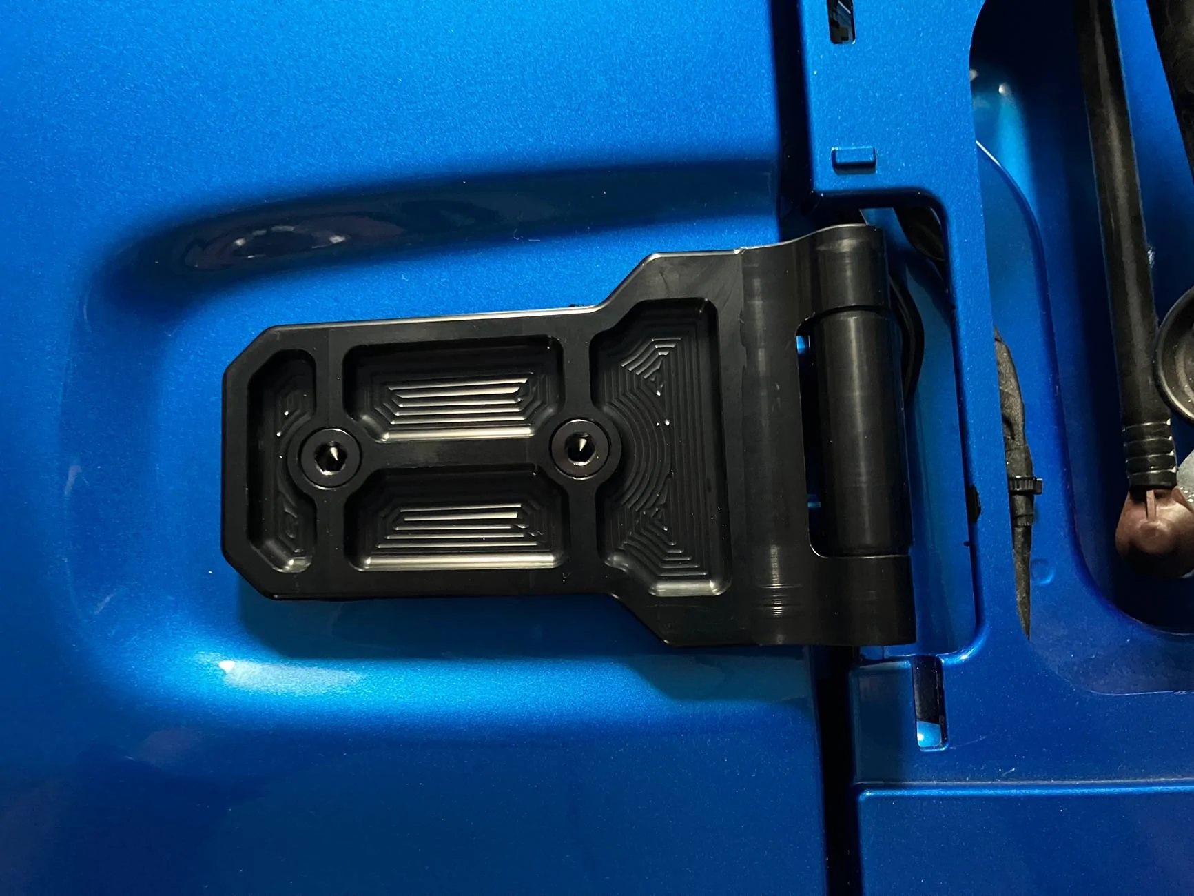

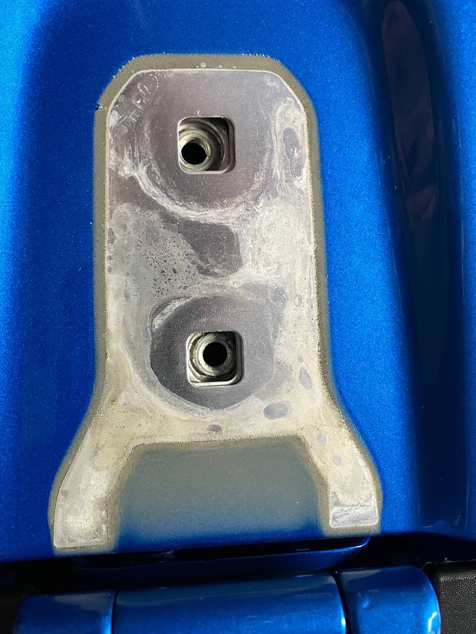

I sprayed cavity wax in all the seams on the doors, tailgate and hood to prevent the edges from corroding. I replaced all the hinges on tailgate, doors and hood. While I had the hinges off, I sanded and sealed the raw aluminum to prevent oxidation, and put a 3M silicone gasket between each hinge and the mating panel. So far so good. Just an example of what one hinge looked like. I didn’t have a picture of it epoxy sealed.. but the end result look pretty good
