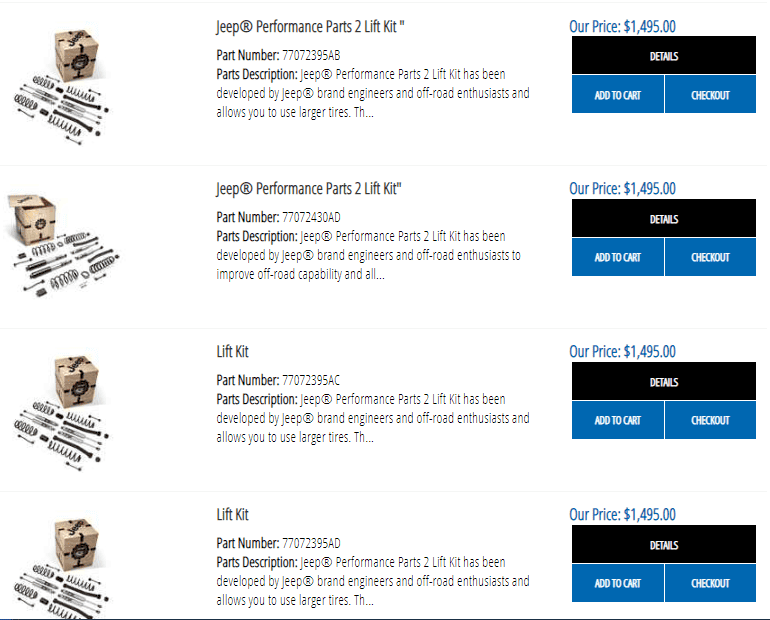

So I was speaking with the GM who I bought my Jeep from (good buddy of mine) and he was mentioning he could hook me up with 25% off parts and a good price on labor on a lift kit after I shared with him my interest in lifting my Jeep 2". I'm leaning towards a 2" Mopar lift however Mopar's official site is showing 4 different 2" lifts with diff part #s!
Jeep Wrangler JL Help! Selecting Correct Mopar Lift 1589857124951
Anyone know off-hand which one is the most current/up-to-date lift kit or best lift kit overall for a 2019 JL Unlimited 3.6? Also, are these parts sufficient or will I have to also purchase additional parts to ensure the vehicle is properly built?

The last two letters in the part number indicate the version, with the higher letter being newer (starts with AA, then AB, AC, AD etc.) Here are the part numbers in the instructions:
Those wheels should "fit", but they're going to have a huge scrub radius. You may need to adjust the steering & bump stops.
Thank you for this! I'll be sure to go with the AD model, which from speaking with @Roky, may still need some upgrades.
