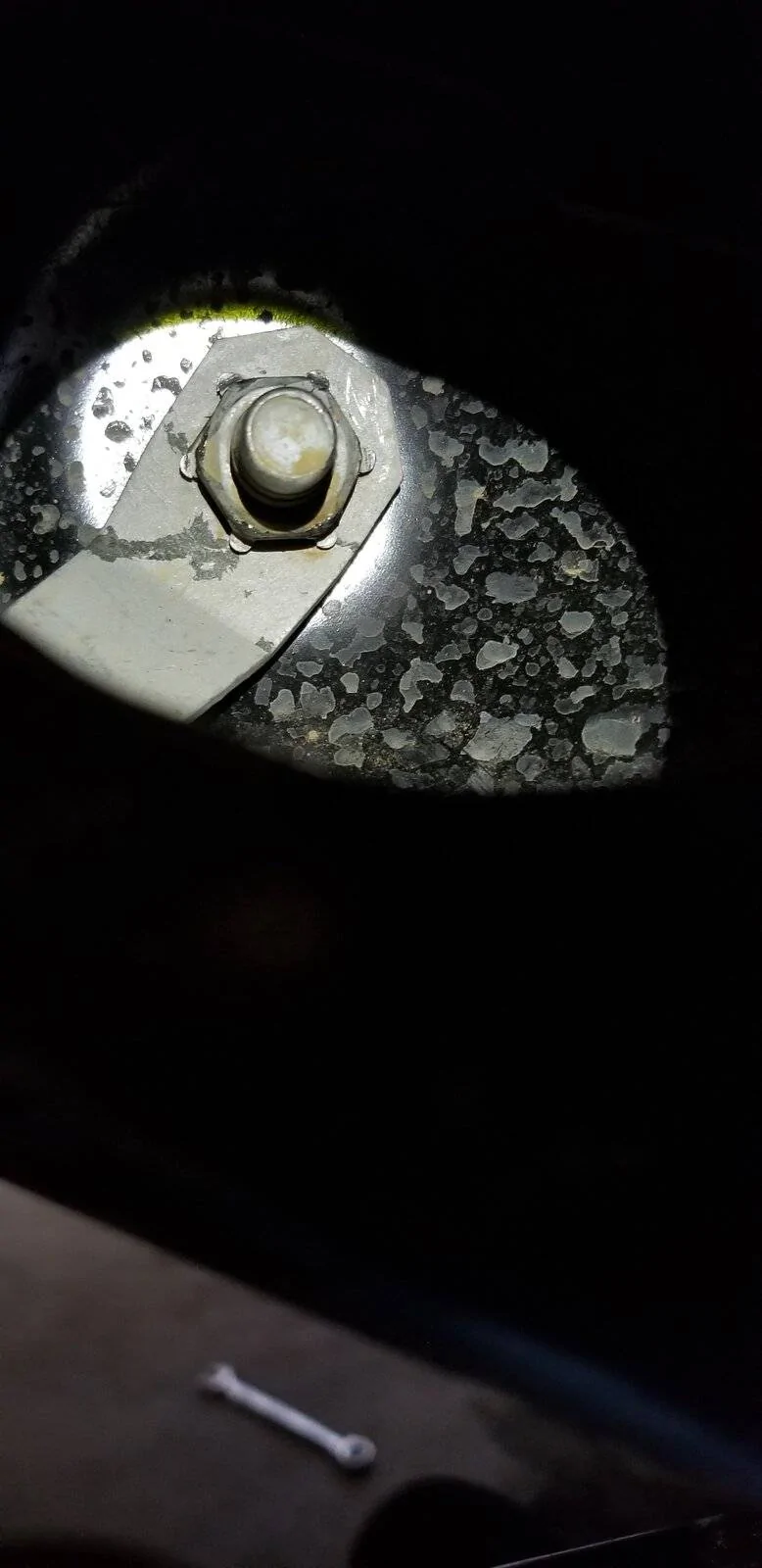

Today I'm attempting my first ever suspension lift installation. Armed with several views of various youtube install videos, I'm forging ahead with the Mopar lift for my 4xe. Unfortunately, I'm stuck at loosening the aft bolts on both front, upper control arms. The 18mm nut is just not turning, and I'm beginning to round the nut.
I've tried both a deep socket with breaker bar & an impact wrench without success. At this point I either need to abort my effort or continue with both aft UCA bolts tight. I'm figuring it will be OK left tight. Image of the offending nut.
How critical is it to loosen both sides of the UCA for this installation?

That’s a flag nut, it’s not going to move , you need to be loosening the bolt instead. Loosen from the other side..

That is a flange nut. Do not put a wrench on that. Loosen the bolt from other side
Funny. We were typing at same time lol
