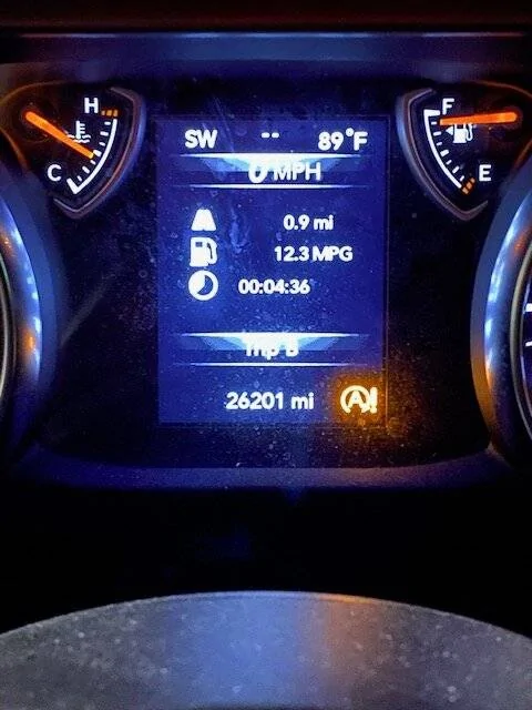

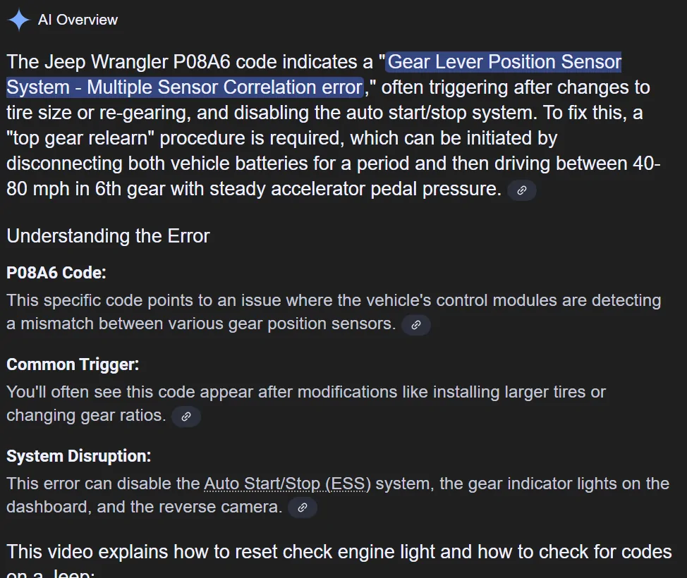

Yes, my Jeep is a 6MT. It was frustrating until I did the advanced scan and got the P08A6 code and researched a bit. I'm trying to figure out why the ECU would care about Engine Speed vs. Wheel Speed on a manual, but it does. I guess it can detect a slipping clutch (maybe???). My gear display went away and I got the auto stop/start warning on the dash.

EDIT: Google AI says this about the code.
The 6th gear relearn should fix it.
